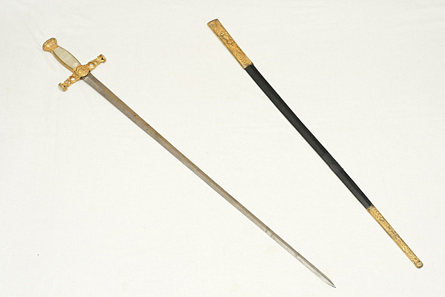

Dear friends. I have an European sword. But unfortunately I don't know the country and manufacturing time. I will be glad to hear opinion of the colleagues. Respect, Alexander.

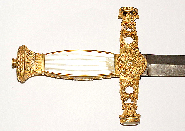

At the risk of missing the mark entirely without first consulting my meager reference library, the grip scale inserts and fleur de lis on the cross guard both have a distinctively French feel IMHO.

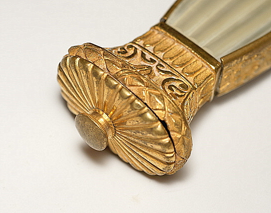

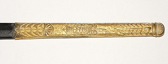

Does the capstan (rivet) unscrew from the pommel? The image of the knight on the scabbard gives the sword a fraternal feel, though the general sword pattern somewhat resembles court swords or diplomatic swords of the Victorian era.
I'm sure someone else will be able to contribute something more definitive than my best-guess efforts...
Old 11th February 2011, 01:48 AM   #3
Posts: 10,867
I completely agree with Chris' observations on this sword, there are a number of elements in the motif that suggest fraternal, perhaps even Masonic symbolic associations. However, as he well notes, the framed ivory grips and the neoclassical styling suggests French potential, and the blade seems to reflect French military blades of Napoleonic and post Napoleonic times. I am inclined toward the probable mid to latter 19th century and diplomatic or court sword suggestion as well.
It would be great if we had anyone out there better versed in French swords, I'm afraid my resources there are pretty sparse also.
The palladian style motif with semi circular shape and radiating flutes, as well as the same radiating fluting on the pommel cap, neoclassical style pommel, and columnar fluting all suggest French design. Similar designs are seen on some French swords end of the 18th century which set the pace for traditional designs in court swords through the 19th.
