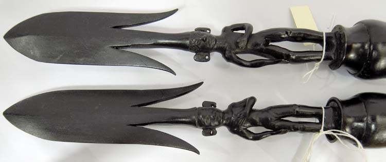

Here is a pair of interesting spears from Barlig, Eastern Bontoc (post WWII). One displays a male anthopomorphic figure and the other a female, complete with genitalia

"Male" spear, thickness of blade at the median = 7.98mm, height of the man = 112.0mm
"Female" spear, thickness of blade at the median = 7.39mm, height of the woman = 101.0mm
The anthropomorphic figures are metal and appear to have been made through casting (from moulds) or though tedious hammering/filing. Because I do not see visible signs of hammering/filing, I suspect casting, which has been practiced in Northern Luzon for ages (e.g. manufacture of brass pipes for smoking). The bended arms may have been made separately (i.e. using a separate mould) and then connected to the bodies. Either way, it appears that a lot of work was involved to create them. That effort would have been economically viable for the blacksmith if (a) the owner was wealthy enough to pay for it, or (b) the blacksmith can mass-produce the item for the tourist trade.
My research reveal that ... in the past, a wealthy male of Northern Luzon would typically have several types/designs of spears in his possession - some for hunting, defense or battle, ceremonial (i.e. warding off evil spirits), etc. Intricately made spears (or other bladed weapons such as axes) were also made to display social status.
Are these spears representative of the desciption above or are they tourist stuff? If somebody in the forum has acquired a similar item or has seen some, then that can provide clues. In my last two visits to the Luzon Cordillera this year, I have not found such items being sold in the souvenir shops or in stores selling fake antiques. That is why I find this pair of spears very interesting.
In Ifugao, this type of spear is called "Balabog", "Balbog" or "Palbog" - probably an old word for the "Falfeg". The "F", "B" and "P" are sometimes interchanged between groups of peoples in the Northern Luzon.
By the way, here is a photo of another spear with an anthropomorphic figure (siamese). This one shows signs of hammering. It is less intricate and less controversial.

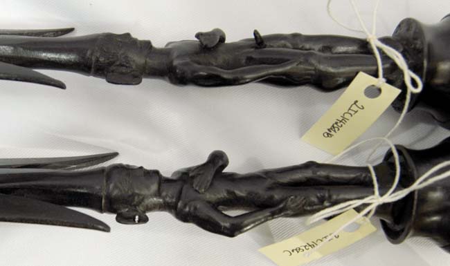

Do you know why this metal look so dark in colour? (also the hammered one with the spikes you posted looks very dark in colour).

maybe the spear points are etched traditionally, one of my bontoc spears have the same dark colour. The other one I have has had the same colour but was also very rusty so I have sanded it carefully.

The black colouration on the pair of spears (with male and female anthropomorphic figures) could be the result of staining. On the other hand, the dark colouration on the spear with multiple barbs could be the result of old rust and application of used motor oil (which is a common practice among the locals) in the past.
Maurice, your idea of making the metal darker as a result of the forging process (or type of raw material) is a real possibility in my opinion. My guess is that this would likely occur post WWII.

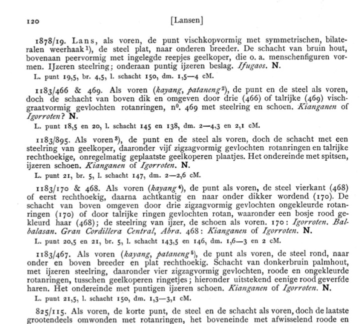

nonoy, juynboll's 1920s catalogue has such a spear. in the description the only word i can recognize is "ifugao". maybe our dear dutch friends can help us out with the translation
Old 30th January 2011, 09:11 AM   #22
Maurice
Maurice's Avatar
Join Date: Jan 2007
Posts: 1,464
Default translation Juynboll
OK, not that spectacular, but here it is:
1878/21. The lancehead in the shape of the head of a fish, with bilateral barbs, the round shaft modifying in a standing human figure.
Wooden shaft from grey wood, the top thickened pear-shaped, inlaid with yellow copper strips, which forms humanfigures and a chain of triangles.
Iron ferrule, with crenated upperside, the lowerside with pointy, iron fittings.
Ifugaos. N.
Length head: 30,5, Width: 4,5, Length wooden shaft: 163, Diameter: 1,5-2,5 cm.
See plate X, fig. 3.
