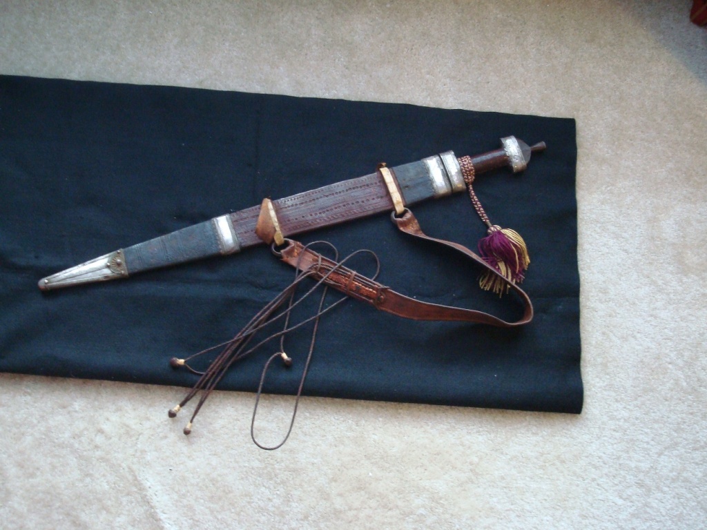

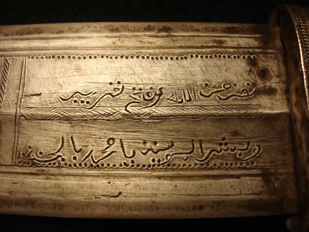

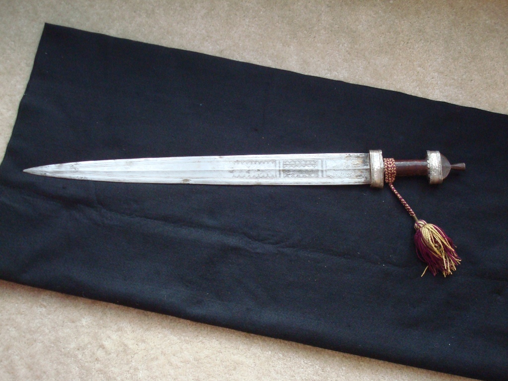

From my private collection is an interesting sword that seems to show multiple cultural influences so its exact origin is a bit of a mystery to me so I figure this is a good place to start a discussion. The silver work in the entire piece remind me very much of Arab work. All the leather remind me very much of Sudanese work. The blade, however, seems more tribal African to me as far as the decorations and workmanship of the blade. It is a very good blade, but not of the quality of locally produced Arab or African pieces. There is an Islamic inscription on each side of the blade that hopefully can be translated and add to the story. It is very well preserved but given the oral provenance received on the piece I would place it in the late 19th century. When I first saw it, I thought it might be an Omani one-of but there are enough peculiarities to it, I'm not so sure but I definitely see the Arab influence in the silver work. In any case, I have not run across a similar example before and look forward to your thoughts on origin.

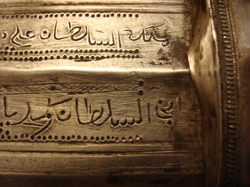

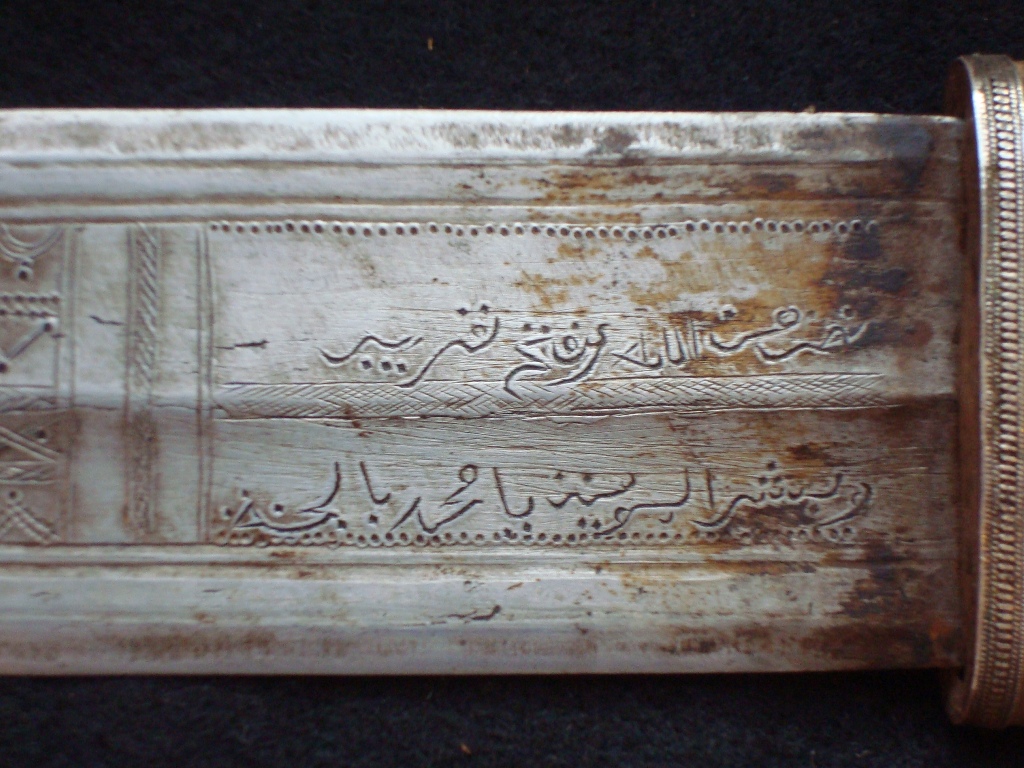

Some additional pictures including the inscription to blade.

Iain
Iain's Avatar
Join Date: Mar 2010
Location: Olomouc
Posts: 1,720
I'm struck by the resemblance with Tebu short swords. The scabbard suspension is clearly Chadic/Sudanese.
Is the hilt iron with one piece construction between guard and pommel? Something of the design resembles Mandingo pommels.
The decorative style of the blad conforms to various Chadic groups, similar line designs around the edges can be seen on Chadic daggers. I like the profile of the blade, better geometry than I was expecting.
Hopefully someone can get something out of the inscription. I have seen references to short swords in Nigeria and the Bornu region but never really seen one to compare this with.
A lovely piece, I'm officially intrigued.

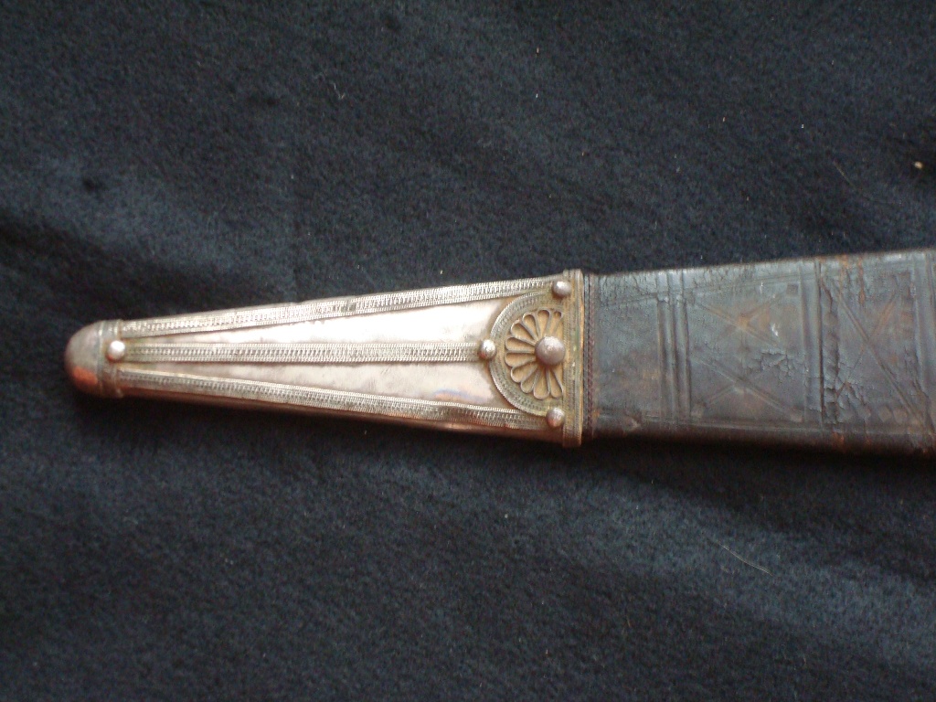

Hi Iain,
Thank you for the feedback. I had thought about Tebu daggers when looking at the protrusion at the top of the handle. This is the only exposed metal part, it is steel, nicely worked. The grip is leather wrapped and then you have nice quality silver mounts at the top and bottom of the grip. It is the silverwork that is throwing off a full Chadic attribution as I don't recall seeing any examples from those regions with this quality of silver work. Like you say, hopefully the blade inscription will provide some details. I'm also hoping some of the other African collectors will provide some opinions.

most beautiful.
the first picture inscription is a verse from the Quran commonly used on swords, it says "victory from God is near, so bring the good tidings of heaven to the believers, O Mohammed"

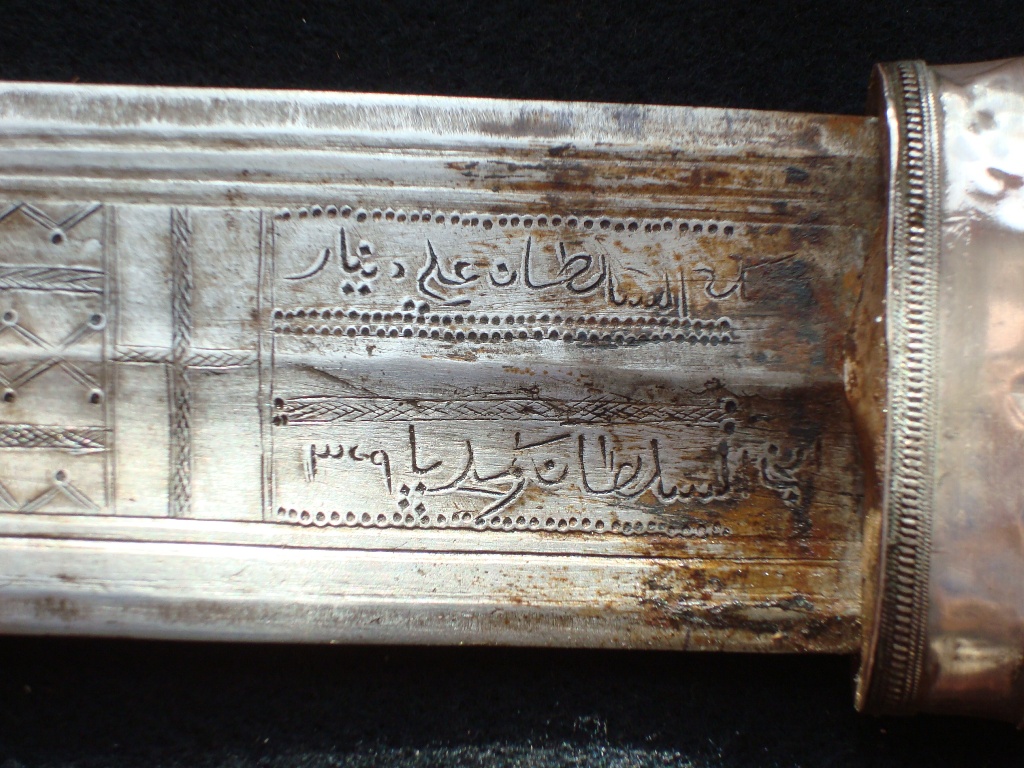

the last picture inscription says ".... alsultan Ali Dinar" first word is unreadable atm.
the bottom inscription says " .... alsultan .... 3 . 9" the dots are words/numbers i couldnt read.

Posts: 1,720
Well that might break it open... If someone can read the date I'd bet this could be a reference to Sultan Ali Dinar of Darfur (1856-1916).

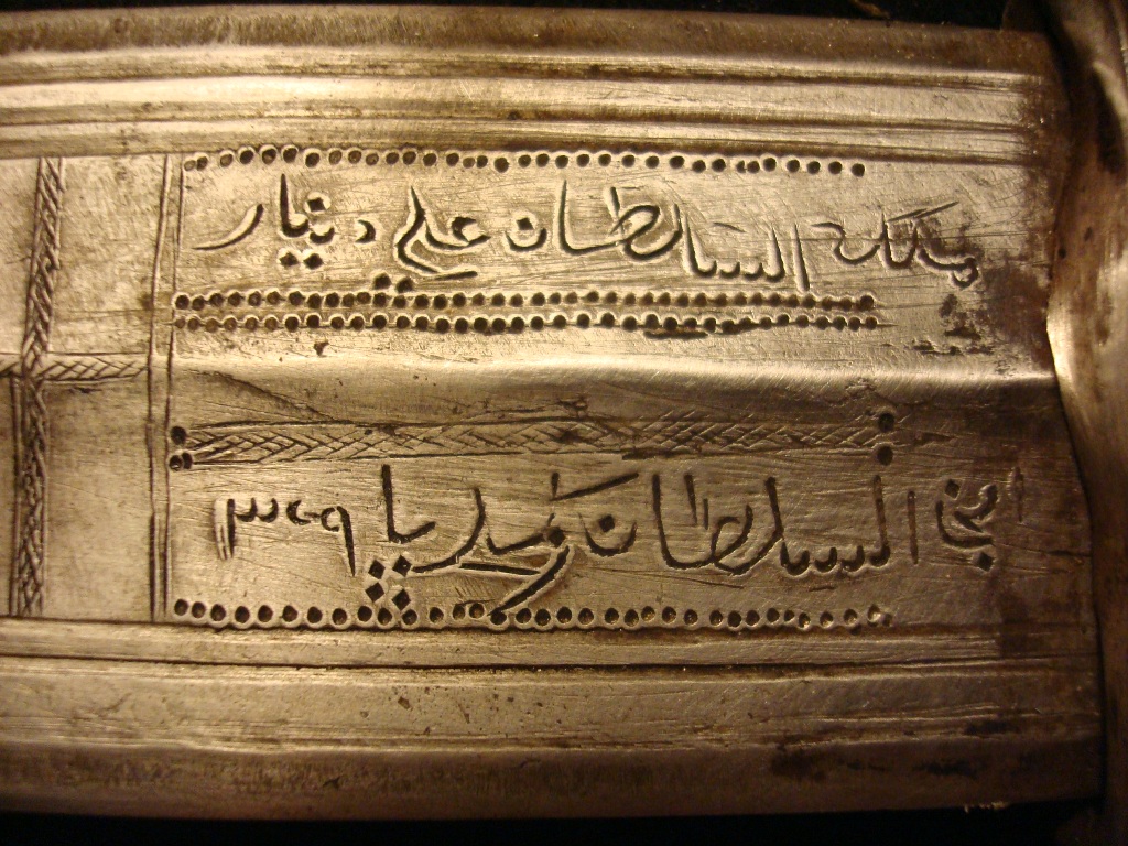

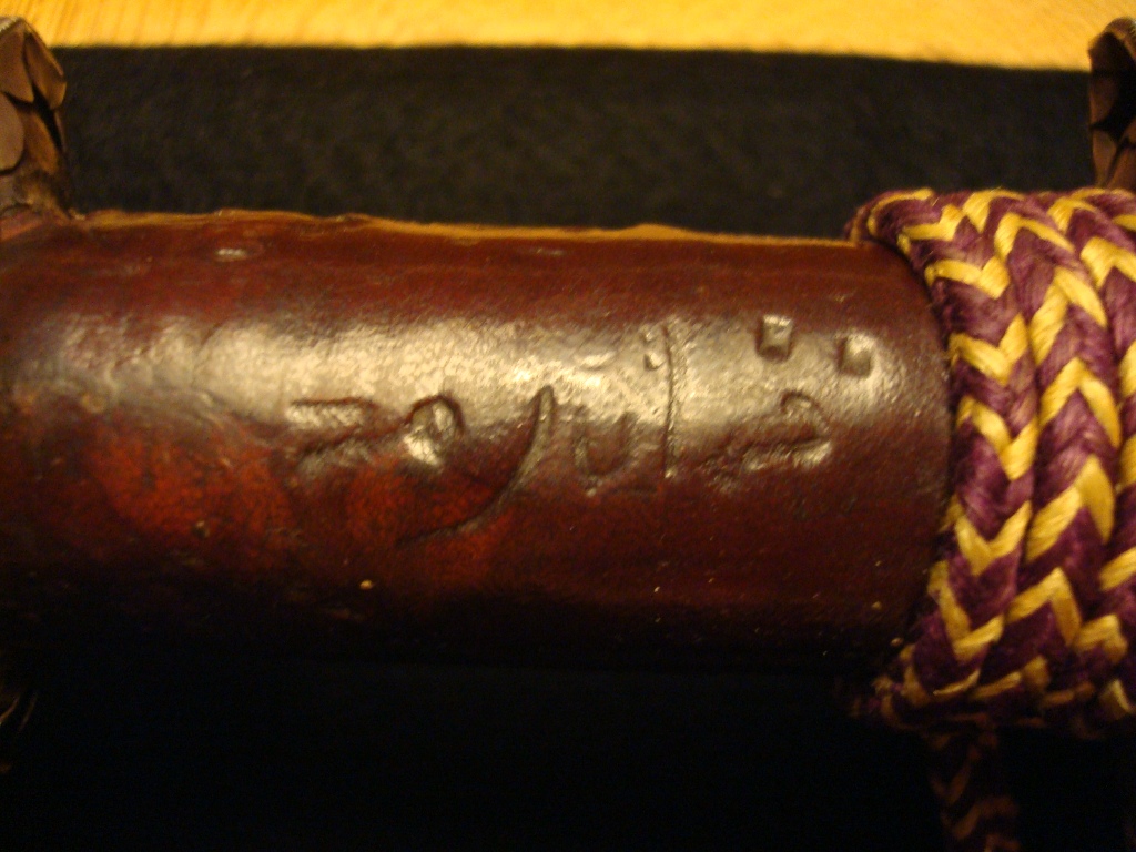

A. Alnakkas, thank you for the translation assistance. This provides a very interesting potential insight into this sword. Iain, I agree, if the date will correspond, this very well could be a sword or something gifted, to Sultan Ali Dinar of Darfur. This would definitely tie together the influences I am seeing in this sword. Sounds like I need to clean up the blade a bit around the inscription so it is fully legible. Will work on that over the next couple of days. I have also noticed an inscription on the leather on the handle. While more difficult to photograph I need to add it to the discussion as well.

I cleaned up the inscription area so that it is hopefully more legible now. I also got the best picture of an inscription on the leather on the handle.
I am surprised I haven't had more thoughts/comments about this piece. I would appreciate any thoughts about the cross cultural influences found in this piece. Also, the inscription has some interesting potential with the Sultan Ali Dinar reference.

hello!
the inscription says (top one first) "mulk alsultan Ali Dinar" it means: owned by the Sultan Ali Dinar. the bottom one says "ibn alsultan Zaid?" it means: son of the Sultan Zaid. but am not sure of the last word is Zaid or not.

Posts: 1,099
Hello Abdullatif. Could the second inscription be "ibn alSultan Zakariya". According to some online research, the father of Sultan Ali Dinar was Zakariya. Now, the question begs is whether or not this is actually a sword owned by Sultan Ali Dinar or not? Is anyone familiar enough with him to know of his familial backgrounds? I am still curious on the cross cultural influences I am seeing in this piece. I guess with the inscription this would place the piece circa 1898-1916? Jim? Stephen? I know you guys have done a lot of research in this region. Any thoughts?
thats correct! it is Zakariya, explains alot

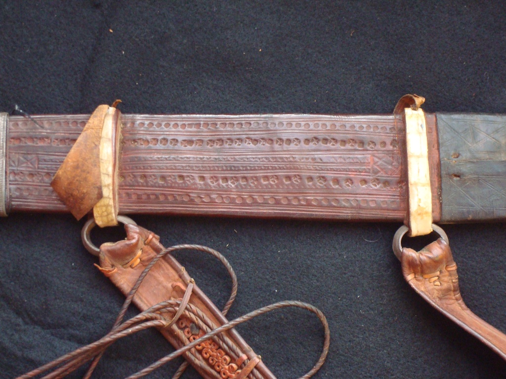

Posts: 1,720
Hi, which hanging pieces are you referring to? The leather strings on the scabbard?

Posts: 1,099
Yes, those leather strings with the ball finials that are attached to the shoulder harness are what I am referring to. I agree it is an unusual and rare example as I also have not run across a similar example. I am surprised nobody has joined our discussion as usually mysterious or unusual pieces spark some theories. Please, does anyone have any comments on this one?

Posts: 1,720
While I haven't seen the ball finials before (thanks for pointing them out!) leather cords on kaskaras I've seen before integrated into the shoulder strap (I actually just sold one a week or so ago on the swap forum). Not sure of the reason for them of if they denote a region?
I'm also a bit surprised there's not more interest here. Folks we have a sword with a very good potential to have been owned by an important historical figure, that's about as good as it gets. So heck I'll throw a theory out there. There's something here that strikes me as resembling a kinjal. Ali Dinar was allied with the Ottomans and nominally under their rule. Perhaps the sword was made in a supposed Turkish style because of this?
