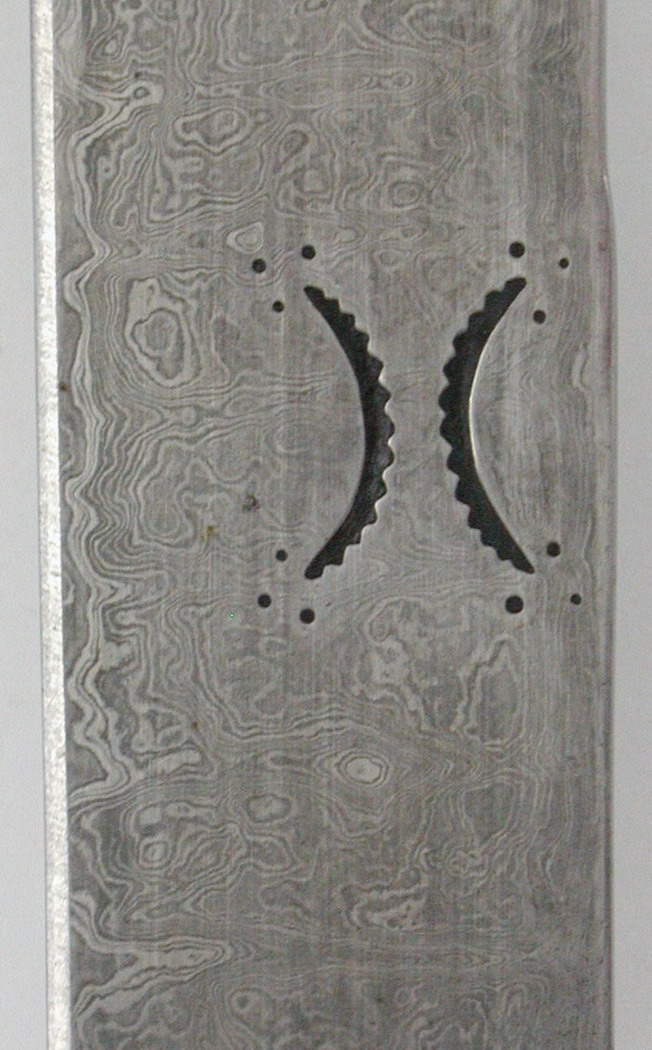

It seems as if the blade is rather heavy, is it? The blade looks very broad, but is it also thick? Do you have a better picture of the ‘anvil’, and where on the blade is the ‘anvil’? The ‘snakes’ and the ‘suns’ can frequently be seen on Indian blades, and it most likely copied from European blades. Copied is also the Solingen wolf and several other European sword marks, like the one shown on the picture.

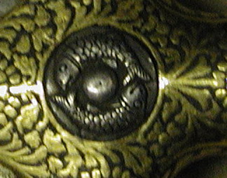

Well, you see, I think what T.Donoho on SFI means is the point you can see at the square of the hilt. To my opinion this is where former a wheel was attached – like this one shown, although it might not have been fishes – more likely a wheel.
