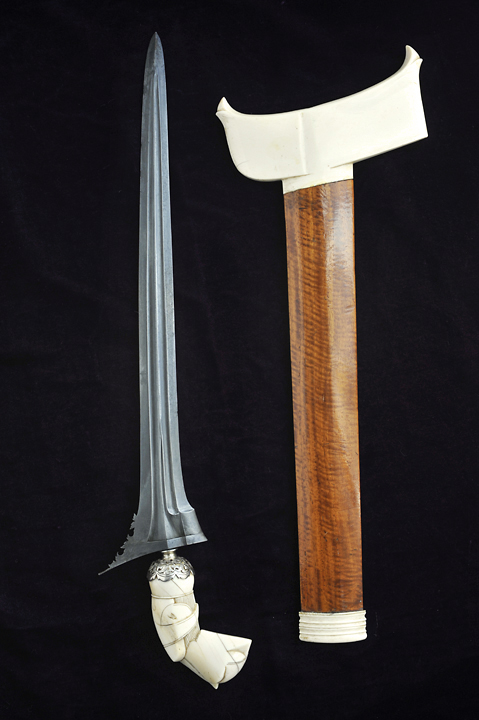

Default Shadow Keris
OK, just for fun because things seem a bit slow around here, a bi-product of my Halloween lighting for my party. I walked out of my study into the hallway and thought, oh look, that's kind of interesting. So i pulled out the camera for a shot. Most of my friends wouldn't recognize this shadow, but i would imagine that would be different here...
Too bad i don't know enough to write a book on the subject. This might make a nice cover.

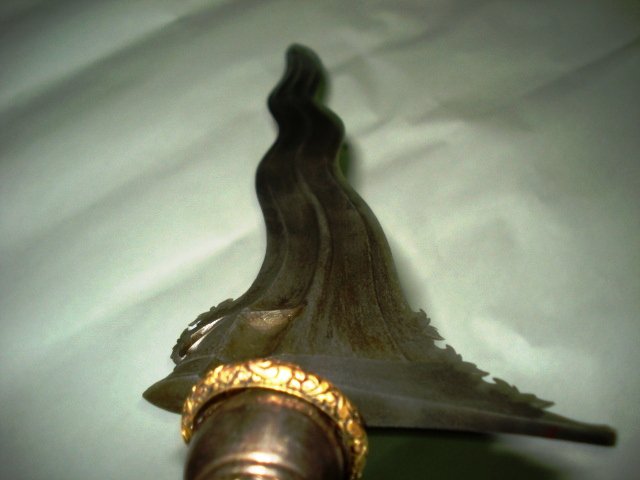

Well i'm sure that some of you might be wondering just what it is that creates such a beautiful shadow...
....and Kai Wee, i'd say if anyone here has access to beautiful Malay keris worthy of a nice "pin-up" coffee table book it's you...I'll have my agent call your agent and well do lunch...

Location: Singapore
Posts: 1,248
Beautiful fittings.. looks like a piece from Kedah. If you don't mind David, can we see the blade..
Old 9th November 2010, 12:45 PM   #9
Posts: 7,297

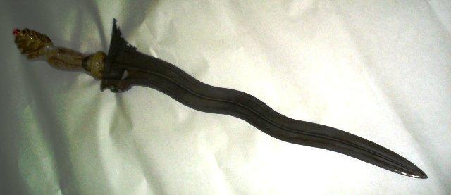

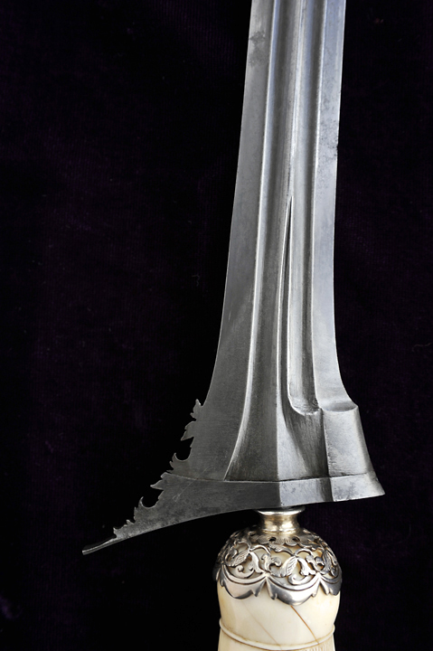

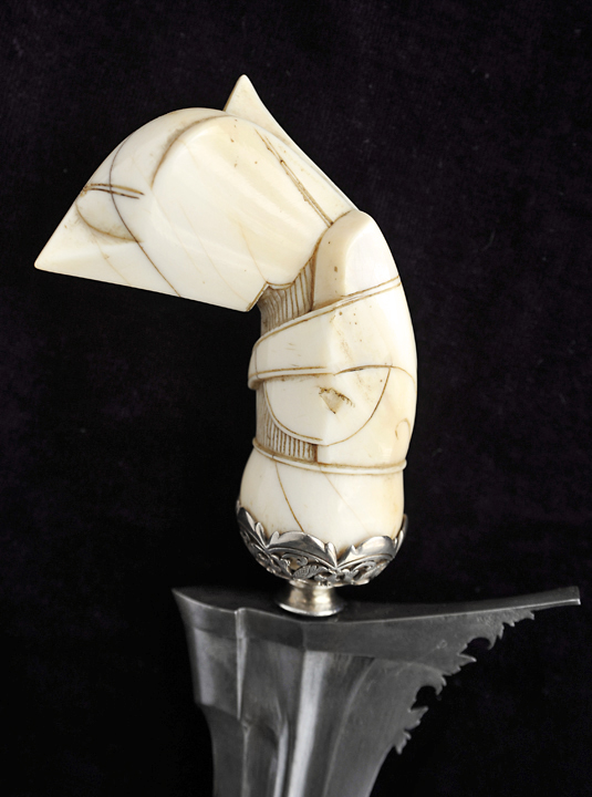

Well, i sure got myself into a bind this time, didn't i.
As i am sure some of you know it is not generally my practice to show my blades on the internet for numerous reasons, some practical, some personal. But it is also not my intention to be a tease either, so since i have raised the interest level of my own accord i suppose it wouldn't be fair of me not to give you all a bit of a viewing, especially given the relevance of this blade to Kai Wee's concurrent Carita thread.
Old 9th November 2010, 01:40 PM   #10
BluErf
BluErf's Avatar
Location: Singapore
Posts: 1,180
Killer beauty! the lines are so sharp that looking at it can cut...
Old 9th November 2010, 02:28 PM   #11
Alam Shah
Alam Shah's Avatar
Join Date: Jan 2005
Location: Singapore
Posts: 1,248
Aweee.. David *drooling*, what a beauty.. very nice well-constructed piece indeed.. There's some age to it but imho, haven't reach antique status yet..
