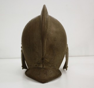

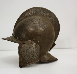

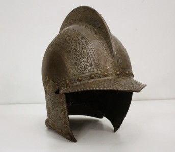

Hi
This is an item I bought on eBay. Bidding on it was certainly intense and in the end I think I won it with my last dollar. It's just arrived in the post. And it looks very good to me.
But I don't know what it is. The etching on it is magnificent. My view is it is French and one of the many portraits looks to me to be Henry IV, the first of the Bourbons.
But I could be wrong, of course.
This should be an easy ID if you have the right references - there are portrait engravings for a start.
I'd appreciate any help I can get on this.

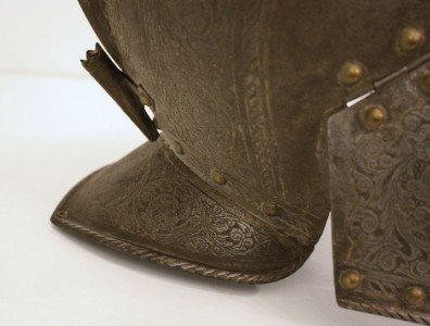

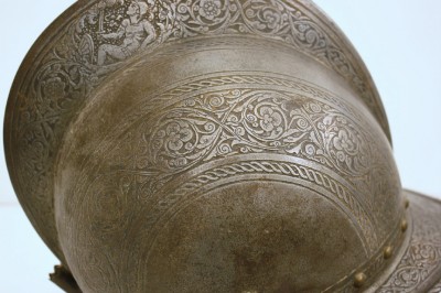

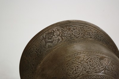

Hi Ron,
I assume assigning this morion to France is probably correct; the other likely choice would of course be Italy as the style of the etching is clearly based on Italian Renaissance patterns.
The bearded male portrait medallion in the second to last image obviously goes back to the later Landsknecht fashion of ca. 1540-50, as known from engravings by e.g. Jost Amman and Virgil Solis.
Michael
Old 4th November 2010, 12:30 AM   #5
Ron Anderson
Join Date: Aug 2010
Location: Sydney Australia
Posts: 228
Hi Michael
Thanks for that. I agree with your assessment of the style. The portraits do have that look.
Italian is an option. Having said that, it does not to me look like what is generally described as the pisan style. And I have seen French helmets that appear to closer to this form.
But I could be wrong. I haven't looked at enough of this sort of engraving to have a reliable opinion.
I took a good look at the helmet and it has genuine age. There are remnants of leather at the base of the skull. These are so old they have virtually turned to charcoal. There is pitting on the inside, which may or made be concealing an armourer's mark, which I haven't yet found.
Not a Victorian copy, of that I'm sure. But I'm not if this 17th century or earlier.
Ron Anderson is offline   Reply With Quote

Old 4th November 2010, 05:20 PM   #7
Matchlock
Matchlock's Avatar
Join Date: Sep 2008
Posts: 4,310
Hi Ron,
I called it a morion because this is the apt German word and, in the last years, also seems have been preferred by English sales houses, whereas burgonet is more confined to what we call a Sturmhaube.
Sorry, I forgot to add that it should be closely dated aroud 1580, in spite of the fact that the patterns of the etching are of course older.
Michael
