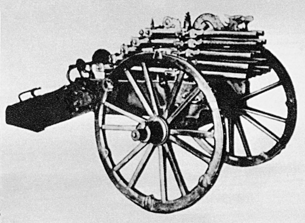

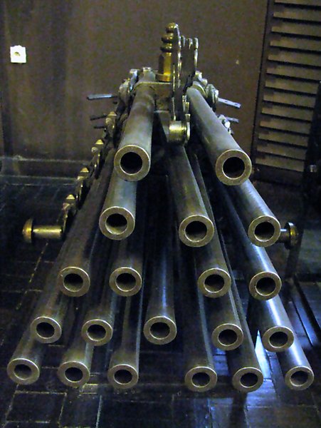

Unfortunately all I could manage to get is this little. I could not even find out in what Polish museum the item is preserved. Looks quite impressive from a psychological as well as a practical point of view anyway. The barrels are mounted immovably and would all fire simultaneously. Must have produced a tremendous impact ...
The bunch of barrels probably re-used from earlier German short arquebuses, length ca. 60 cm, the carriage and mounts late Baroque period, ca. 1700 or first half 18th c.
Any comment much welcome.

A very impressive weapon Michael!!!
I would imagine an instant volley from this could startle a charging mass of troops and impede thier advance in theory for a moment. After firing, I wonder how long it would have taken to reload this.
In noticing the barrels, they all seem of the same bore..I have read that the later type guns with standard bore were termed 'calivers' (i.e. caliber), what was the difference between that type gun and the short arquebus noted?
I have noticed the many interesting multiple barrel guns you have posted over time, and though intrigued by them, could not really formulate reasonable questions, but this is a start
