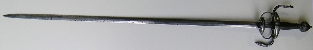

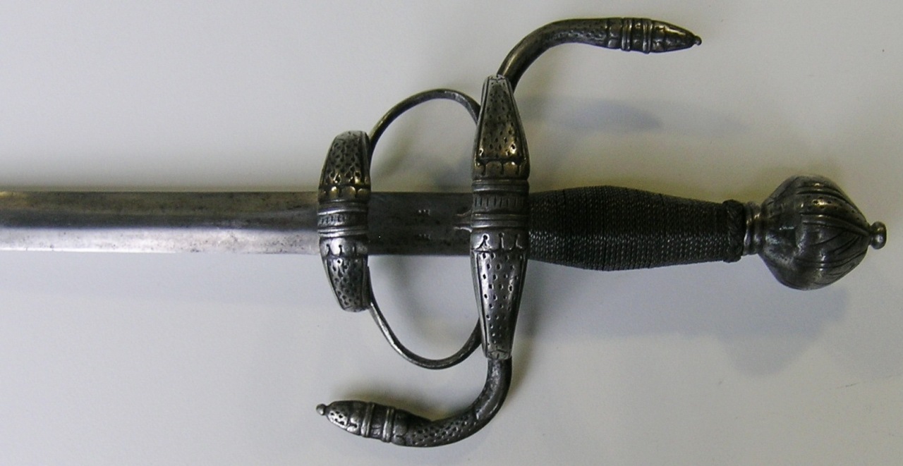

Hi Guys
I have the opportunity to purchase this sword but do not know if it is real or a Victorian copy. Our Field is basket hilts and Georgian swords and I do not see a lot of Rapiers and tend to buy early swords only from a well respected source. The provenance of this sword is unknown; any help would be greatly appreciated as I have only till Friday to make a decision to pursue or walk away.
Pictures posted in folder.
Cheers Cathey

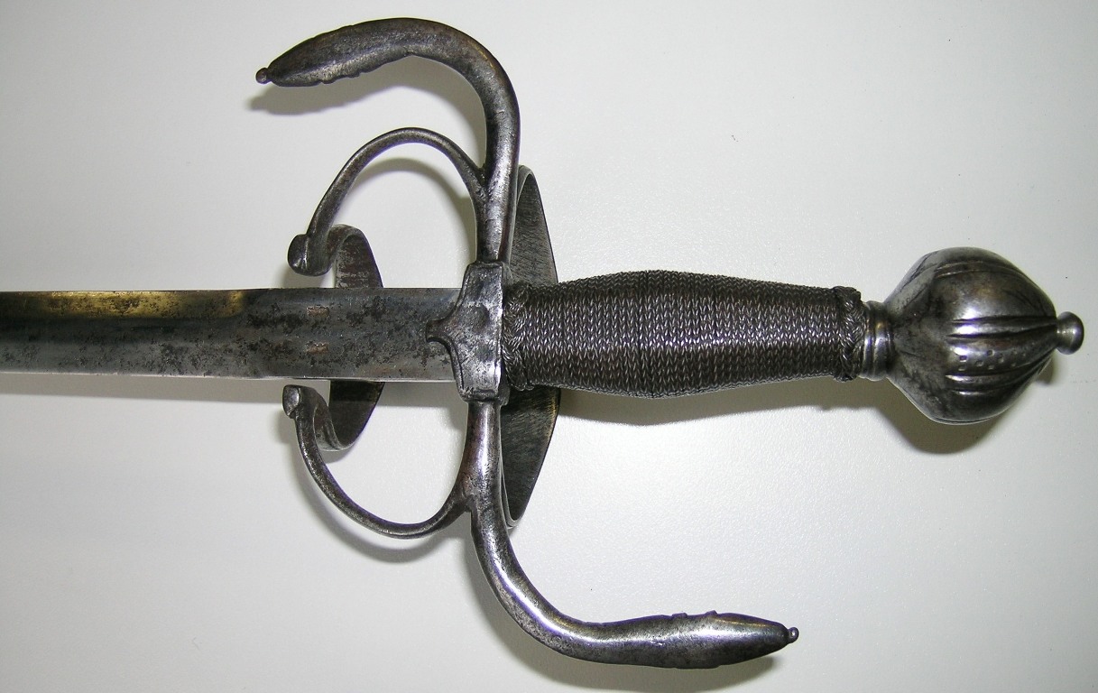

My $.02 which should be taken with a hefty pinch of salt. I would wager that not only the grip wiring, but the whole grip is a replacement. I may be wrong, but the hilt construction appears unusual, and I wouldn't be surprised if, upon close examination, it was discovered that a couple of branches were removed. The condition of the blade does not correspond with the condition of the hilt. Whether these were period alterations, I can't say.

This is how this sword may have looked like originally.

Hi, the sword has never had intersecting parts between the rings and this is quite common of swords of this age. The blade has been heavily cleaned/buffed. I am resonably confident in the blade as it is extremely long and flexible. Most copies I have seen are considerably shorter.
Cheers Cathey

I did not suggest that the blade or the hilt were replicas.
Again [in my meager experience] unaltered period examples of this style, without the rear branches, are uncommon.
I guess I was lead astray by the title of this thread - "Urgent Help Needed".
You appear to be quite confident that the sword is right. Please post some better photos of the hilt, once you acquire it!

Taking into account that Dmitry knows a lot about these things ... i know nothing. But i must say that this sword looks unsuspicious to me
If i was offered such piece, i would most probably buy it ... if i had the money
But by no means you should take my impression into a valued factor!

no you have not misunderstood me, I always have doubts. The Sword was dropped off for inspection last night and we had to take photos under less than ideal conditions. The more I handle it the more I like the blade which has been mechanically cleaned. I have found this not to be uncommon in swords out of the UK where I suspect this come from; however I question why the hilt did not require the same treatment and wonder if this is not a marriage. In Australia we do not see many rapiers in the flesh and I have been offered this sword previously and walked away. I will see if my Rex can try and take some better pictures today while I am at work weather permitting. Sadly I would love it to be right and hope that I am not talking myself into that position.
