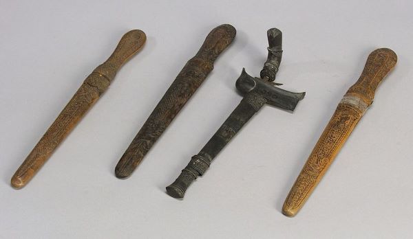

I HAVE SEEN THE DAGGERS WITH THE PARMOR SPEAR BLADES REFERRED TO AS TOMBAK, IS IT THE CORRECT NAME OR IS THERE A BETTER NAME FOR THEM

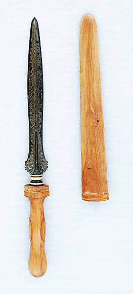

AS TO HOW THE DAGGER MADE USING AN OLD SPEAR BLADE ORIGINATED PERHAPS IT WAS BECAUSE AN OCUPING FORIGN POWER PASSED LAWS FORBIDDING SPEARS BEING CARRIED INTO TOWN. OR IT MAY HAVE COME ABOUT AT A LATER DATE WHEN SPEARS WERE NO LONGER CARRIED AS GUNS WERE BEING USED.
I AM INCLUDING A PICTURE OF THE PHILIPPINE DAGGER SPEAR, THE SHAFT COULD BE REMOVED FROM THE SOCKET IN THE HANDLE AND CARRIED INTO TOWN LEGALLY AS A DAGGER. THERE ARE PICTURES OF 4 TOMBAK DAGGERS AS WELL. AS USUAL THE PICTURES I AM INCLUDING ARE FROM OTHER SOURCES THANKS TO ANY MEMBER WHO MAY HAVE ORIGINALLY POSTED THE PICTURES.

Hello Barry,
If the blades have a metuk, they certainly qualify as tombak reagardless of the fittings. I'd stipulate that the pics show modern fittings though.
High-contrast pamor is often seen in Javanese spear blades but not all tombak exhibit this feature.
Yes, just convenient storage after becoming obsolete as weapons. I can't remember having seen an antique example mounted as a dagger though.
Hinalung: http://www.vikingsword.com/ethsword/ifugao/index.html

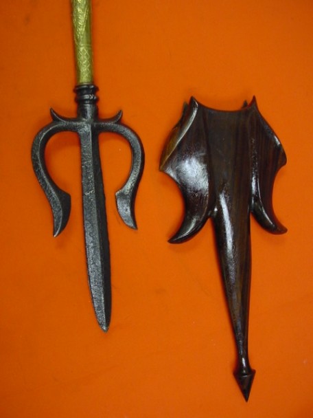

THANKS FOR THE INFORMATION KAI
I HAVE SEEN QUITE A FEW SPEAR BLADES THAT ARE IN VARIOUS INTERESTING FORMS, ARE THEY CEREMONIAL. I ALSO WONDER IF THEY WOULD BE REFERED TO AS TOMBAK OR WOULD HAVE ANOTHER NAME DESCRIBING THEM.
PICTURES OF A NICELY STAINED TOMBAK, AND PICTURES OF VARIOUS FORMS OF SPEAR FROM JAVA.

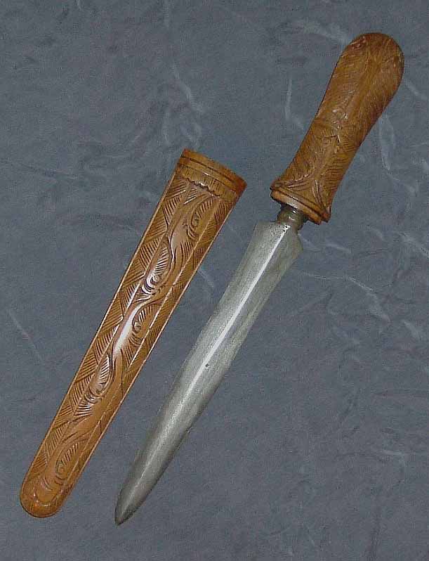

Welcome to the Forums BigG .

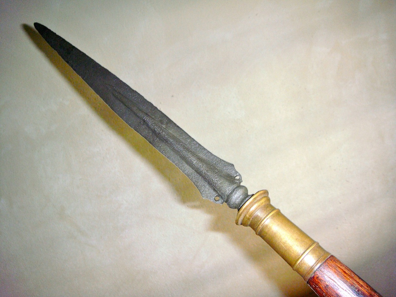

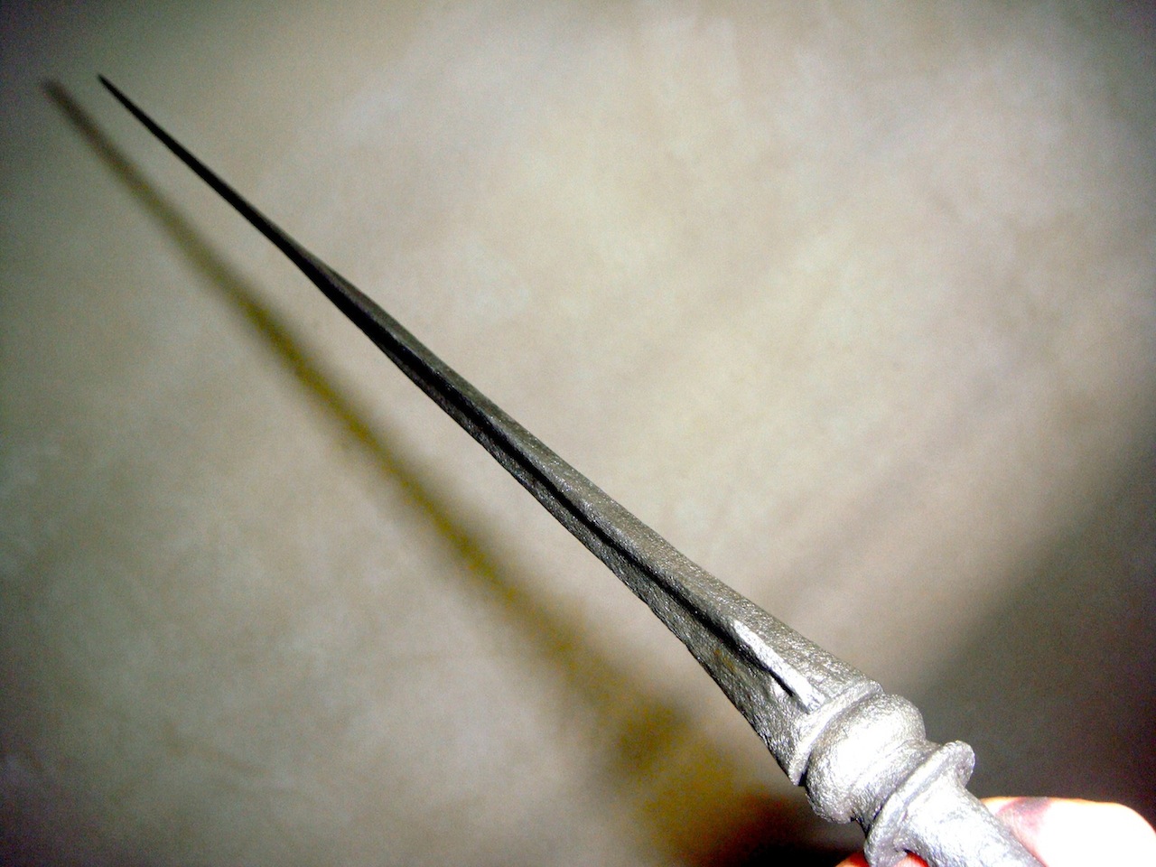

Here's another spear head for consideration; the Metuk is a separate piece .

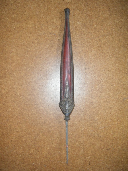

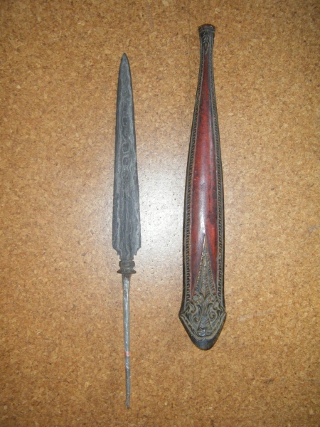

mine,
9.25 in. blade, 1.25 in at widest, diamond x-section, 5.25" long 3/8" round tang. not sure what 'pamor' this one would have.
Old 8th August 2010, 07:35 PM   #17
Posts: 6,441
It looks like it may be an adeg (on edge) style of pamor .

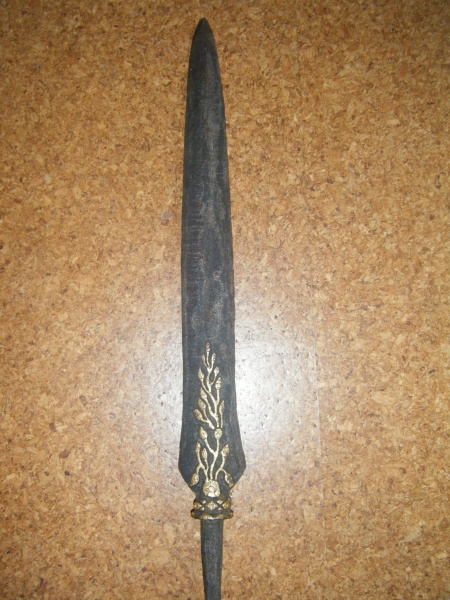

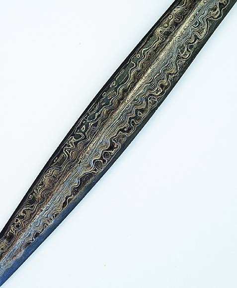

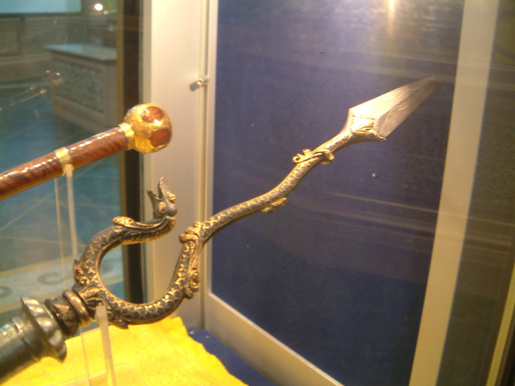

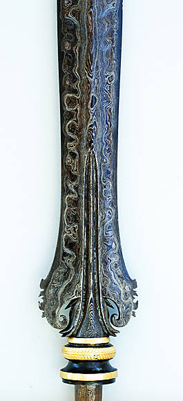

Another fine example:

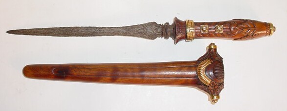

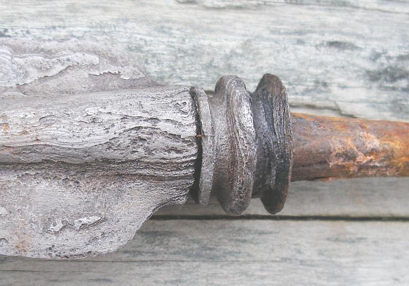

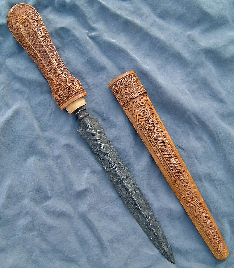

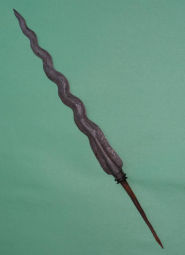

Couple more; one smooth finished and a fairly short blade; the other, recent Madura C. 1980's

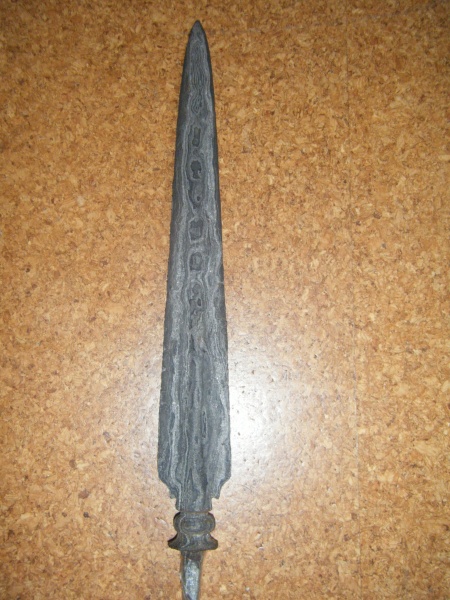

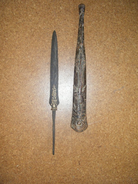

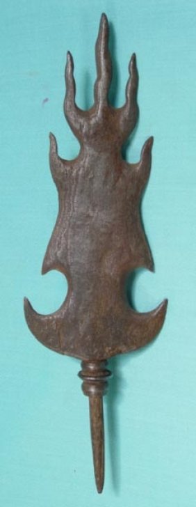

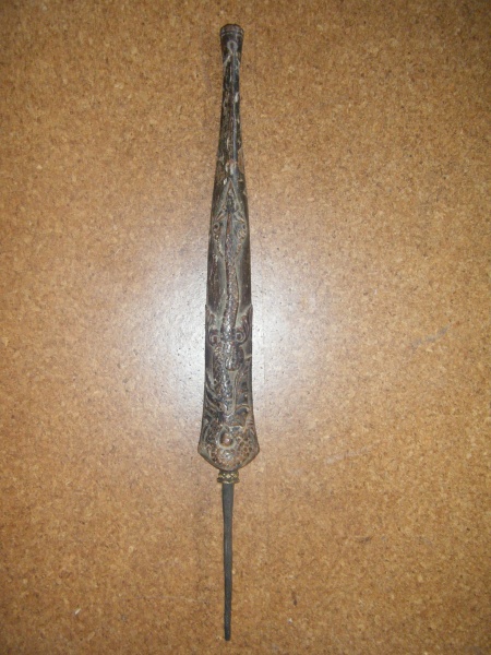

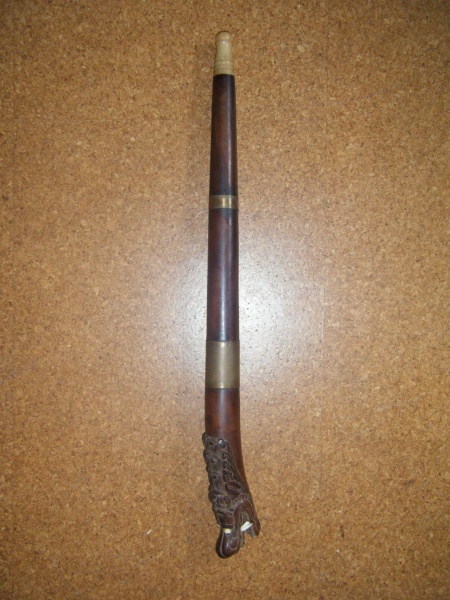

Here my tombaks. The first two are from Java and the third one I think from Bali.
