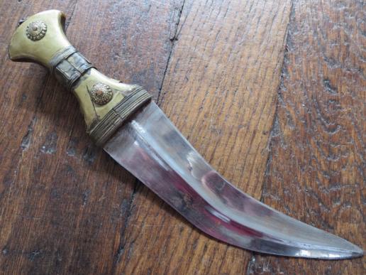

it is of course a so. american version of an old friend, the double edged jambiyah/koummiyah/shabriyah, whose use of the pint down, inner curve we discussed recently on another forum.

There are obvious similarities between the modern corvo and the jambiya.
However, the development of the corvo appears to be quite separate and uninfluenced by the jambiya style of weapon. The corvo started out as a single-edged, sickle knife and tool. From there it evolved to a weapon (sharp on the concave edge only) and eventually a double-edged weapon.
A number of years ago we had an extensive debate about a possible Arab/African origin for the corvo and concluded there was no evidence for such a link or association, rather a similar end point but from different origins.
Ian.

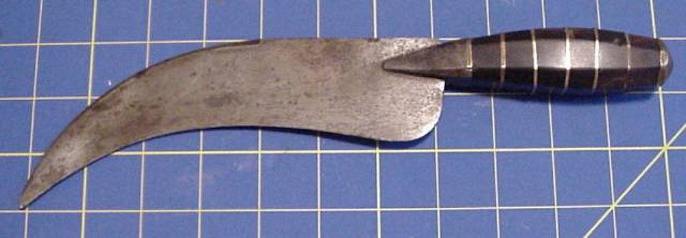

Here is a clearly documented 19th C. corvo. The officer pictured is Sub-Lieutenant José L. Herrera and the picture was taken in Antofagasta on February 20, 1879 (very early in the Pacific War just after the seizure of Antofagasta by Chile). Note the bolster on the hilt and absence of a guard. This was a civilian knife taken to war.

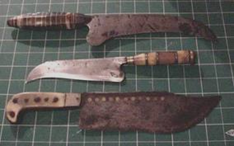

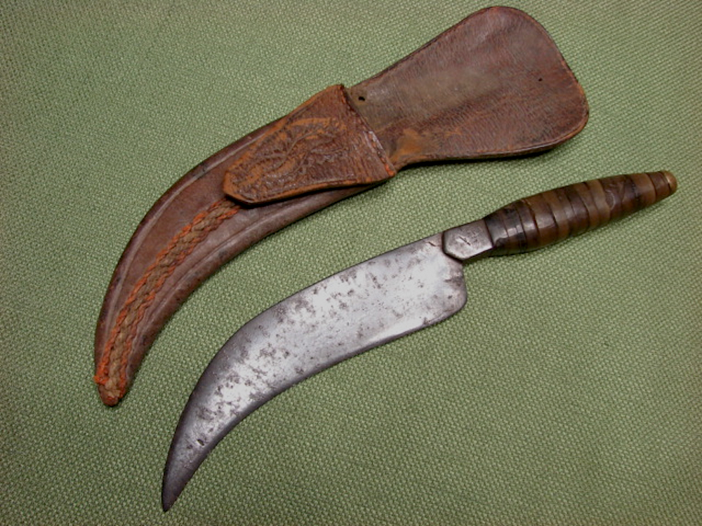

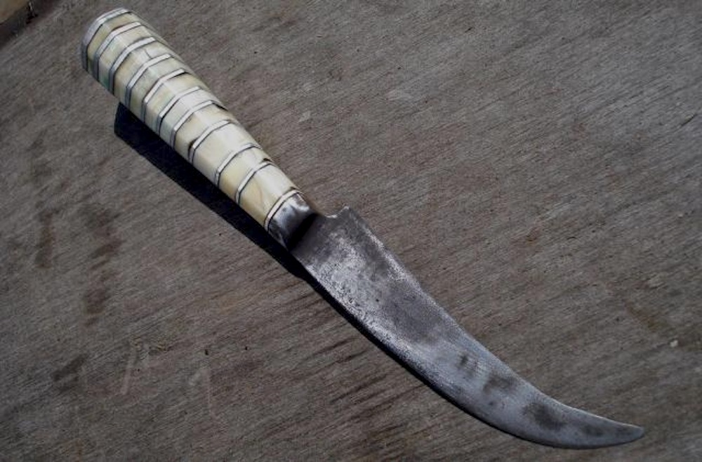

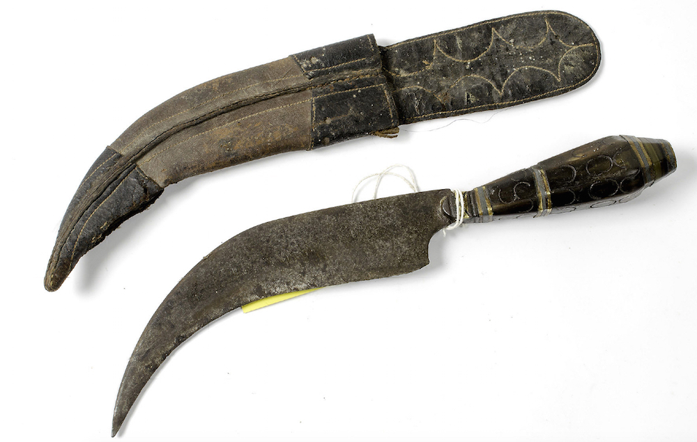

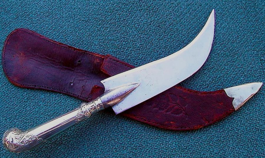

Examples of 19th C. corvo. Note the "Spanish notch" on the blade of the silver handled one, the one below it, and two in the bottom picture--I have not seen this feature on 20th C pieces.

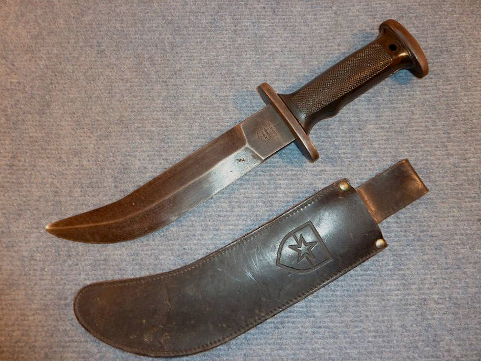

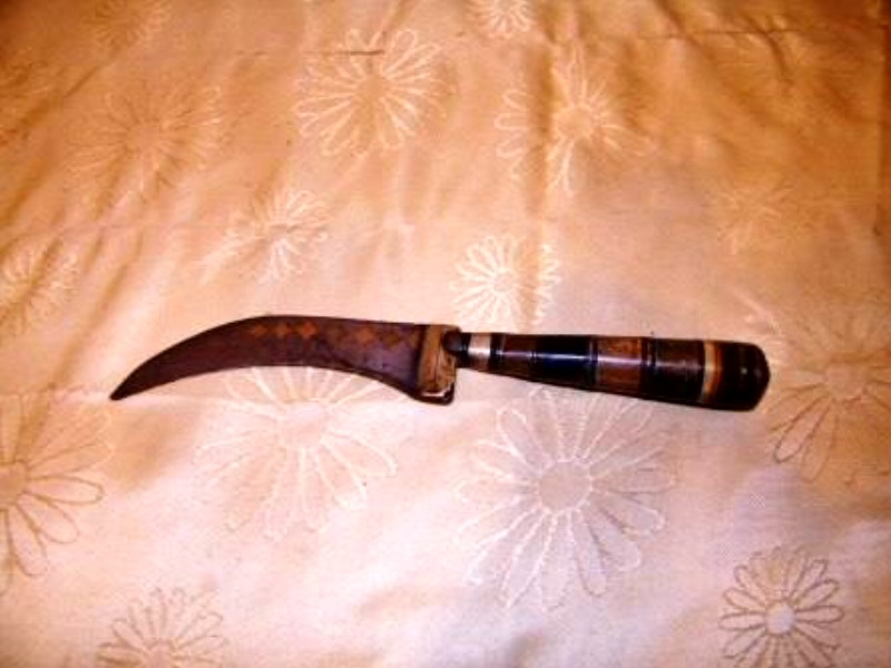

Early to mid-20th C. corvo
Examples elsewhere on this site:
http://www.vikingsword.com/i3/e1526a.jpg
http://www.vikingsword.com/i3/e1526b.jpg
http://www.vikingsword.com/i3/e1526d.jpg
http://www.vikingsword.com/i3/e1526c.jpg
Other examples:

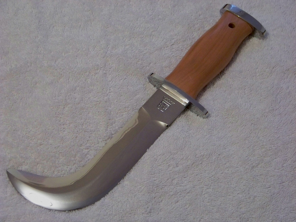

Military corvo.

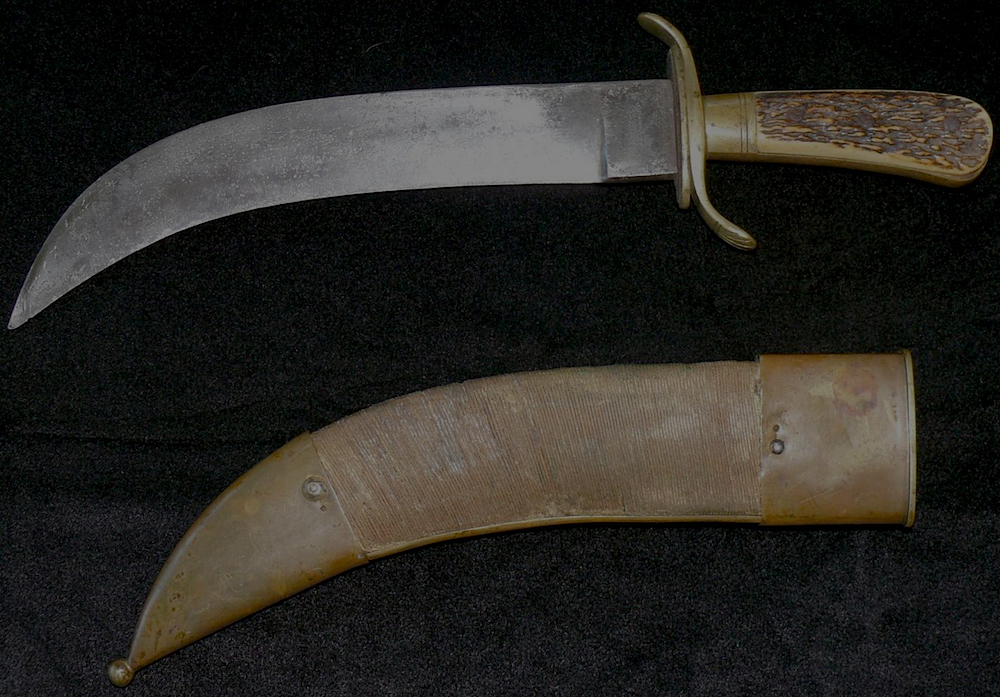

A European version of the corvo. A German single-edged hirschfanger made in the corvo style and manufactured by Laute in about 1910.
