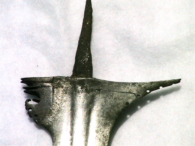

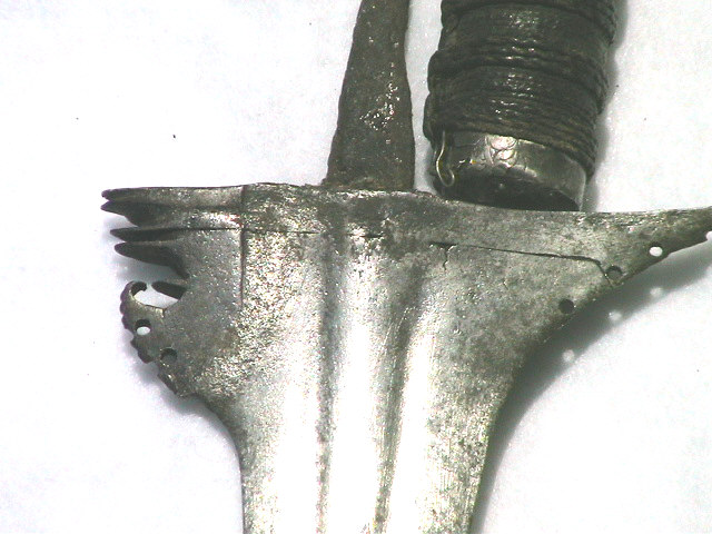

Hi, Bill, could you please show us pics of these gangya? Pretty please...
ian, i hope i'm not breaking any rules but if i am, my apologies and please feel free to delete this reply.
hi kai,
read this query on the other thread.
anyway, i have one that has a narrow gangya. i'm not sure if this is what bill meant but he estimated this particular one to be around 175 years. hope this helps.
Thanks for the pics, Spunjer! However, your nice kris isn't a fake (AFAI can tell... ) so we probably should start a separate thread to keep this discussion focused on fakes.

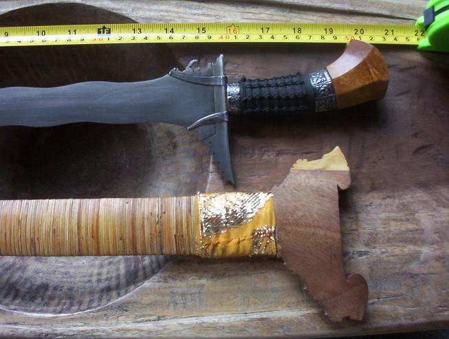

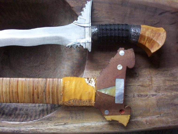

Default Newly made boy's kris
From a friend's collection and not for sale. Newly made sulu piece specially commissioned for a child.
Separate gangya. 15.5 inches blade, 21 inches overall. with silver fittings.
It has a larger brother which I hope to have in due time.
I also have an older one (post ww2) with separate gangya but i cannot post it here in deference to forum rules.
