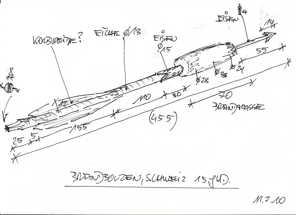

Ok,
Here they are just in case the person in concern reads this thread.
It'a 14th/15th century Swiss incendiary crossbow quarrel; the haft is of oak, the flights are of osier (withe). All data in mm.
m

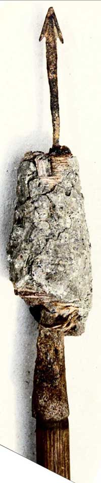

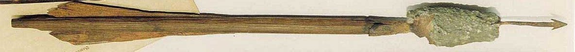

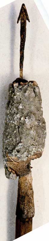

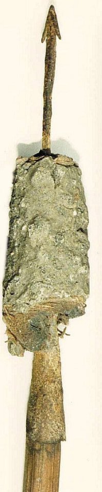

And here is the original piece once again, including a percentage listing of its incendiary components; the outer layer is sulphur, now turned to gray. 4 small oak sticks and layers of linen are meant for stabilization and controled delay of the burning time. A remainder of a piece of matchcord for ignition can be seen.

Hi Dirk,
The flights (feathers) are about 1.5 mm thick.
Best again,
Michael
