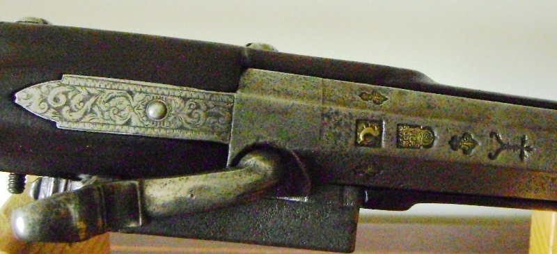

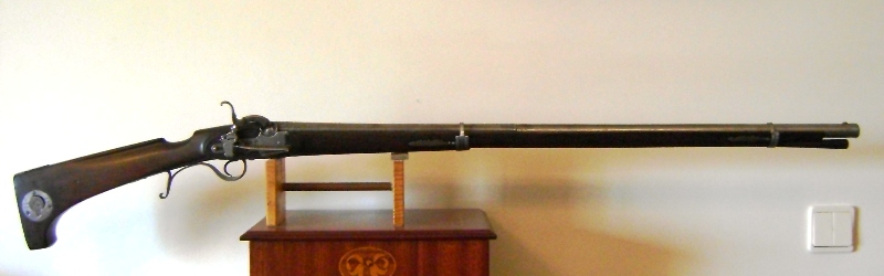

Very good condition, not many miles away from excelent; no repairs, no gaps, no loosenesses ... only a bit too cleaned (polished?), specially at the barrel front section, possibly due to the previous owner wishing to erase some pitting... not sure.

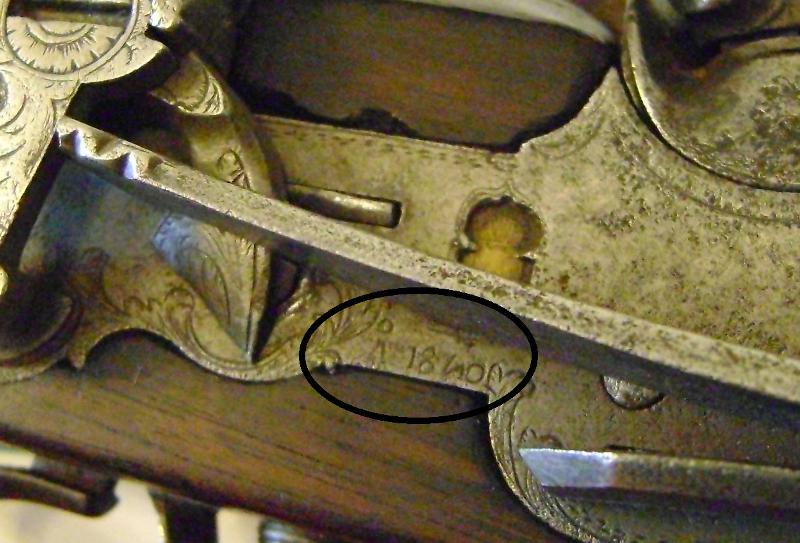

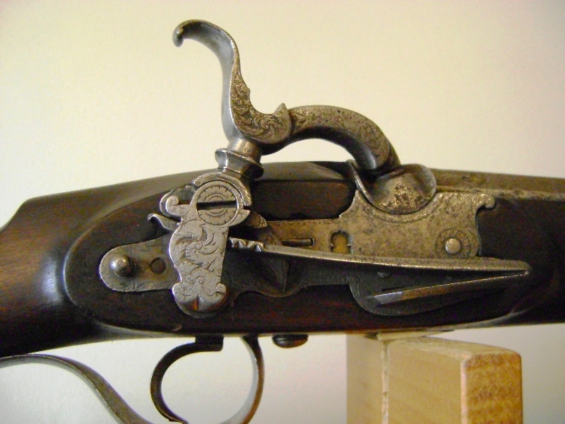

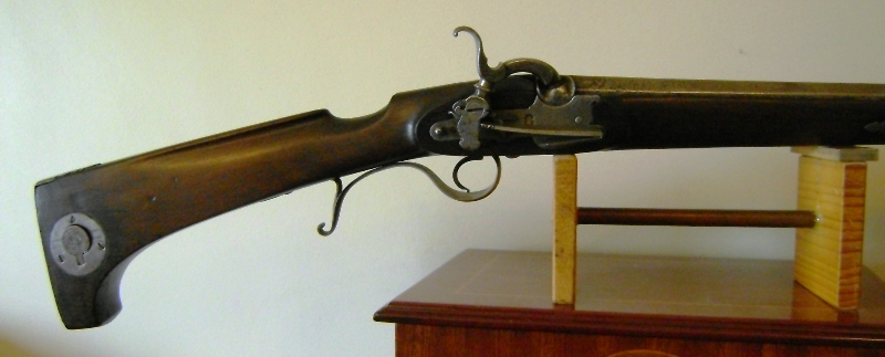

The patilha (Miquelete) lock, in the genuine late percussion version; dated 1840.

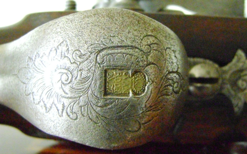

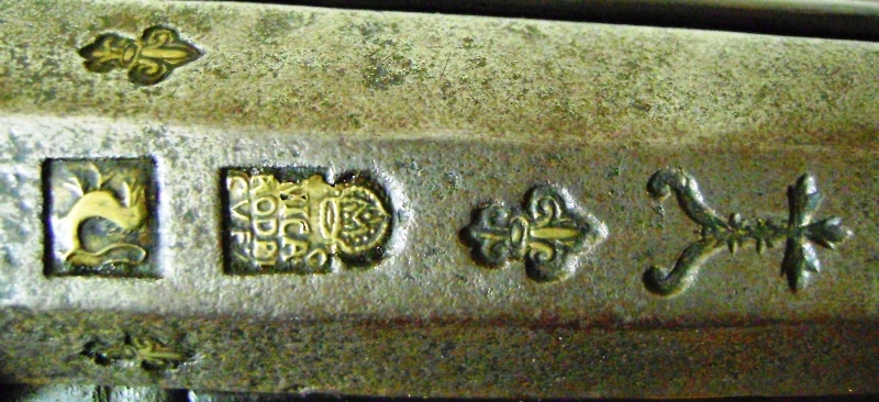

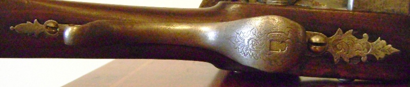

The barrel and lock bear the punctions of M Vicaš (Vicario) Rodriguez and the trigger guard bear those of Juan Rodriguez.

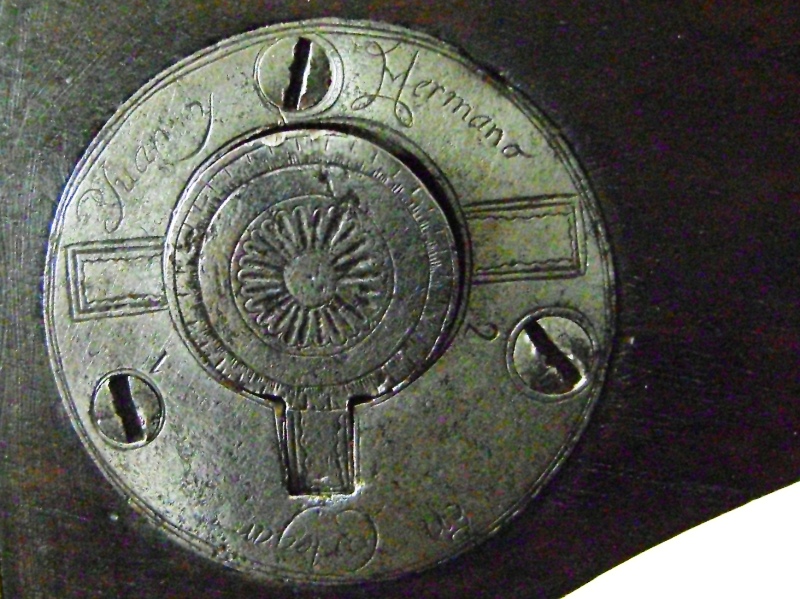

The caps box has inscribed Juan y Hermano en Cortegana, which confirms the gunsmiths were two brothers; Cortegana is in the Huelva area.
The caliber is around 18 mm; i am not certain if at this stage you could already call it a 12 gauge; can someone enlighten me?
The wooden ram rod could be the original ... a little bit short, though.
Traditional stock a la Catalana (or boot).

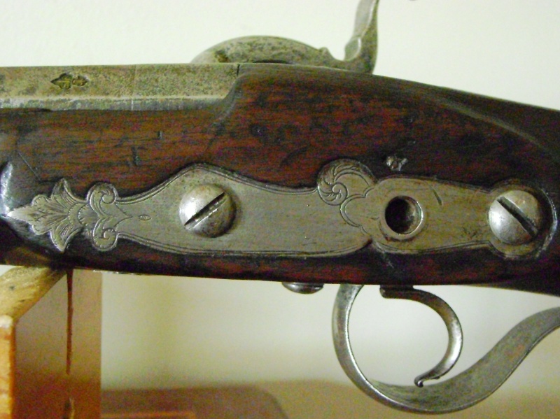

There is a threaded hole on the counter plate; missing some kind of ring ... i wouldn't say a hook. I will have to figure out what it was.

Absolutely beautiful piece, Fernando! Where did you find such an intact piece! When I first saw that threaded hole, I thought perhaps there might be one on the other side (as in, mounted with a swivel base), but not the case. I am excited to hear what the experts have to say about this fantastic percussion piece. Congrats again!

It must be some kind of suspension device, although this intrigues me, as such characteristic would better fit shorter items, like pistols or short blunderbusses and carbines.
This escopeta measures 1,25 mt (1ft 2"); if you held it from the belt by the spot where the threaded hole is, it would nearly touch the ground. And this is no cavalry weapon, i would say?
The truth is that this shotgun has no hanging belt, which is unusual. Maybe this hipothetical ring would do the job ... but how? .

That's just what I thought. Yesterday I received a book.with copious illustrations of Napoleonic french soldiers, many of whom were dragoons.
They were depicted as carrying a carbine hanging from a shoulder belt, or even from the saddle's horn, attached to the gun in the same area yours has that hole. So I guess it was probably a ring, to carry the carbine at the ready while hunting from a horse.

A Miguelete in 1840? By this time, most Spain had switched to the French lock.
How about an 18th C reworked Flintlock, converted to Percussion ?
Who was Juan Rodriguez?

I had already heard in the grapevines that the caplock Miqueletes remained in use up to the advent of the catridge (1835). Considering this in a general manner, i wouldn't be surprised that some provincial gunsmith still made some pecimens in 1840, be it for nostalgic reasons from either himself or an exquisite customer.
I guess that, in weapons as also in other technologies, the introduction of new techniques doesn't necessarily demobilize the previous ones... look at me, so literate .
Amazingly the last flintlock weapon made in Portugal was the copy of the New Land Pattern pistol, produced in the Army Arsenal, dated 1846.

...Who was Juan Rodriguez? ...
Good question; i was expecting you to tell me .
It appears that gunsmiths (or other craftsmen) only come listed if they work in the country capitals or similar metropolis; who would know a couple 'handy' brothers from a Huelva little village.
But i am not particulary sad for that; at least the piece is not marked with a false name, 'borrowed' from a famous master, like so often happens.
Obviously i would love to their name somewhere .
