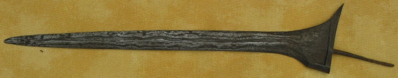

Dear Kerisophiles,
Since we're getting so much valuable input on Keris from Java I'd like to throw in another example. It still keeps amazing me how much can be gleaned from all these Ricikan details. However, I'd really appreciate to get more hints on how to approach Keris with less elaborate Dapur which I happen to like as much as many of the more fancy ones...
Let's start with the plain blade first (I'll add pics of the sheath later). Thanks for your contributions!

Close-ups from the right side:

Close-ups from the left side:

Cool Forgot to add measurements:
47 cm (18.5") total length
42.4 cm (16.7") Keris without sheath
38.5 cm (15.2") and 14.1 cm (5.5") Warangka [sheath] length and width, respectively
34.0 cm (13.4") Wilah + 6.7 cm (2.6") Pesi [blade + tang]
7.64 cm (3") and 2.1 cm (0.8") Ganja and blade width, respectively [the latter measured halfway from the tip]
8.2 cm (3.2") Ukiran [hilt]
Hello Kai,
Your keris is old and looks so interesting. I think the dapur (shape) is Tilam Upih with pamor (damascan) which called Adeg (vertikal lines). Made in good ironwork, so that why the blade still intact.
The sheath (Jawa = Wrangka) in Gayaman Jogjakarta (Jogja) style made from Kemuning (yellow tree) wood. Also the handle and pendok in Jogja style.
Nice collection.
So any keris lurus with only these 3 features (Gandik, Pejetan and Tikel Alis) is always dapur Tilam Upih - no exceptions or subcategories? That would suit my simple mind well...
.... So any keris lurus with only these 3 features (Gandik, Pejetan and Tikel Alis) is always dapur Tilam Upih - no exceptions or subcategories? That would suit my simple mind well...
The ukiran still feels nice in my hands (which are not too large) although it is pretty small compared to other handles I have. Is this small size still within the usual range or does it indicate an owner of rather small stature?
Yes you right, that if the keris has characteristic/feature (Jawa = Ricikan) of Pijetan and Tikel Alis is called Tilam Upih. If the keris has just Pijetan, can be called as Brojol, etc. It all are name of shape (Jawa = Dapur) of keris which each Dapur has the different feature.
