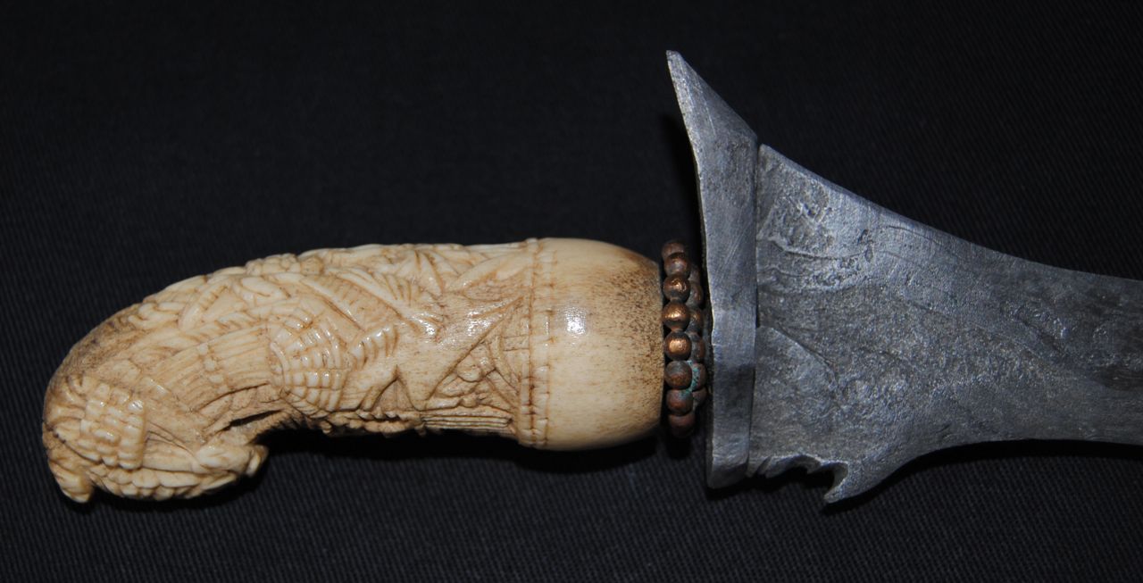

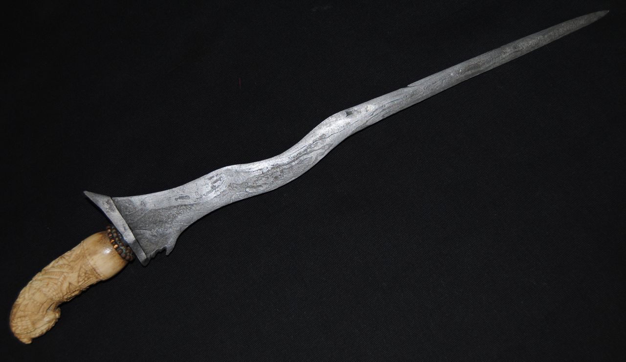

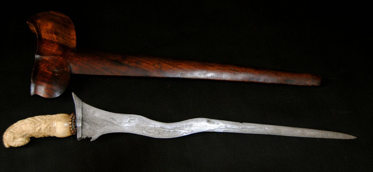

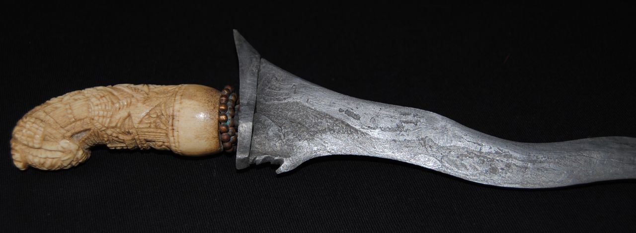

I want to present you an old pieces of my keris for opinion

Someone can tell me te origine and the type of the blade and its pamor?

A three wave blade .
Maybe from E. Jawa .
IMO the real prize here is the lovely one piece wrongko .
Pamor ????
I agree. Better photos of the sheath might be in order here.
Can't really tell for sure, but the hilt looks more likely to be antler than ivory. The blade looks a bit rough. A good staining is in order and might make a pamor ID a bit easier.

The hilt is bone, I think. Pamor could be ngulit semangka, but the workmanship of the blade seems poor, same for the mendak.
Besides the one-piece scabbard, also the Madura hilt is noteworthy.

I don't think I am seeing any core in this blade .
Pamor appears sort of 'twisted' .

It's sure , the hilt is made with ivory.

May I see a picture of the hilt taken from the top, please ?

Hello Ericlaude,
it's very difficult to state an opion about the material by a picture but I also would bet that the hilt material is antler. I see at some places porosity. Is it possible to remove the hilt from the pesi and take pictures from up and down of the hilt?
sajen

In final, I'm sorry , this hilt is made with bone.
