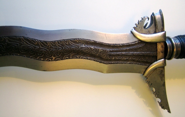

![]() Yea or nay . See you all in 16 days (or so) . Rick |

![]() I guess that most of the reluctance to attribute at least the twistcore as a true pamor pattern results from the missing warangan staining (not traditionally done with Moro blades) and thus different appearance. Rick, just send me one of your twistcores and I'll post pics of the warangan stained blade which will remove your doubts. Regards, Kai Last edited by kai; 16th March 2008 at 04:35 AM. |

Unless I've got it wrong so far, pamor on Indo-Maly keris is a patern-welded jacket of soft nickle-iron that covers a hard steel core. Moro kris have a soft patern-welded core surrounded by the hard steel edge, so the resulting structure is different. If these two things are taken to be the same, then would Indian patern-weld also qualify as pamor? Would Turkish Ribbon or Scandinavian twist-cores? Is pamor to denote just the look of the blade, regardless of structure? Regards, Emanuel |

Here is a Sulu, or Malay, Kris we discussed a couple of years ago.
Michael Last edited by VVV; 17th March 2008 at 06:34 PM. |
