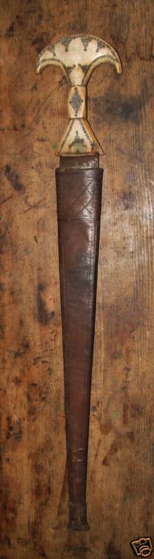

Recently finished on ePray ......quite possibly Sudanese, but to me this looks a little 'touristy' and probably fairly recent.......or am I missing something here ?

Its a real thing certainly, quite rare, probably from Darfur or Kordofan.

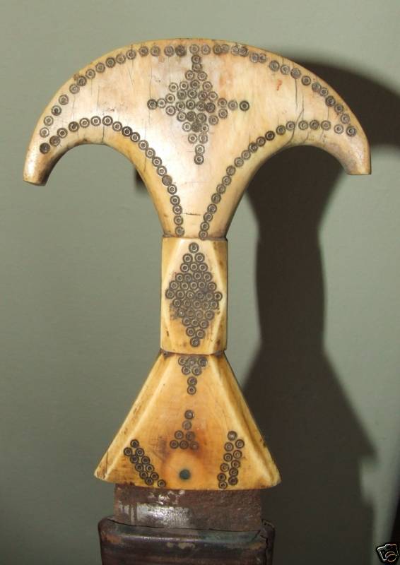

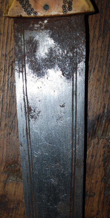

I am surprised ... the quality of the workmanship seems 'below par', the 'dot and circle' motif isn't symmetrical.
The blade looks very thin ....with the scribed lines are common to many of the larger touristy blades.

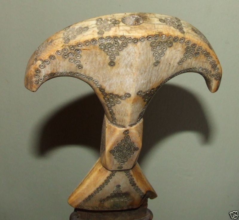

I do really like the form and shape of the hilt, it does have some age ( I must admit that I originally thought it artificially aged with heat applied to encourage cracking)...any idea as to what the hilt is made from ? I still feel that the blade is suspect ....but that is a opinion based on the pictures.

The handle must be ivory, I have also seen them with rhino horn hilts...

An extremely nice and interesting Sudanese short sword, and without further researching seems to correspond to forms from regions in Dunqulah (Dongola) with the shape of blade and outline lines following its profile.
The interesting lunette shape on the pommel of course recalls those on the koummya and reflects the diffusion of influences from trade inroutes from probably Egypt and caravans from the north, northwest.
It does not seem 'touristy' and though inconsistantly fashioned in its motif was probably crafted by local artisans in imitation of other established decoration, and possibly for a local chieftain or tribal leader, ivory was not a rank and file commodity. I would say it is 20th century, with some age, probably 50 or more years, at a cursory estimate.
All the best,
The circle dot symbol is seen on other examples of this type sword from this region, the ones I have seen have more of a drooping 'T' type pommel. The symbol is seen on motif on other edged weapons hilts from the Saharan regions also.
