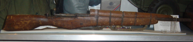

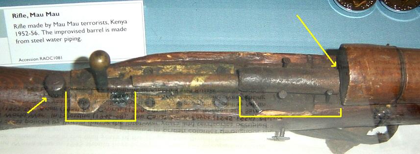

This is cool. The bolt action is an old brass? gate bolt. sorry the pics are huge but hard to see otherwise.

Hi Tim,
interesting that a 'fake' gun would have been used in the uprising.....adds more weight to the idea that your 'rifle sword' was made with the same idea....to fool the enemy. At least yours had an added practical use.

Originally Posted by katana
Hi Tim,
Regards David
Yeah, i don't think this is a "fake" gun. I'll bet it worked once.

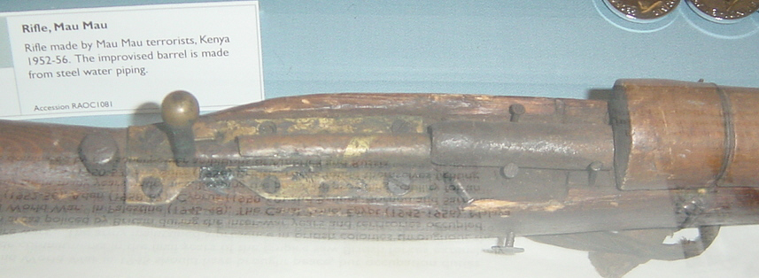

Hi Guys,
I don't think this is a 'fake' gun. If you extract the bolt, insert a cartridge, reinsert the bolt, stretch elastic round the bolt and attach said elastic to the nails on either side of the gun then pull back the bolt manually and release, as long as you file down the bolt face to leave a small protrusion or insert a steel pin into the bolt face = a firing pin, it will fire a centrefire, .303 most likely, cartridge no problem. The Zip gun I believe operates on a similar principle. Totally inaccurate and probably just as dangerous to the firer as the target but deadly at very short range.

These were made to just fire once and then hopefully enable the terrorist to pick up a real gun from the victim. These were much cruder, but the same principle was used during WW2 with the "Liberator" single shot .45acp pistols that were dropped to the French resistance fighters who then would capture German weapons.

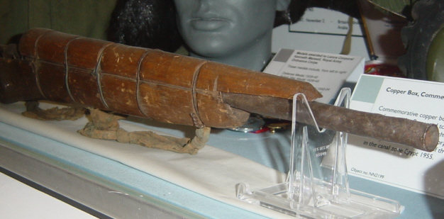

I suppose 'fake' was too inaccurate a description....but there are several reasons I used the term.
The barrel is made from water pipe which is likely 1/2" diameter....and is almost certainly 'seamed' .....and as such is likely to 'burst' on firing ....
The section of 'pipe' which the 'bolt' slides looks to be a section of half pipe (held by the nails ?) which looks decidedly fragile when you consider the force of the 'blow back' gasses from firing a bullet.
To aim....albeit inaccurately....would require 'sighting' down the barrel ....would you put your eyes anywhere near the bolt mechanism on this ?
I am not so certain that this has been fired....there are no scorch marks evident. I also find it hard to believe that the Mau Mau would risk serious injury or death just to fire one inaccurate round at the British I think it would be better used to give the impression that you had a rifle than to fire this.
Perhaps, if shot gun cartridges ....with some of the 'charge' removed...were used this may have been 'more' functional
Regards David

These Mau Mau home-made guns were definitely made to be fired and used. There is another one on display in the Canterbury Museum and no doubt the National Museum in Nairobi will have some.
The Mau Mau were very short of firearms and tried hard to capture real guns from the Security Forces and European civilians, who almost all carried firearms at the time.

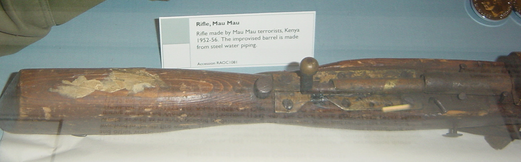

if you fired a .303 in this you would be deader than a door nail in a second,
it is proably a .22 or a 38 caliber pistol round or maybe at the most a 9mm,
ive owned some of these in the past. some pistols with very long barrels , about 45cm or longer, useless junk they were 9mm guns with a sprung pin you pulled back and a simple trigger..
there barrels were made from 9mm seamless tubing,
it seems the mau mau had little or no skill making guns, and these things were sad... poor contraptions that showed no understand of how a firearms would be used or how it should work..
rely none had a practical range of more than 5 or 6 meters.. as they were firing from an unsized 9mm tube...a and they also were firing normal rounds and not a round ball .. so they just tumbled out ...
dangerous things,, and yes i fired some .. not holding them!, as im not insane..
i aquired a bundle of them from a gun collector who had relatives who had been in kenya in the 40s and 50s..
he told me these type of guns never accounted for much and that sabotage seemed to have been the made cause of trouble.. i can see a spear or a machete being more effective than these bits of junk..
but i guess the instinctive human fear of a gun no matter how poor is more effective than a machete or spear..
if you want to see good quality functional homemade guns that are effectivly used in combat the guns from new guinea and from boganville are some good exsamples..
many look like copies of harrington and richard single barrel shotguns, but on closer inspection they are made from pipes and hunks for steel and such,,
most are 12 gauge , ive seen some smaller 410's too, these are mostly strong enough to be used for hunting and such as well..
what is surprising is that there homemade guns are mostly made in the tribal areas of which most are still in a semi stoneage exsistance.. so these people many times are using wood and stone tools still in areas they cant get steel tools for
guns are cheap in PNG , so anyone living near a town can buy a shotgun for next to nothing and a ak47 or SLR for a fair price.. so there isnt any need to make them..
in west papua the bush guns mut make up half the guns the natives use to fignt the indonesian ocupation with.. same with in boganville..

Posts: 6,026
Very interesting. A picture of the PNG guns would be great? I too only imagine this Mau Mau example working with a 9mm round. Bang at six metres from under a coat or jacket and you might be dead if not you are very unlikely to start jumping around fighting back. I would think it not hard for the house maid or other servants to secure the odd 9mm round from thier masters home. I have heard that they say in counter terroism, "shoot the women first" .

Posts: 1,657
I think it would be much easier, mechanically, to use a rimmed round, .380 or .303, rather than a rimless, 9mm, one and possibly easier to source as, if I remember correctly, the only British weapon at that time to use a 9mm round was the Sten/Sterling. The European farmers etc. would have used a more eclectic range of calibres but I would think 9mm would still be less evident than some others. In the end the insurgents would have used whatever they could get a hold of.

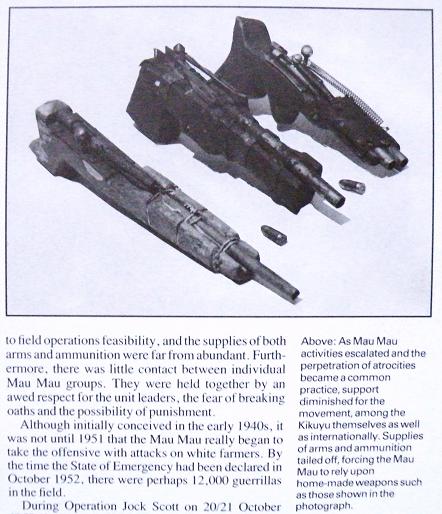

Hi
I was looking through some old papers the other day, and found this in a 1980s magazine...a picture of Mau Mau "pistols" including a double-barrelled variety !
