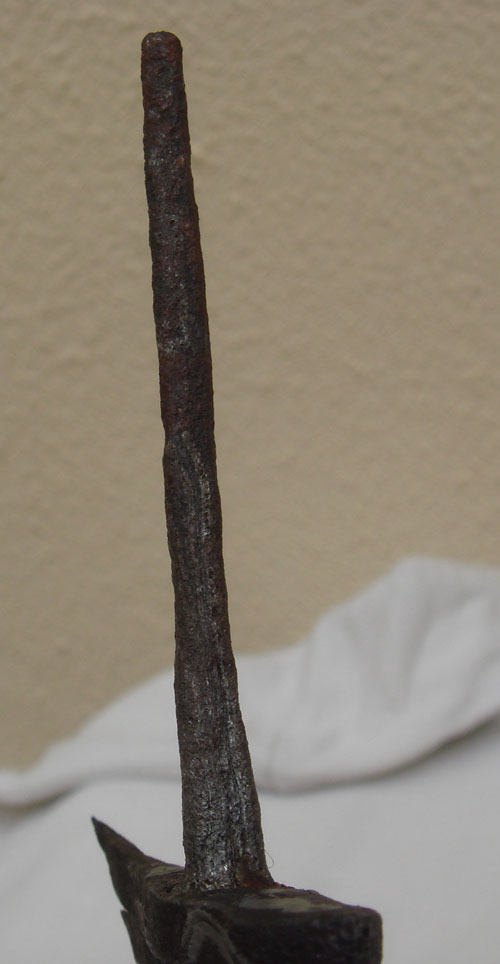

In one case, I have nasty reddish rust at the pesi. The rest of the blade was cool so it's quite a bad idea to clean the entire kris. What should I do to just clean the pesi?

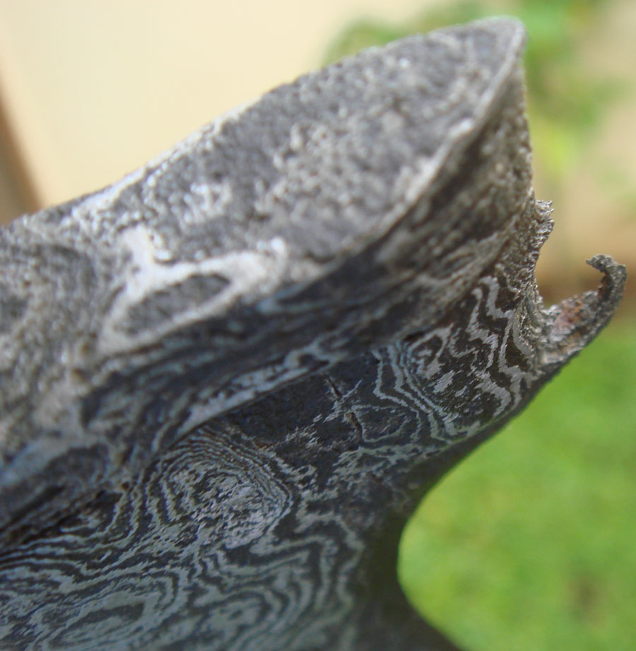

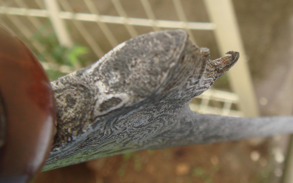

In another, I have this blade that is estimated to be from Segaluh era. There is rust just at the bottom of the already pretty thin kembang kacang. Another session of rigorous traditional cleansing can break the kembang kacang, so I'm thinking about using non-conventional methods, relying heavily on modern chemicals. Ideas, anyone?

If the rust is only on the tang, I'd rub it off with steel wool, any large hard lumps of rust I'd pick off with a sharp tool --- I use a saddler's awl --- then I'd touch it up with cold blue and oil it.

Thanks for the reply, guys. It turns out that my IT skill is not as bad as I thought Here are the pictures. I just acquired this supposedly Segaluh blade in this condition couple months ago and the rust at kembang kacang was already there. The rest of the blade was pretty much okay with very little rust spots in certain parts.
So ... now that we have the image - hopefully it adequately shows the situation - do you guys think this kembang kacang is strong enough for rubbing with lemon or pineapple juice?
If the kembang kacang will survive another session of traditional cleaning, I am considering to have a professional do "the whole package" - from cleaning to re-staining with warangan. I don't know how to *correctly* perform traditional cleaning methods, so I prefer to just leave it to the expert if cleaning is the way to go.

I agree that local action should do for the tang. Try a good mineral oil for the bit of rust between pesi and gonjo and utilize a wooden toothpick and brush to clean the crevices.
Based on the bold pamor alone, I don't think this is a Segaluh blade. Can we have a pic of the whole blade, please?
IMHO the kembang kacang is in fair shape and will withstand gentle cleaning with no problem. I'd try to clean off the limited rust first rather than giving the whole blade a wash.

From what I can see of it, this blade does not look too bad at all.
Use a needle or an awl to pick the rust away, for the very small areas involved I wouldn't even use the cold blue, just a good drench with WD40 and then the usual keris oil.
I doubt that this blade needs a full clean and stain, but if it did, I would not hesitate to either do it myself or have it done commercially.
Storage in a plastic sleeve will help prevent further rusting. If you're in Indonesia, go to your local toko plastik and buy some of the plastic sleeve that is used to put snack foods in to sell in the market.Make sure its wide enough to take the gonjo.
I have preserved the original stain on a couple of Bali blades by using magnification and a needle to go over the entire blade and pick rust out of the pits and irregularities on a blade. In each case the job took about 2 or 3 months, working nights, and when I felt like it.

I will use steel wool and WD-40 on the one with the pesi rust, and if that doesn't work I would proceed with using the lemon juice to whiten the pesi. Mr. Maisey is right, neither Ace Hardware nor Hypermart has any Cold Blue. But I guess some decent oil coating and telfon tape covering will protect the bare iron inside the ukiran for a pretty long period of time.
