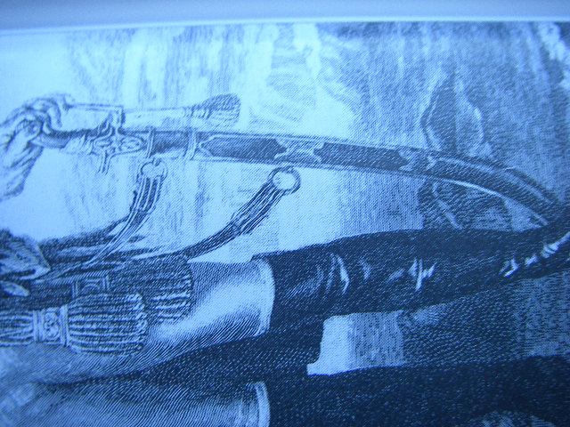

Hi guys, I have been reading a book about the Napoleonic wars, and it contained a pic of Davout with his sword. I am curious as to what sword a Marshal of France might carry. Can anyone I D the sword ? I hope that there is sufficient detail. Also a pic of the dustjacket, this type of action must have been terrifying for the participants, unless the excitement blotted out the fear.

The swords are different, one has a marked curvature to its blade, the others are Stirrup guard Hussard swords of the garden variety.
Here are some with similar features. (Click on the thumbs if you want bigger pics).

I think Manuel has posted well placed comments and illustrations in the type sabres common to high ranking officers in this period. After campaigns in Egypt, many of the French, and for that matter British, officers sought to have sabres of the type seen in use by the Mamluk warriors. The sabre itself was of course well established with light cavalry by this period, and these neoclassic style motifs were common, as well as certain elements of the Islamic sabres. The elliptical shaped langets are characteristically French.
