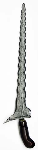

Bought this keris recently, but what is it exactly?
The hilt is painted.
Total length: 57cm
Emmanuel

I love the old painted hilts .
Interesting 'divot' in the sorsoran .
Not sure about the mendak/selut being Bali ..
Nice !

Nice hilt.
The selut is something bugis / malay. Remove it and the hilt will look even better.
Maybe a nice simple uwer can be placed under the ukiran, but I think even without an uwer the hilt will look very nice.
As for te blade. lots of lu(c)ks. A bit above my standard.

This is a peculiar keris.
The hilt does appear to originate from Bali, but it is not a traditional style nor motif.
The blade does not have the overall form of a Bali keris, as there are too many waves, the blade angle and proportions do not really fit Bali, the pamor does not look quite right, the garap does not look quite right --- without the handle I might be inclined to think Lombok, but together with the handle I feel that if I had it in my hand I'd be thinking current era Madura.
It is quite possible that the hilt could be a Madura creation as well.
The hilt ring/pendongkok/mendak is a Bugis (generic) form.
Is there a scabbard?
From what I can see in the photo my impression is that I am looking at a dealer's marriage of fairly recent pieces.
Sorry.

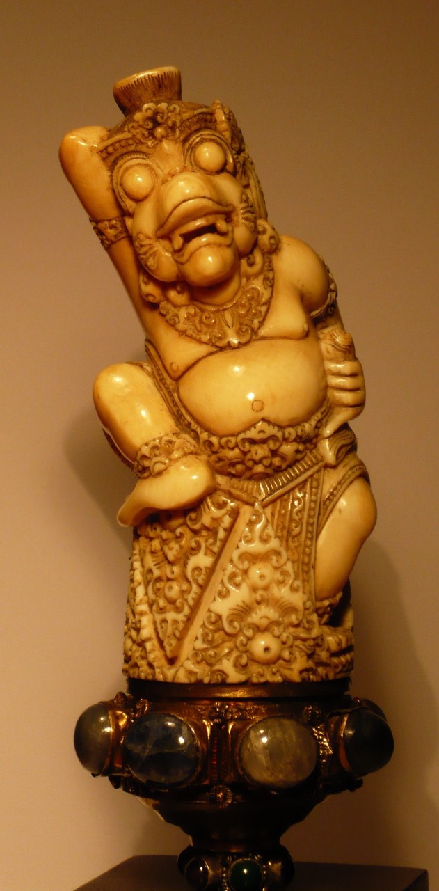

is possible to see the hit by profile and by back?
Thanks
Thanks
not so difference with this Bali hit (...of course only about the motif)
Old 22nd July 2009, 12:43 PM   #8
Posts: 7,263
Yes Marco, quite similar, but I feel that the key word here is "traditional", by which I mean a motif predating the current era.

For example on pag.30 of Jensen's work krisdisk (Bali section) there is a "traditional" hit with the same haircut....
Total length: 57cm
Emmanuel
The form of luks, IMO is well executed. Excellent. I like the form of luks of this keris -- many luks but not looks clumsy... But not the greneng part. From the form of the gandhik -- sirah cecak with kind of 'kruwingan' (a bit hollow) and also the form of sekar kacang part -- IMO this is not Maduran, but Balinese style.
In javanese, keris with many luks (more than 13 luks) is called as "kalawija" -- unordinary but still within pakem. Please compare with this Mataram style "kalawija" with 29 luks (Emmanuel's keris is with 27 luks) with dhapur of "Kalabendu"... Overall length of the blade is 36 cm without peksi, or 41 cm with peksi.
I apologize to you all to deal with this "show and tell" game. This is IMO one of the best way to make visually comparison in appreciating this keris world, if we don't have the real keris in our hand. Or is it useless?
Pls see Erik's thread too on his balinese 'kalawija'
http://www.vikingsword.com/vb/showthread.php?t=8855
and this old thread on 'kalawija'
http://www.vikingsword.com/vb/showth...light=kalawija
