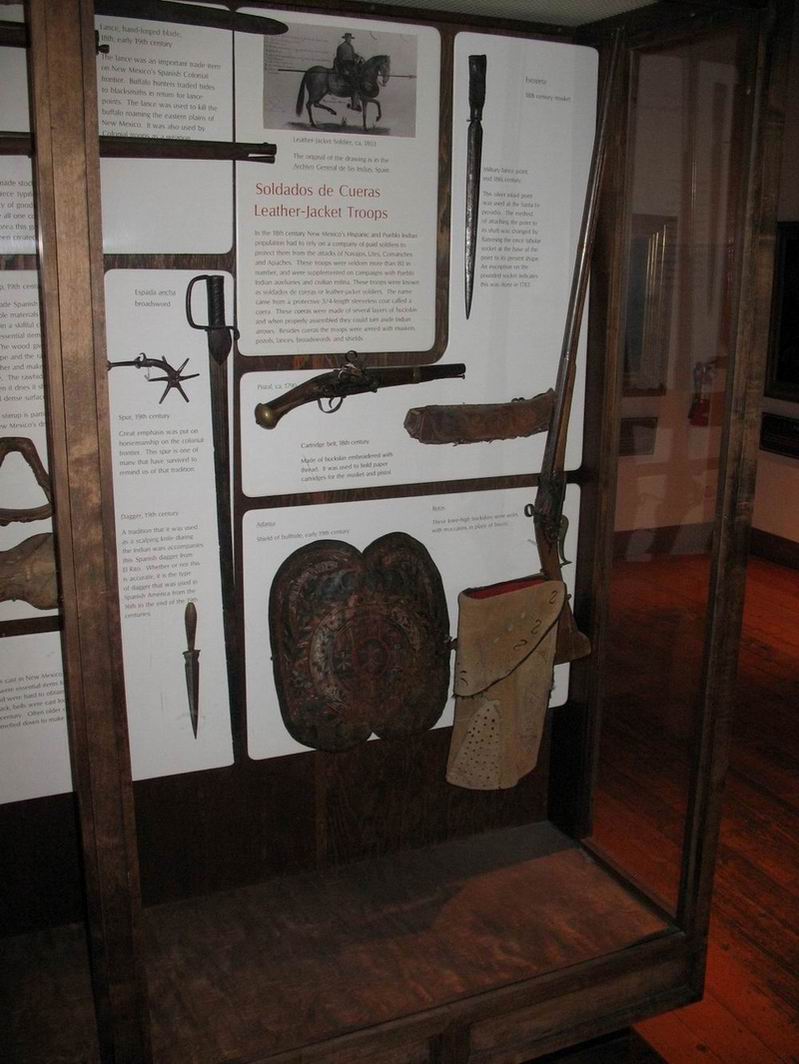

Here is a picture from the palace of Governors in Santa Fe, which shows a hide shield - adarga, and something next to it which I suppose might be one of those leg protectors.
Unfortunately, the museum did not have a specimen of the cuera leather jacket exhibited, as far as I recall. Maybe there is one in poor shape in the museum storage?

Thank you Teodor for posting this wonderful display at the Palace of the Governors in Santa Fe. I missed this when I was there due to a great deal of construction underway, and they clearly put together some wonderful pieces here.
The bocas and adarga are great, but I really dont believe they have the cuera. The espada ancha there was beautifully restored several years ago.

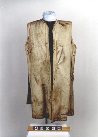

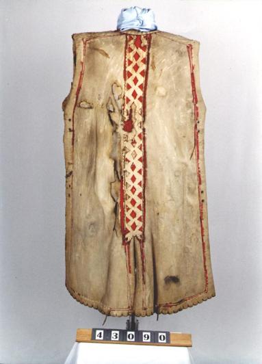

I have found that an outstanding example of cuerra is among the holdings at the Museo del Ejercito in Madrid, and it is noted that these typically carried more adornment, much of it lost from this 18th century item.
The photo is among material from the Texas historical group preserving this magnificent history, The Second Flying Company of Alamo de Parras.
18th Century 'cuerra' armour of the soldados de cuero:

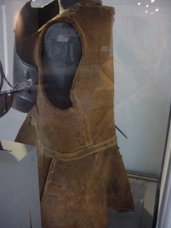

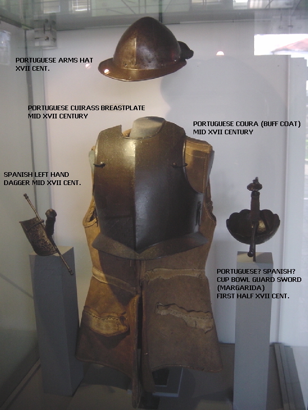

Hi Jim, can i assault this thread, now that the cuera theme in the appointed context has slowed down?
I assume we all know that this apparatus was previously more of a complementary armour element than an exterior attire.
At a certain period it was used to defend parts of the body and pad the upper part, in order to absorb the hardness of the steel cuirass.
The name in portuguese is coura; i realize however that this type of gear also had its momens of glory in various other countries, of course.
I know where there is one for sale (where else could it be? ); i just don't even ask for its price, afraid i couldn't reach it.
The example in the pictures is in the Oporto military museum.

Wow! Beautifully done Fernando. I really like the way you detail the photo with captioning, nice graphics and very helpful.
You're very right, leather or other material was indeed worn under armour not only to provide some buffer between the hard steel and its wearer, absorb heat, which must have been unbearable at times, and also to absorb the force of blows, which would sometimes generate blunt trauma with the armour itself.
* much like the non penetrating wounds received somewhat superficially under kevlar vests etc.
In the Middle Ages, this wearing of heavy material was common, and the heavy jerkins worn during the English Civil War also examples which also served somewhat like the cuerra.
The Spanish soldiers found leather much more manueverable in these incredibly rugged regions, and great defence against the hostile flora as well as the hostile Indian tribes' arrows. The bocas no doubt provided much needed protection against the bite of the ever present rattlesnake as well.

Where's that head-slapping smilie?
A buffcoat. Of course! Great call, Fernando!
