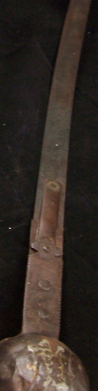

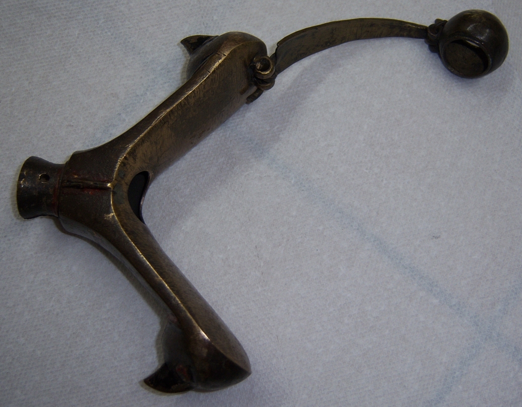

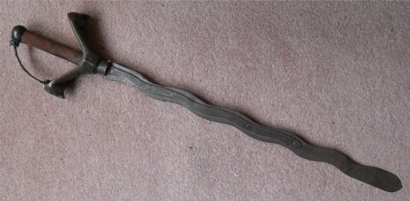

Recently ended on ebay, this sword is obviously a composite. When, and for use or resale, I have no idea. OAL 84 cm, hilt brass. But, I think the components themselves are of interest, and I was hoping for any observations anyone may have about either part (blade or handle).
Thanks!

Strange piece.....do I see wootz
Regards David
Old 17th July 2009, 10:34 PM   #3
Posts: 10,867
Very unusual! This seems to reflect the very early hilt form of the khanda, and obviously not a weapon in the true sense as well as clearly composite. It seems there are traces of red paint? Perhaps a votive temple item?
The nagan blade and interpretations of early actual weapon types would suggest something perhaps used processionally or ceremonially.

I find myself wondering (As Jim clearly has) about the rather chunky Khanda hilt.
What struck me is the fact that the pommel appears to be a 'ring' as does the 'slot' for the 'blade'.
I am wondering if this was the hilt from a Khanda hilted Gargaz (or similar mace weapon) as that would explain the circular mounting holes to accomodate the thin steel shaft.
I can try and find a picture of one if anyone wants?

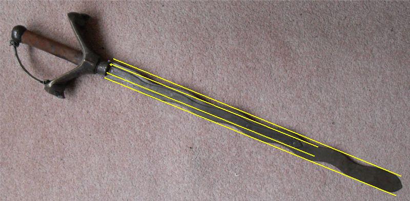

The curves of the blade suggests to me that they were formed by 'stock removal' .....ground out sections of, I think , a Khanda blade. The re-inforcing strip seems also to have had the same treatment.
If correct, the next question is Why ? Perhaps there was severe edge damage and grinding the curves removed the damaged sections and gave the blade a new lease of life. I still believe the blade to be wootz so saving the blade makes even more sense as I believe that if wootz was reworked using a forge and anvil, the wootz patterning would be destroyed.
I think Gene has the hilt question covered ie a mace 'hilt'
Disappointingly the overall assembly of the piece seems a little crude. It would be a real shame that this composite was a 'modern' creation and a good wootz blade was re-worked (butchered) into a Naga style to try and increase its value (they do seem to be popular, commanding high prices)

The thought had crossed my mind that the blade was originally a "normal" khanda, reworked in the nagan form. I guess my hope is that the curves in the blade seem to be reasonably well done (rather than the pointy types you see in for example later fillipino pieces). When I see the blade in person I'll know if there are ugly grind marks, whether it is sharp, etc. That will answer a lot of questions.
--Radleigh

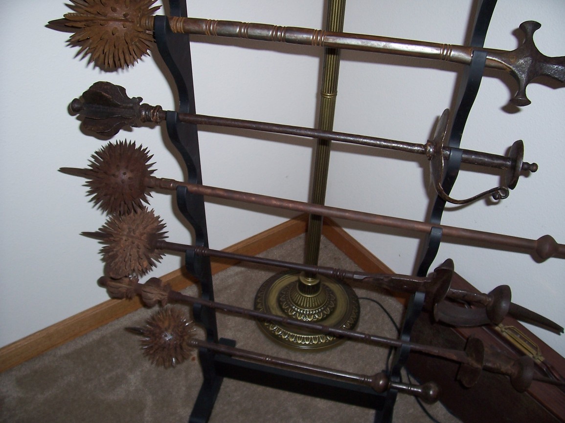

As for the mace, I thought I'd be able to find more than one picture! Sorry its not a lot of help, but you can see that the possibility is there:
Notice that the mace version doesn't have a back spike for the 'hand and a half' grip. That would also be fine with your 'ring' pommel.

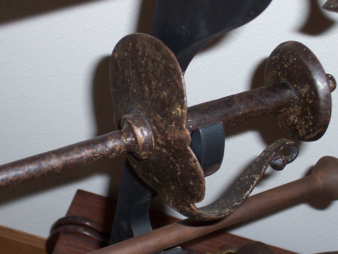

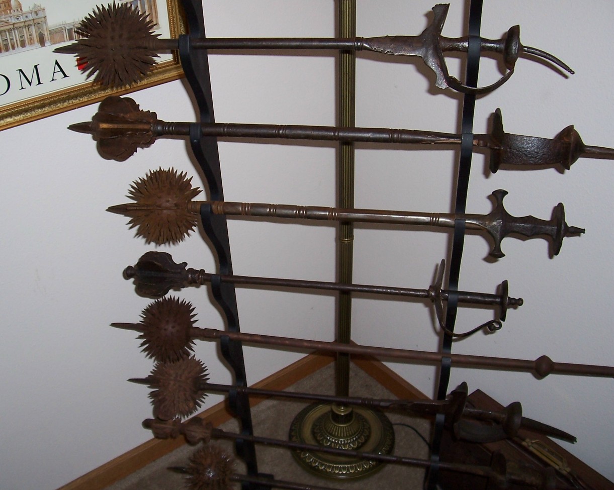

Here are several maces. Most are like one pictured where rod is flattened out and attached to khanda hilt.
One with early style hilt I have has the rod going through and no back spike.
trajan is offline   Reply With Quote

Actually the maces pictured are heavy combat worthy weapons of the 16th-18th centrury. I did not picture any of the more ceremonial types as most of them seem to have lighter construction and non-khanda hilts.
matt

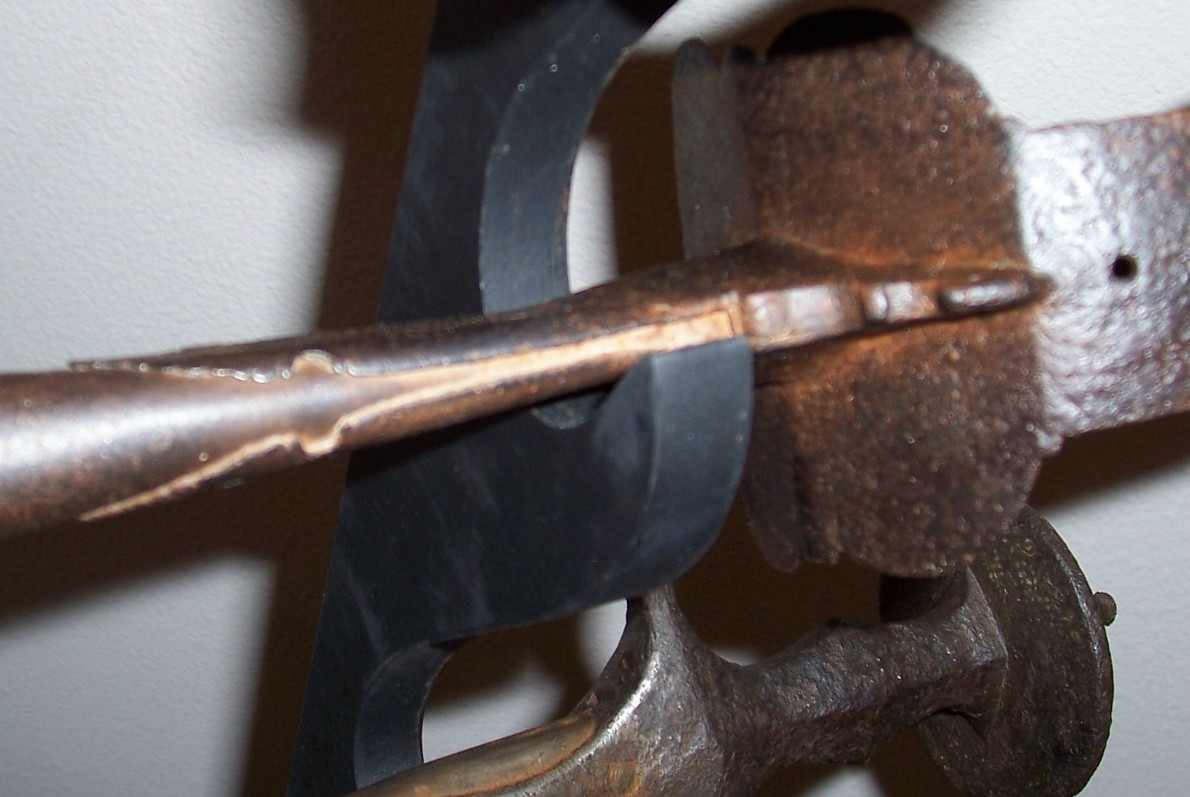

I would also note that the long extended bracing resembles that of the ceremonial or dance pata. Pata hilts that have had combat blades replaced with thin flexible ceremonial blades tend to have extra long bracing like this.
Matt

It could be for a mace type but it could also have held an ax or spear as there were khanda hilted pieces with circular openings with these weapons as well.
Here is a pic of a pata hilt with dance blade and added bracer.

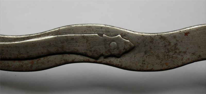

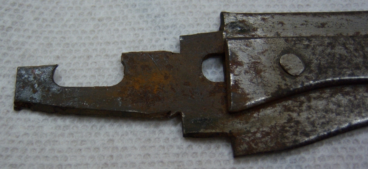

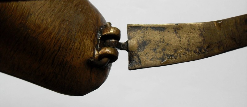

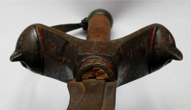

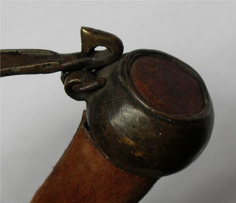

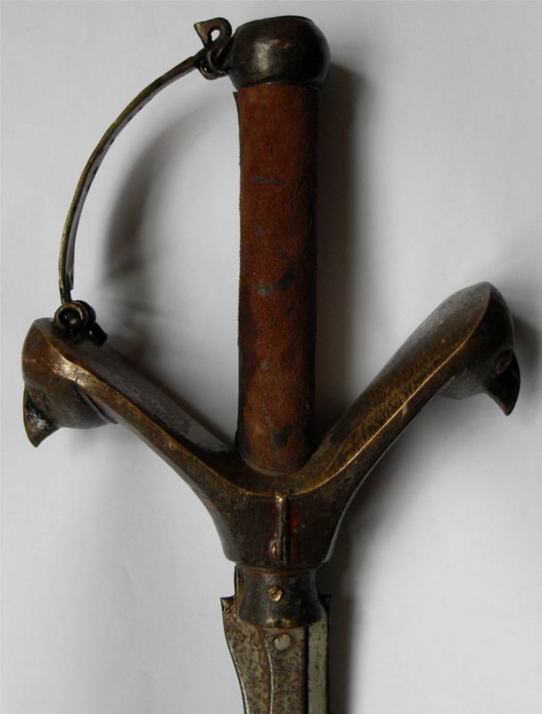

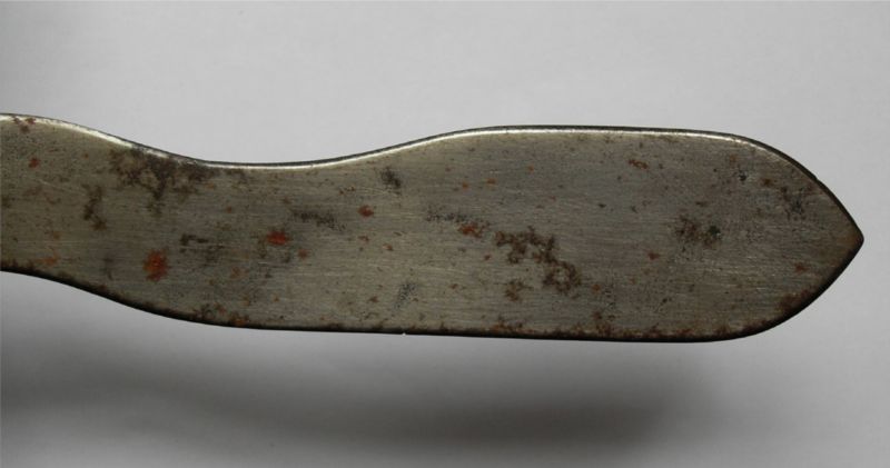

Arrived today; construction exceptionally shotty and probably done for resale. Handle part was a metal pipe, and the whole thing was held together with a single brass screw. Took 5 inutes to take apart.
Blade is probably NOT wootz but is a bit scratched so will have to be polished to be certain. Doubtful though. The tang has obviously been altered. Any thoughts as to the original handle form?
Now the handle itself is quite interesting. As already noted the appature is round, and of the same diameter as the pommel, which is open on top. One new observation is that the handle is hollow; I'm not sure what that indicates, except that it is lighter weight than one would expect. But I think the big question is concerning the hindged construction of the guard/pommel. I was able to pop off the pommel before removing any other parts because of the hinge at the top. Are there any other examples of such a construction? Off the top of my head, the only reason to make something like this is to make it "easy on easy off" which would imply that this hilt as designed to accommodate easy switching. Any thoughts on this?

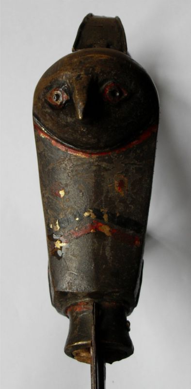

sorry to hear your disappointment about this piece . Any news on the blade etch ? The guard is very interesting, the bird head appears to be an owl ....
"In India, a white owl is considered a companion and vāhana (Vehicle of god/goddess) of Lakṣmī, the goddess of wealth, and therefore a harbinger of prosperity. The owl has been adapted as an emblem to reflect its implications of wisdom (Wise old owl) by a revered military institution in India known as the Defense Services Staff College. In colloquial use, however, it is commonly used to refer to stupidity. The Hindi word for owl, ulloo is used to refer to a foolish person...."
The Defense Services Staff College was created 1905 as the Army Staff college in Deolali (near Bombay) before partition.
Is it possible that the hilt is ceremonial ..perhaps for the Army Staff College..the knuclebow 'arrangement' looks too weak for combat. The hinges have little strength, but judging by the colour variation of the guard / knuclebow perhaps a later addition.

Here are my thoughts about the ’sword’.
The hilt is south Indian of a very old form, and the bird heads shown on the hand guard are parrots, a very beloved bird in south India. The blade does, of course, not belong to the hilt, but I don’t think it is a reworked khanda blade. Originally I believe the ‘blade’ must have been a rod, and not one to form a maze – so I believe it to have been a ‘sword’ for training.

Sorry for the long delay, but still have not polished the blade. As I said though, I'd be surprised if it came to anything.
