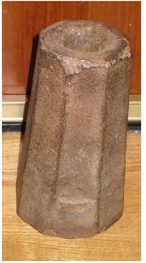

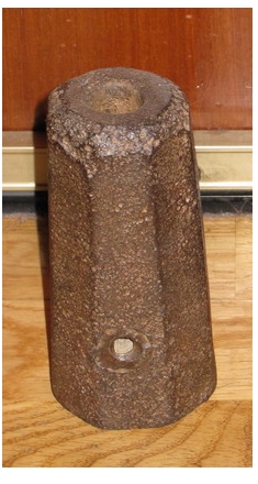

Hi guys,
These two are coming over early next week.
The smaller one has 14 cms length and a 20 mm caliber, and the larger one has 18 cms. length and a 30 mm caliber.
When they arrive, i will see if i can organize reasonable detail images.
I thought however that these provisional pictures i am showing here would be good enough for an opinnion on their 'appeal' and, if possible and as allways, a guess on their estimated age.
Would they still be from the XVI century?
Bitte ?
Fernando.

Hi Fernando,
I guess the Bitte was meant for me ...
It is really hard to discern but these do not seem very early to me: their conical shape with the broad and flat rear section would make them ideal for firing in an upright position.
Furthermore, the surface of the one on the right looks so smooth that it should be checked if it is possibly found iron.
While almost all these barrels kept their traditional Gothic form (octagonal or sometimes hexagonal) for hundreds of years I should attribute these two tentatively to the 18h or 19th century and call them noisemakers.
Again, it is very difficult to tell and I have to resort to a sort of feeling which should by no means impair your having fun with them, though!
Michael

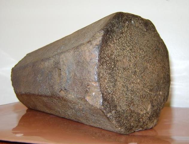

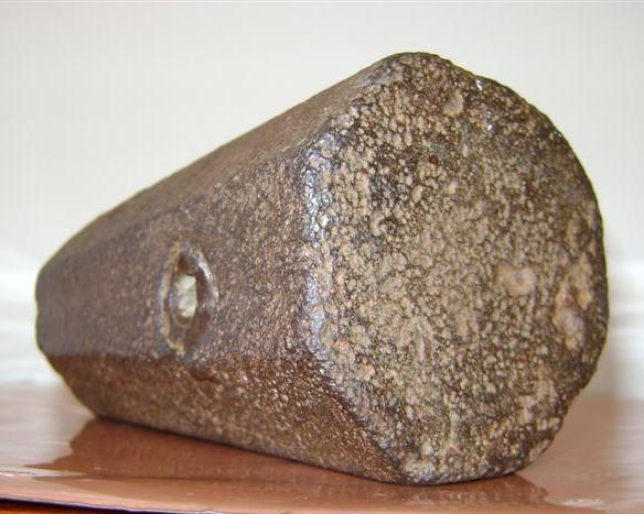

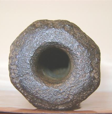

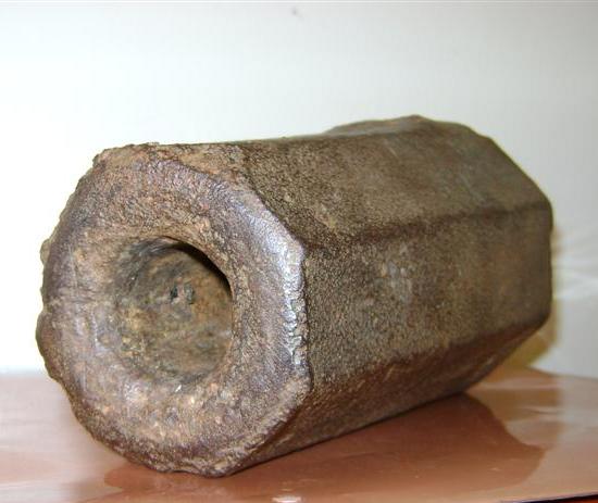

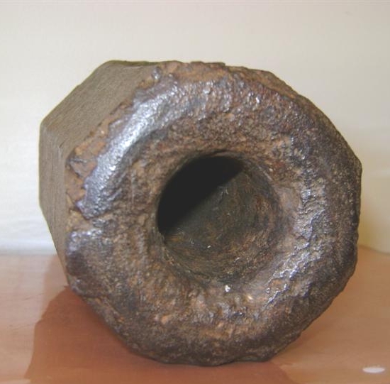

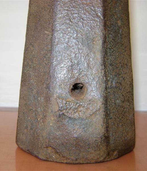

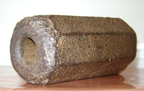

I have tried to take resasonable (?) detailed pictures.
Cast iron they are, of course Michael.
They even look to have come out from the same foundry, judging by their texture and also their relative design.
Their conical profile is rather pronounced, as may be seen in these new pictures, specially the large one.
Their walls are quite thick, their bases are even much more; the large one weighs 7,5 kg.
It could (should) be that they are signal mortars but, within my ignorance, with such walls and bases, they could well be (or serve) on a weapon scheme ... don't ask me which version .
Say Michael, after these lousy pictures, is that age attribution (XVIII century) a final diagnosis? .
Fernando.
Old 15th July 2009, 06:43 PM   #8

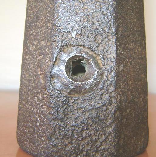

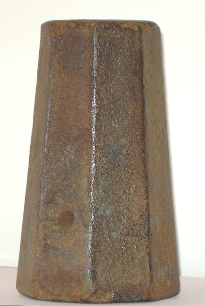

The large one

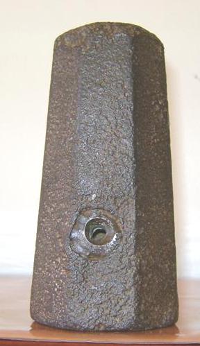

Old 15th July 2009, 06:45 PM   #9
The small one

Old 16th July 2009, 03:04 PM   #11
Matchlock
Matchlock's Avatar
Join Date: Sep 2008
Posts: 4,310
Fernando.
O sim, mi amigo,
18th/19th century, especially as they are fundido.
Btw, very good images!
The areas around the touch holes of both items seem to have been altered within their working life: while a former pan like moulding seems to have been removed from the larger one, the touch hole of the smaller barrel seems to have been burnt out and consequently reduced in diameter.
If I were you I would fill them up with powder, put a wooden plug in the muzzles and bang away using a slow match to make the sound ring out all over Portugal - if they have not burst so far they certainly won't now! Just imagine them jumping from the recoil!
Michael

Fernando and Michael,
I agree with the assessment that these interesting things were intended as celebratory noisemakers and not weapons. Look at the larger one, there is a crescent shaped protrusion below the touchhole that looks like a protruding priming pan was broken off. On the smaller one, this is not visible but as has been remarked above, the touchhole has been "bushed" or lined so who knows what was there originally. (or, could what looks like a bushing or liner be the remains of a projecting priming pan which has also been broken off?).
Shooting these with blank charges would be fun! Fernando, just think how you could enliven your local festas with a few shots as the cortejo with all the flags, saints, and candlesticks marches past your house! You know that in the Azores, fireworks are a big thing; one of the biggest producer of fireworks shows for holidays here in California is an Azorean immigrant named de Souza. When I was still in university, in Hawaii, my friends and I had a small brass cannon (from Mexico) whose bore was just big enough to shoot a frankfurter sausage from. On New Years Eve we'd shoot sausages at neighbors houses and cars. Once we tried frozen sausages but decided it was too dangerous.
Now for the cold water -- old metal, especially cast iron, can be brittle and there is always the danger of bursting. I knew this Navy officer who collected lantakas, the Malay bronze swivel cannons. He liked to shoot a couple of his on New Years as well, until one exploded with a blank charge. It fragmented into three sections, one of which flew over his house. His wife laid down the law, no more shooting if he wanted to keep his collection...
