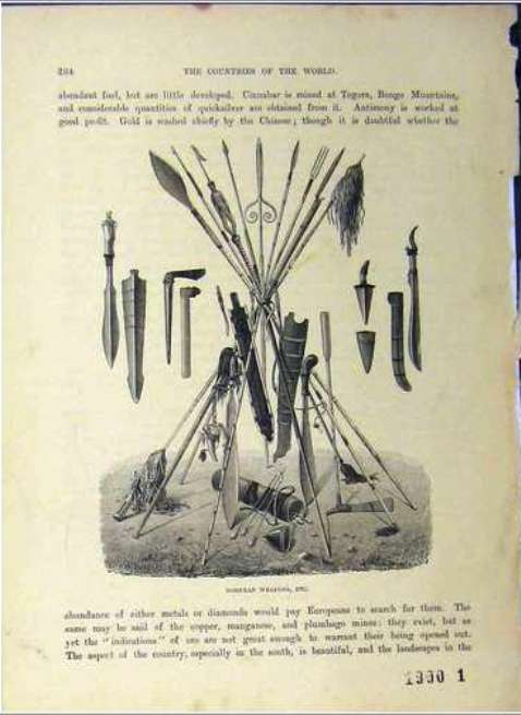

I wondered whether any of our SEA weapons experts may be able to help me. Fernando has a thread regarding a Spanish Breastplate which appears to have been damaged by a trident-like weapon (my suggestion.....so probably 'way of base')
Trawling the net I discovered this illustration dated 'circa 1850' and entitled 'Bornean Weapons', which shows a three pronged spear. Bearing in mind the Spanish were in Borneo at the time that Fernando's Breast plate has been dated, there is a possibility that such a weapon could have been used against Spanish armour.
I suspect that the three pronged spear was also around in Borneo in the 17th / 18th Century.....was this the case? Would such a spear have the ability to pierce armour ?

The pictured piece does look like a fishing spear to me (simlar examples can be found all over the archipelago).
Trisula were known mounted on poles (decorated examples usually for ceremonial functions) and apparently also utilized with a short hilt as stabbing/parrying weapons. However, trisula always seem to have much more of a distance between the prongs than those marks on Fernando's armour.

Thank you Kai ,
I am grateful for your reply... you have re-inforced what I have found out in my research.
