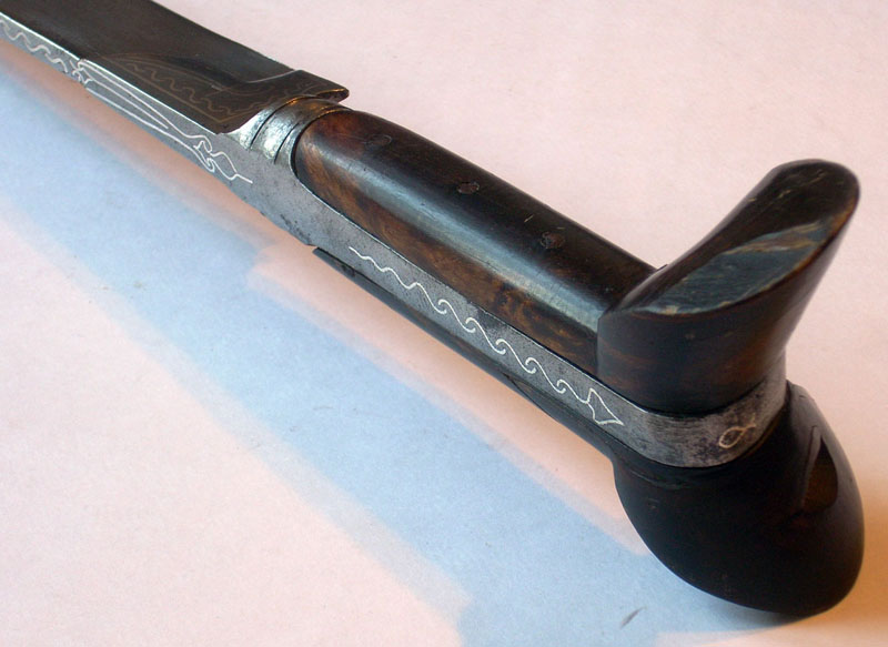

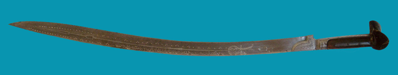

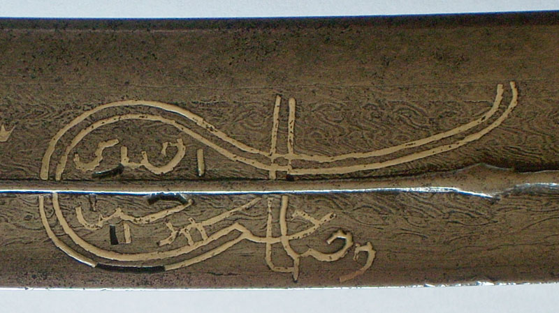

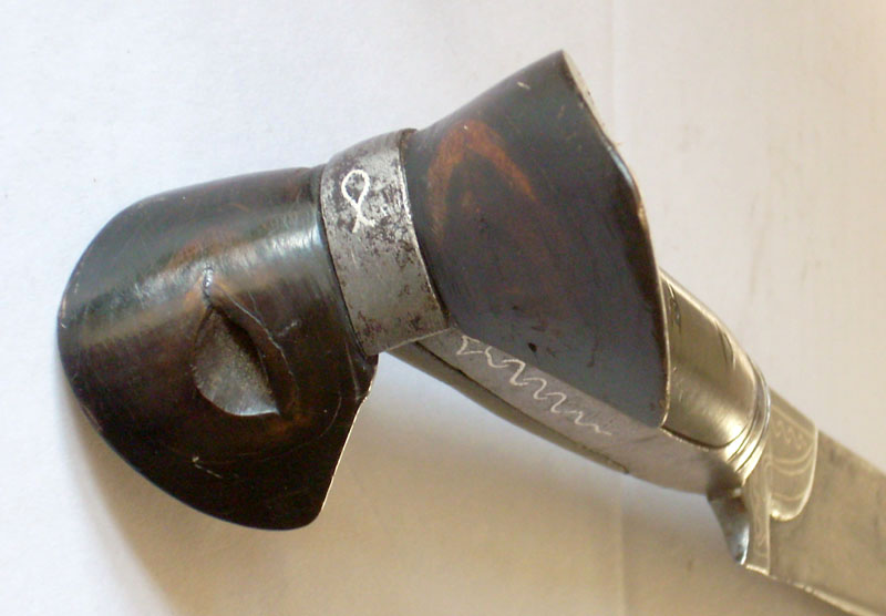

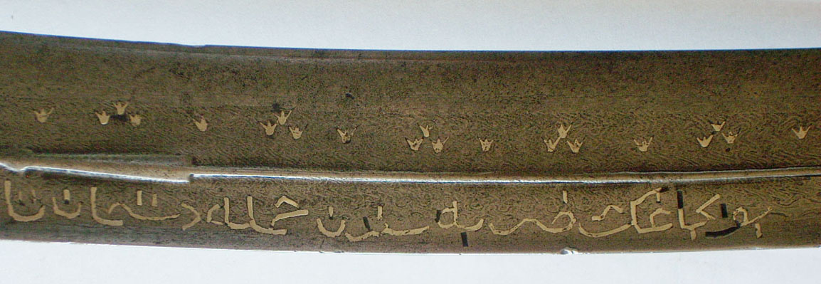

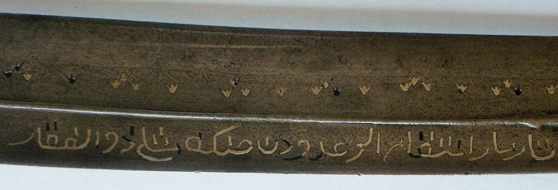

Here is a large and pretty heavy Yataghan from West Anatoly. It has deeply etched pattern welded blade, decorated with silver true inlay and 3D arrows. And it has a fish inlay which looks like a Christian symbol on the top of the handle bolster. It is interesting, what the inscriptions on the blade say. Maybe somebody (Dom :-)?) can help with the translation? I will appreciate any comments :-)

Tatyana Dianova
Posts: 792
The long inscription (right part)
Tatyana Dianova is online now   Reply With Quote

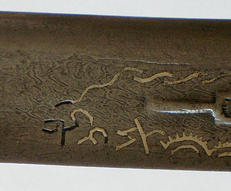

Old 26th May 2009, 02:07 PM   #3
Tatyana Dianova
Posts: 792
The long inscription (left part)

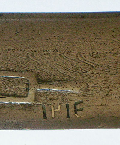

Old 26th May 2009, 02:08 PM   #4
Tatyana Dianova
Posts: 792

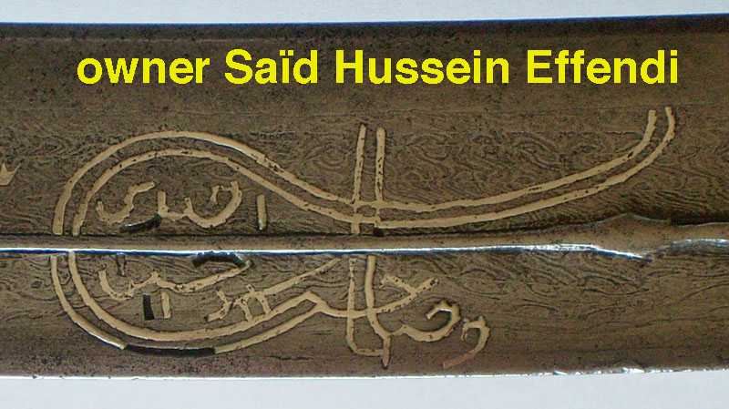

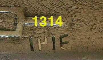

Other inscriptions:

Hi Tatyana
Its a very attractive sword! The decoration is unusual, and rather interesting. I love the circular patterns. Do you recognise any f the other symbols as Christian? I would have thought that in conjunction with the 'Ichthus' there would be other overt symbols such as the Chi-Rho?
Could the hilt symbol be part of a larger from that has been partly erased?
I've never seen the Christian Fish on a sword before.
I'll be watching the thread with interest to see if anyone can decipher the inscriptions!

Hi,
I think this one is a date, Islamic 1214 = 1799/1800. Will be interesting to see what the rest translates as, nice sword. The other one, Alpha?
Norman.

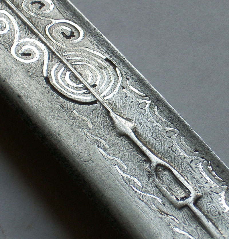

Interesting yataghan!
While awaiting the linguists interpretations of the inscriptions, the symbolism is always of interest to me.
We are of course all well aware of the fish symbolism in Christianity.
This blade is rich in geometric symbolism, and the raised devices on the blade seem to resemble geometric apotropaics somewhat, thinking again of the aghrab on Arabian scabbards, although the design here is not quite the same.
The fish was also symbolically a folk religion talisman in North Africa, from Tunis to the Sudan, and probably much wider, certainly in the Ottoman realm.
The concentric circles resemble ancient motifs in shamanic and folk religion symbolism with wide ranging interpretations, but often seen on rock art and other early artwork.
Naturally it is dangerous to assume whether symbolics in any material culture is applied as deliberate symbolism or whether simply adopted as space filling motif, but it is always interesting to consider the possibilities.
Old 26th May 2009, 11:40 PM   #8
Posts: 7,407
I have also seen this form as not a fish but used in Islamic art as a floral motif, ie. Moro okir.

Hi my Friends ....
where did you got that sword could be Christian
when you'll discovered the owner name, sure he never got a baptem sacrement
more surely, been a good "Hadj" ... LOL
the date also, I am not formal, still yet the risk of error between 2 and 3
as I already explained
the owner name, the title (not an high ranked Gouvernemental employee), and the forma, are very turkish

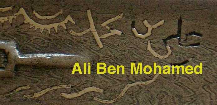

translation; "Owner Saïd Hussein Effendi"
the long sentence it's again a poem glorifying swords in general and "Zulfikar" in particular (double blade sword)
nice stamp and clear sign for the "blacksmith"
Ali Ben Mohamed
by the way, ... your (!) fish, could looks also the "Nile key"
otherwise, beautiful yatagan
à +
Dom

I would like to thank everybody for the comments and especially Dom for his observations and translations!
Jim, Battara and Dom, I also had my doubts concerning the Christian meaning of the fish, that’s why I’ve written ‘Christian’ in the title. But it is simply the first thought that crosses one’s mind when seeing it. And I thought that maybe the Yataghan belonged to a person, who was a hidden Christian…
Dom, do you think that this level of quality still existed on the turn of 20th century? VERY similar blades one may see in Astvazaturian’s book on Turkish Arms, page 153, and all of them date to the very limited period of 1800-1810…
