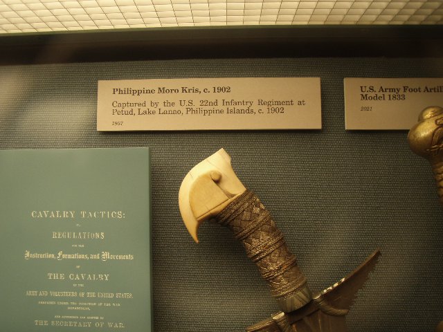

Posts: 1,042
Nice krisses! especially no. 1.
The style of the braiding and silverwork of no. 1 look very similar to the capture piece displayed at the US Military Academy's West Point Museum ...

Thanks for comments and the pic of west point museum.
