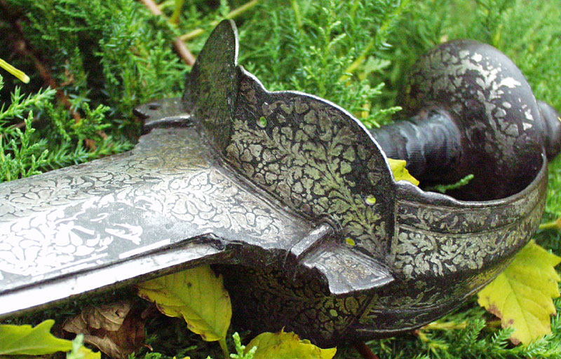

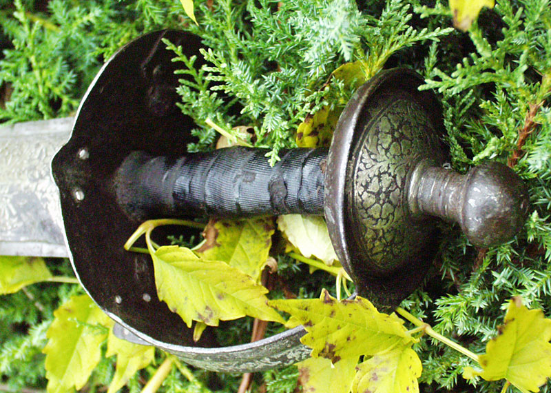

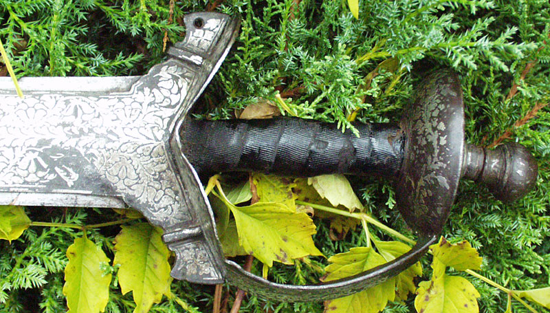

hi all,
can someone tell me something more over the reason from gild ore brass filled wholes at indian swords. at my last khanda sword i found such an filled whole and today i looked at the web site from oriental arms and there is also an khanda with exactly the same sign.( you can see also such brass dots at the cover from eggertons book at an khandablade) i know there are in the past time some discussions over the reson from wholes in the blade if it is an talismanic sign ore an indicat for the quality from the blade. there are also the opinion if it is only an filled ( nail) whole. i donīt believe that it is an whole from an nail what was only fille dwith brass ore an other soft metall. i hope some one from the forum members know more over these things.

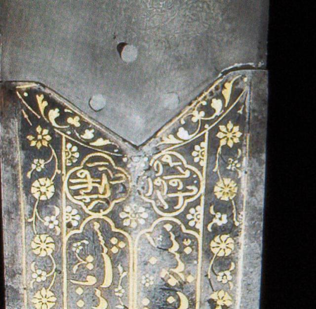

It is hard to imagine any type of inlay or deliberate mark or feature not having some symbolic meaning on an Indian weapon when a simple dot such as this rather than decorative theme. It seemed the best resource would be "Hindu Arms & Ritual" by Elgood, and found this concerning wootz and laminanted core blades; "...lines running along the back of the blade are sometimes visible, marking the junction of the metal billets" (p.202).
Clearly this is not the case here, however it suggests the importance of inlaid metals which "...highlight areas of significance" (op.cit.p.196)
There is discussion of the inlaid gold umbrella signifying kingship, another example of the importance of inlaid metal.
It seems that in China, there were inlaid dots representing the seven stars on a number of blades. In Borneo, the 'mandau' often has holes drilled out and are filled in with brass if I recall correctly. I believe that led to the popular theory of a tally for heads taken or to that effect.
I would consider that the filled holes were intended to either signify the quality of the blade as suggested with filled lines noted above or possibly auspicious placement of metal to offset negative implications of iron in Hindu theology.

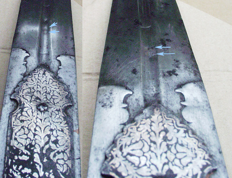

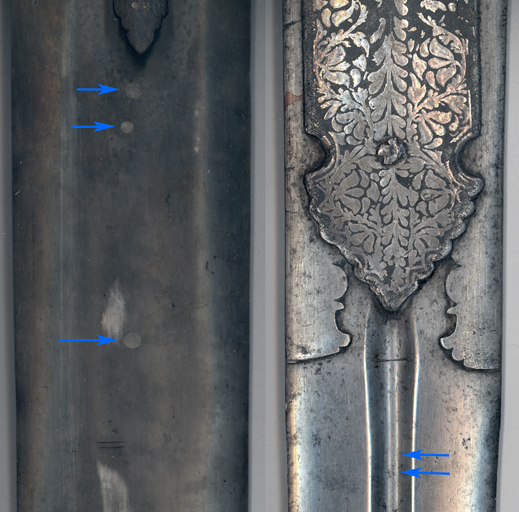

I have noticed these holes in a number of Indian blades, usually broad straight blades in Hindu-style basket hilts (which have no tang, being secured by plates over the forte of the blade). The holes are often filled with inconspicuous iron and I have found that they are often in a position suggesting that the blade has been remounted and that these are a residual artifact of the rivet which had secured the replaced mount. Sometimes there are two or more such defects and they are often close and or irregularly spaced. Some of these blades have appeared to be of an age that likely would have known multiple sets of mounts, while in others I have had the suspicion the filled hole came with a new sword in imitation of older blades or to suggest it was an heirloom.
