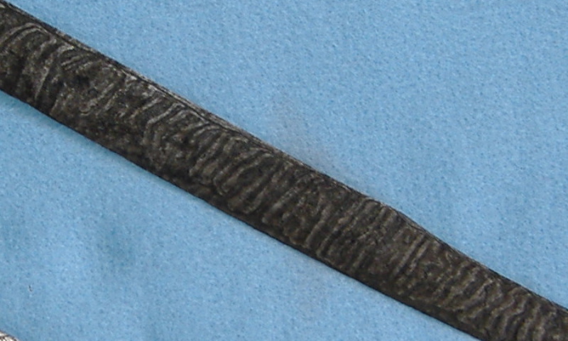

On the pamor maybe you could attach a close up?

The blade close-up is attached. You can also easily see where the false edge begins.

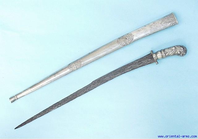

Could the pamor be Lawe Setukel (or is it a variation of Buntel Mayit)?
I think your pedang is related to this one http://www.oriental-arms.com/photos.php?id=1217 [I couldn't find my own pictures of it]

The picture from Oriental Arms is a good representation of a typical pedang suduk.
The pamor can be classified as "pandan iris". This is from Haryono Haryoguritno, who is the most respected recently published authority. I could give it another half dozen names, but rather than muddy the water, it is perhaps best to stay with the authority currently in vogue.
This pamor is a stack of small slices of contrasting material.Pamor lawe setukal winds back and forth across the blade; pamor buntel mayat winds around the blade and is angled. ( please note:- mayat meaning sloping or slanted, which perfectly describes the pamor, not mayit, meaning "corpse".)
