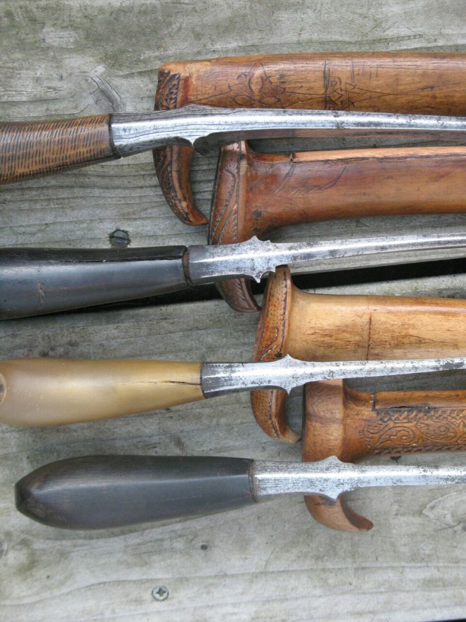

Old 24th April 2008, 04:26 PM   #9
asomotif
asomotif's Avatar
Join Date: Nov 2006
Posts: 2,238
Yes some age and corrosion is good to to see the lamination.
some more examples/ Old blades. Top and bottom with clear lamination.

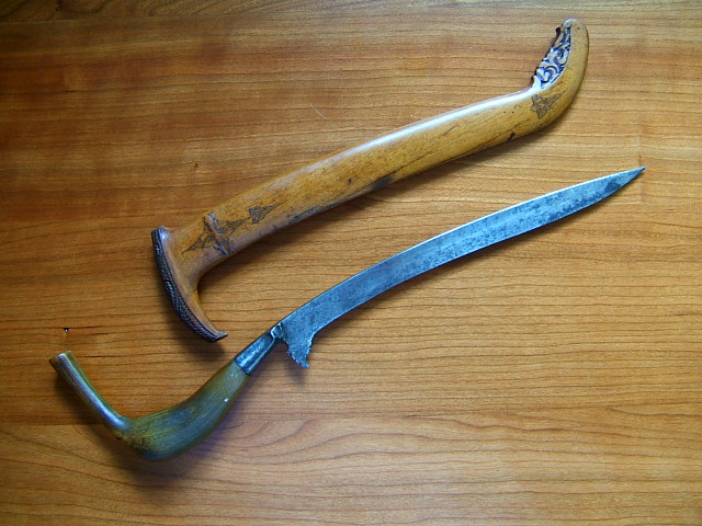

Old 25th April 2008, 08:45 AM   #10
here's mine with green horn grip and scabbard. it's interesting how the internal blade cut out is made from one side & covered by a narrow strip of horn held by the copper bands.

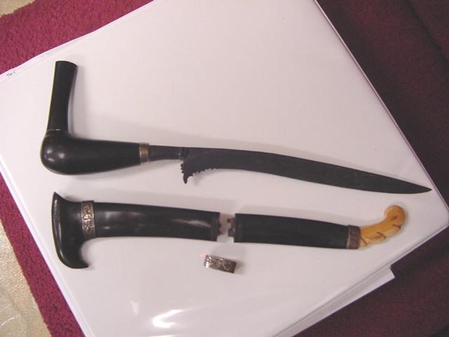

Default How do they do that?
I accidentally dropped this and apparently the bands conceal the joints used in hollowing the sheaths out. Is this horn or a corral material? How can you tell the differences?
Steve

Steve,
Your rencong is quite uncommon.
Most scabbards are from 1 solid piece of wood, indeed hollowed from the back side which is than covered with a strip of wood again.
In some cases so tight that I wondered if there was a strip.
Than I have now one rencong with a scabbard made out of one piece, and also 1 with a scabbard made out of 2 separates sides (left and right)
Buffalo horn scabbards are rare, but IMO more recent and/or made for 'tourist' rencongs.
I have seen a few Hulu dandan rencongs with scabbard mouths made of ivory.
So far my observations.
