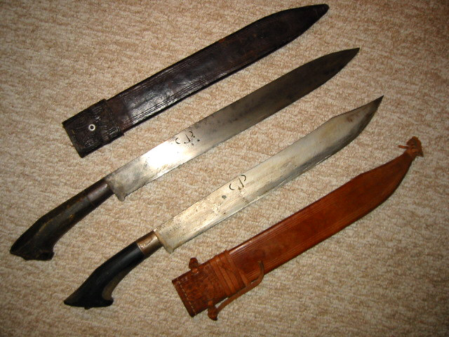

Old 31st July 2007, 11:03 PM   #8
Lew
Lew's Avatar
Location: East Coast USA
Posts: 3,191
These are two of mine and I consider them working bolos the one on top is similar to yours.
Lew
