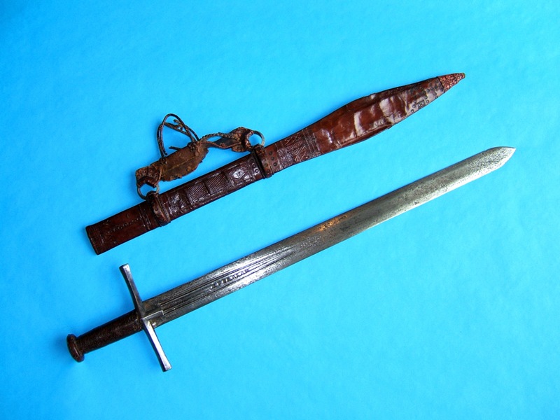

Your sword blade is German it is a dead ringer for the trade blades that I have seen on kaskaras plus didn't the Austrians control or influence Mexico's government for many years. Below is a portrait of Maximilian.

Old 20th October 2006, 05:39 AM   #12
Lew
Lew's Avatar
Location: East Coast USA
Posts: 3,191
Matt
I was able to resize my pic of this sword. The blade was cut down to about 23".
Lew
