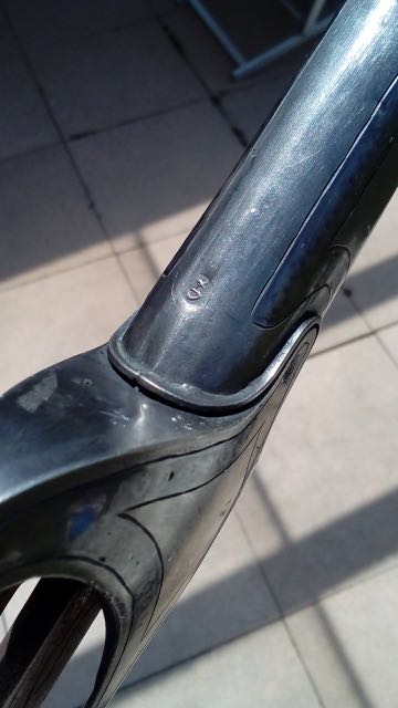

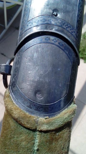

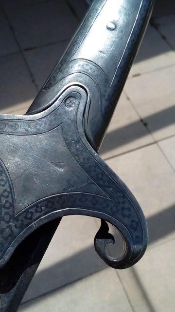

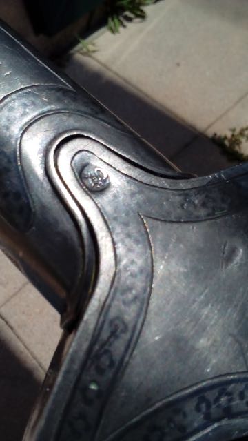

I post these pictures for have an advice about the hallmarks/tughras on the mounts of an oriental sword with european blade ( other post ).
Are they turkish ? Silver hallmarks ?
Can someone date it ?
Thank you !

Hi,
Yes they are.
Look at this page:
http://www.oriental-arms.com/item.php?id=3673
You have also the Passau wolf on your blade.
I'm very jealous it's a very good sword!!
20th c. are you joking?
I would say 18 or 19 th c.
Jim will tell you...

Hello Kubur,
Really thank's a lot for your precious comments !
For the turkish marks/tughras I was not sure, the auction company sold it for a 20th century sword... I found it strange because the scabbard too seems old.. !!
I knew the blade was old but didn't know about origin,
so Big Thanks with the Passau Wolf I didn't know ! It's really interesting !
I find this on internet
Kind Regards
Frankie

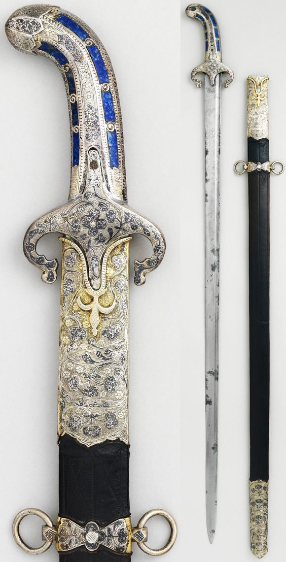

Ottoman (Othmanli) I think close to this form ..
And just who decided this was Ottoman and not Persian...the MET!!! Ha, they have been wrong so many times, what elements say Ottoman? Do any point to Persia??

Hello, museum and auctions specialists sometimes go wrong. This one I think its ottoman,
if you look the thread named "turkish straight sword with european blade", a lot of interesting comments came out about hilt shape origin ( and straight blades too ).
I made this new one for comments about the hallmarks/tughras when I received the sword and. "Zoom" the pictures...

The sword shown from the Met has multiple early Ottoman features including the bow-tie shaped scabbard fitting, the fine detailed niello scrollwork, and the detailed floral shape where the crossguard inserts into the top fitting.
While I've seen that last feature on Persian shamshirs, the feature is itself more indicative of Ottoman influence on Persian arms than vice versa.

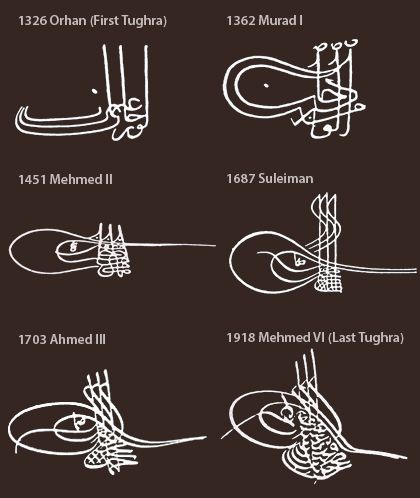

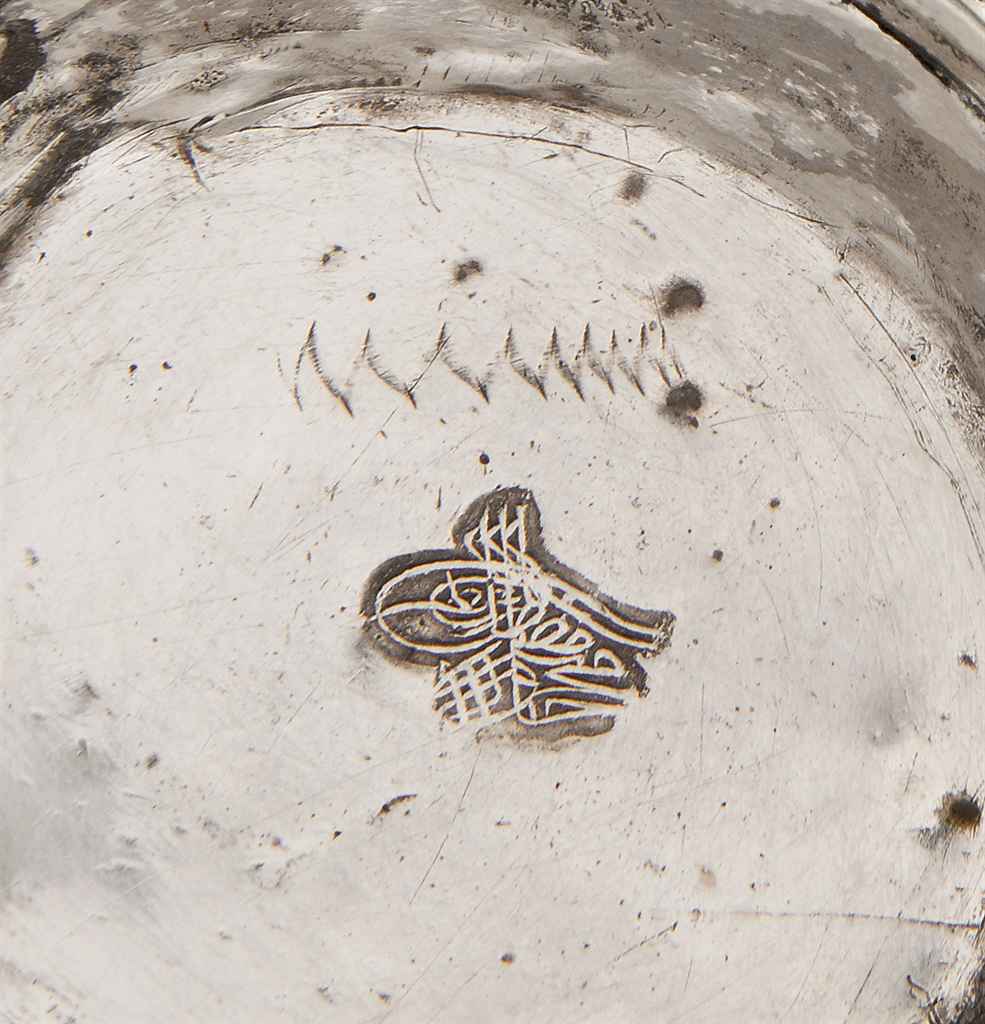

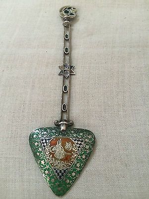

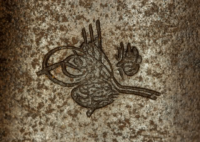

TUGHRA OCCUR ON MANY OBJECTS NOT ONLY DOCUMENTS...SEE
https://www.google.com/search?q=OTTO...yFHJokVc_CX4M:
and below on a silver sprinkler, a spoon, a coin and some sword blades.
Also illustrated are some of the Tughra on a page showing which Sultan they belonged to.

Old 2nd May 2024, 02:54 PM   #17
Apostolos
Join Date: Feb 2013
Posts: 5
Default Not Turkish at all
Originally Posted by francantolin View Post
Thank you Ibrahiim !
I kwew the two last tughras,
I can't recognize mine,
Maybe they "only" are marks from a region or a iron/silver worker.
It's a typically Caucasian silver work and bears the maker's mark.
Apostolos is offline   Reply With Quote
Old 2nd May 2024, 03:37 PM   #18
Apostolos
Join Date: Feb 2013
Posts: 5
Default Not an Ottoman/Turkish at all.
It's a typical Caucasian silver work bearing the silver master's mark.
Old 18th August 2024, 05:58 PM   #19
serdar
serdar's Avatar
Join Date: Feb 2023
Posts: 251
Those marks are smiths marks, and that sword is a later 19 century at best, that blade is not a real passau blade, it is a fake passau probably made in east, wolf is wrongly put in line with text, and on real it is not in line but 180•
Alsso text, style and dxdcution is wrong.
serdar is offline   Reply With Quote
