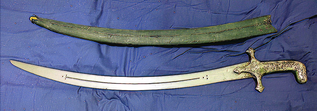

I have a similar short, 24 in. blade, NW Indian or AFghan shamshir with a plain all steel grip:
