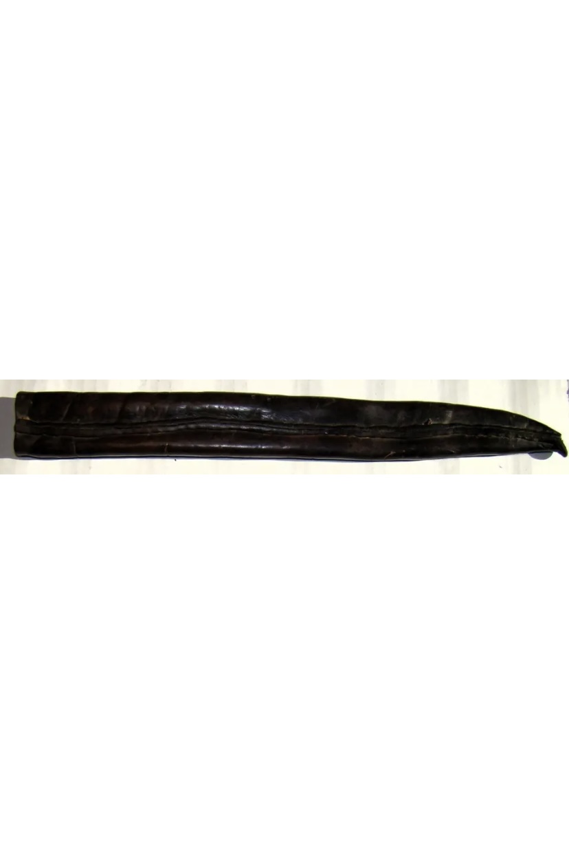

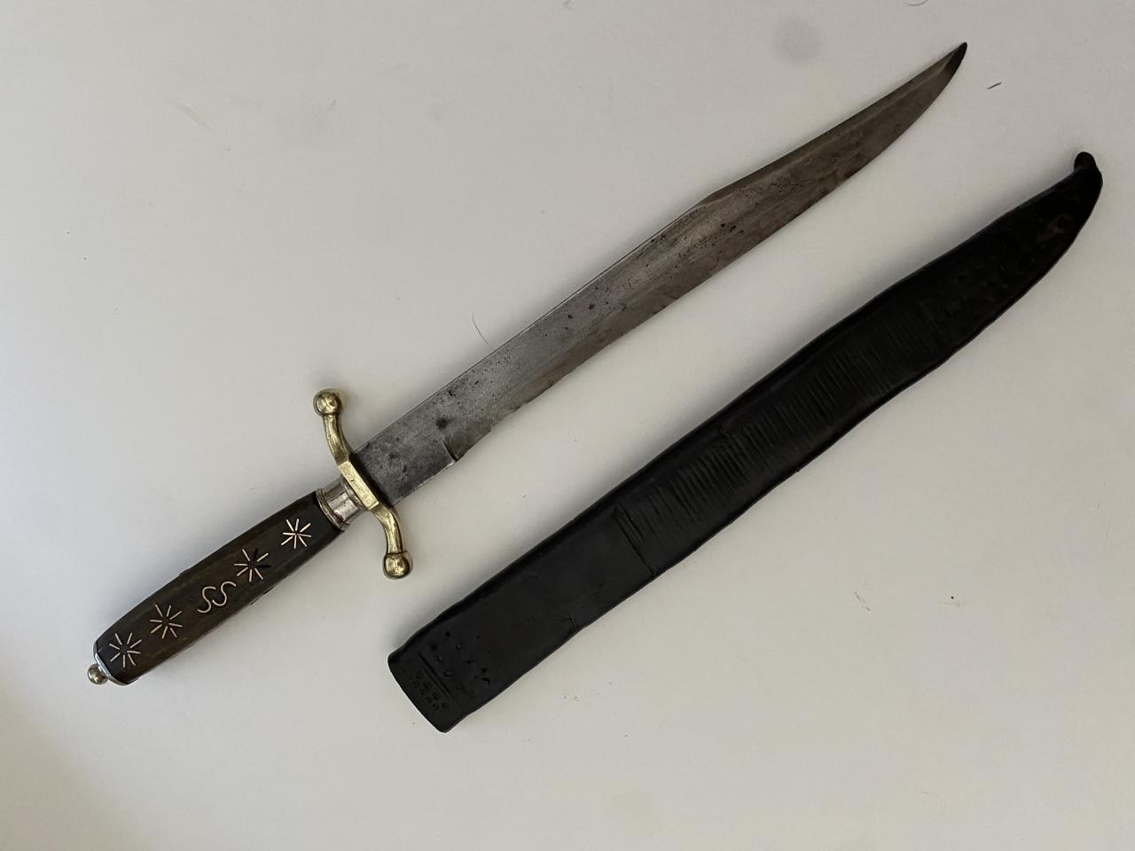

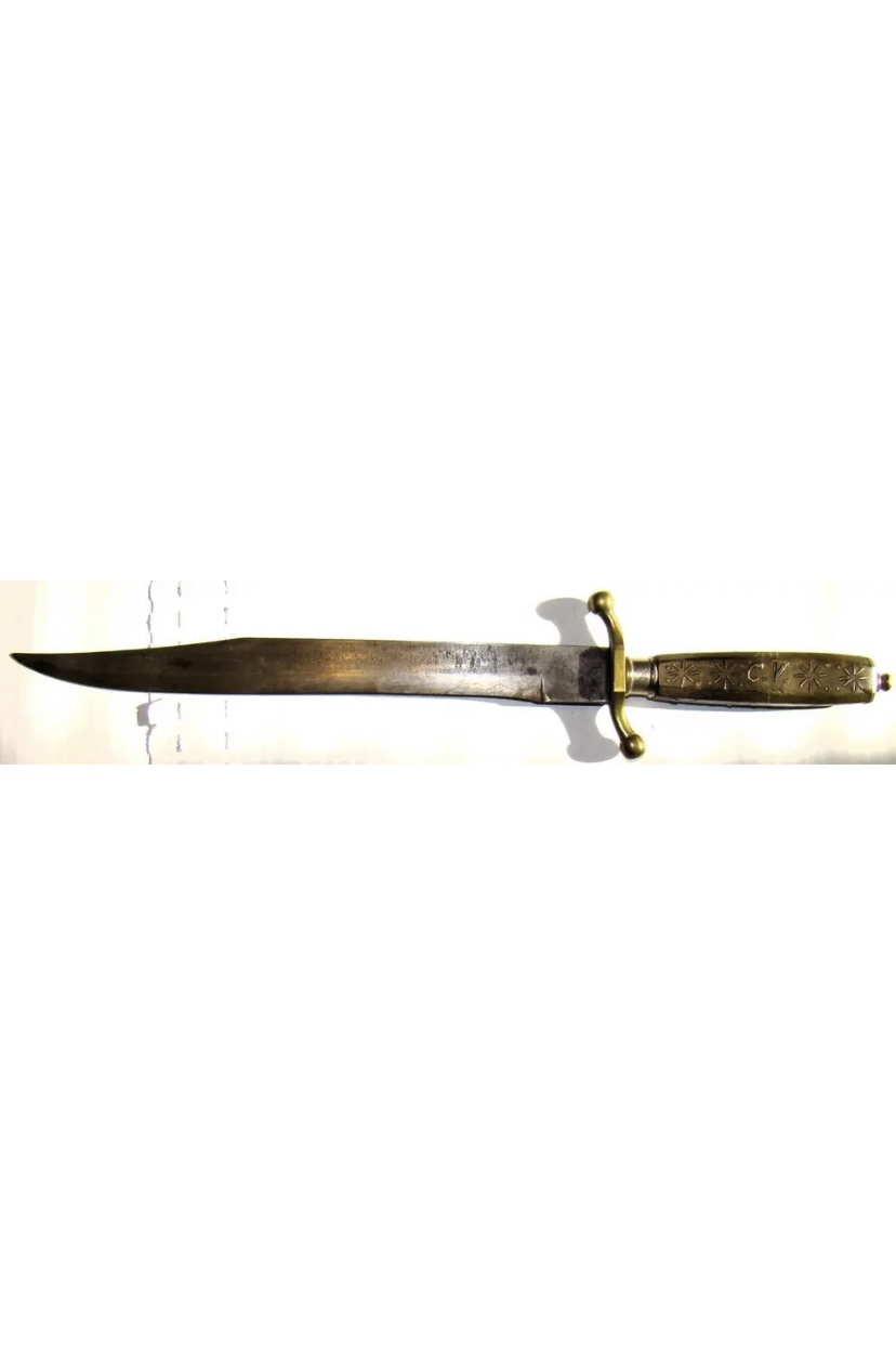

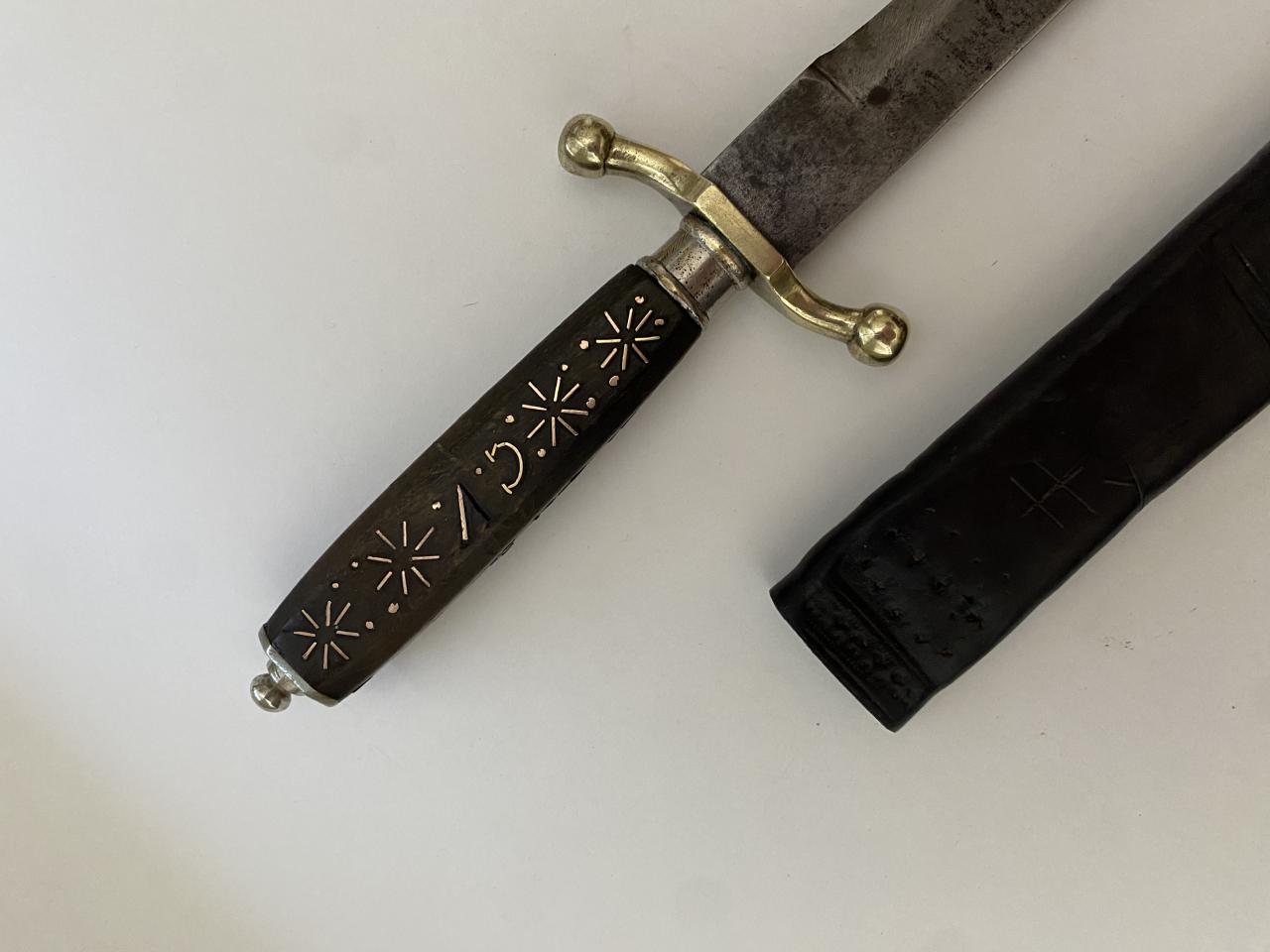

Wondering if anyone can confirm my assumption this is 19th century Latin American? I don’t have much experience with that region. Certainly looks like a Spanish Colonial sheath, I’ve ruled out Philippines but could be wrong. Maybe the characteristics ring a bell?
Blade 24 cm
OAL 37 cm

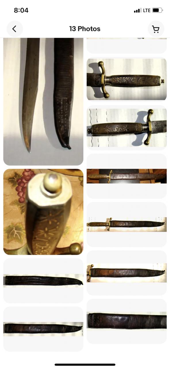

Seller photos, will update once received
(Please move if I’ve posted this in the wrong thread)

Old 30th June 2023, 12:36 AM   #4
wildwolberine
wildwolberine's Avatar
Join Date: May 2023
Location: San Antonio
Posts: 153

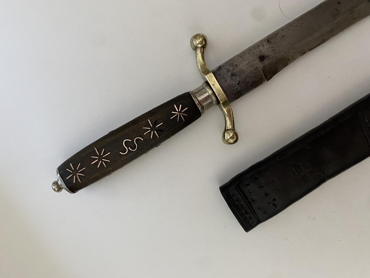

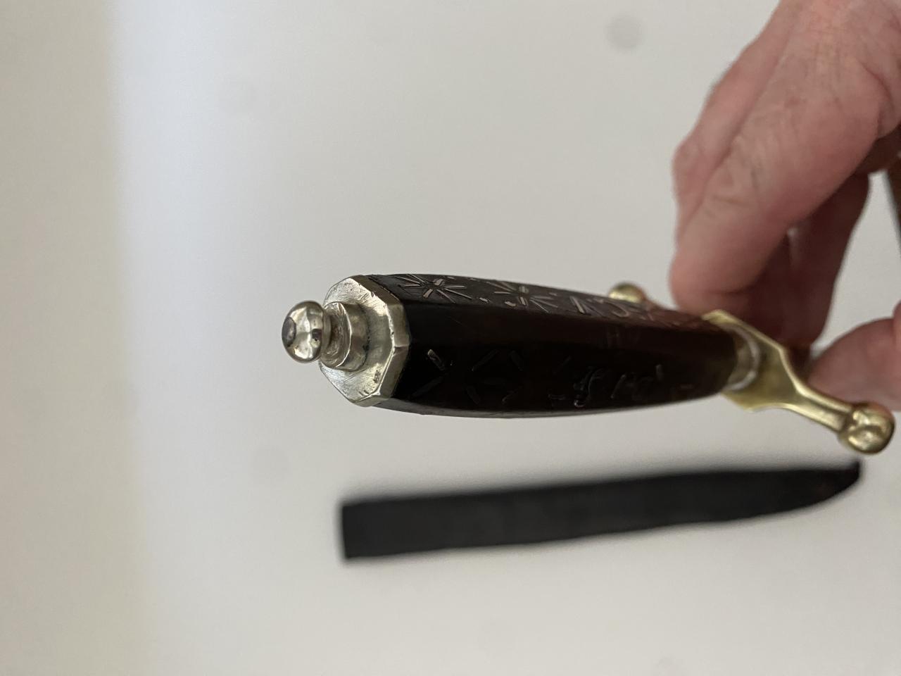

Here’s the knife, cleaned up a bit. There’s a name on the underside of the hilt that wasn’t in the seller photos - a nice surprise! The fittings cleaned up nicely, and the wood looks better after a treatment with linseed oil.

I don't see any features on this knife or sheath that are inconsistent with the Philippines. The "squared guard" that M ELEY pointed out is not uncommonly found in Philippine daggers. I also note that the general shape and the slightly kopis edge is also commonly found on the so called "Philippine bowies". That "Del Sr" signature you show could actually be an abbreviation for Del Sur which refers to Illocos Del Sur in the Philippines which is a main manufacture site for Philippine bowies.

I am with Rob here, I haven't seen so far daggers from the Philippines with a screw. And I also think that "Del Sr" means Illocos Del Sur.

Del Sr which I think means "From Mr"... relying on Google translate there, and RobT notes, "Del Sr." would just translate as "of the senior" ... if anyone can offer more insight on the linguistics or possible twists I am interested to learn more.

The grip shape and the way the pommel cap covers the edges, along with the turned waisted collar do have a PI flavour to them.
But equally, the grip shape is not unique to the PI region either (shrug icon inserted)
