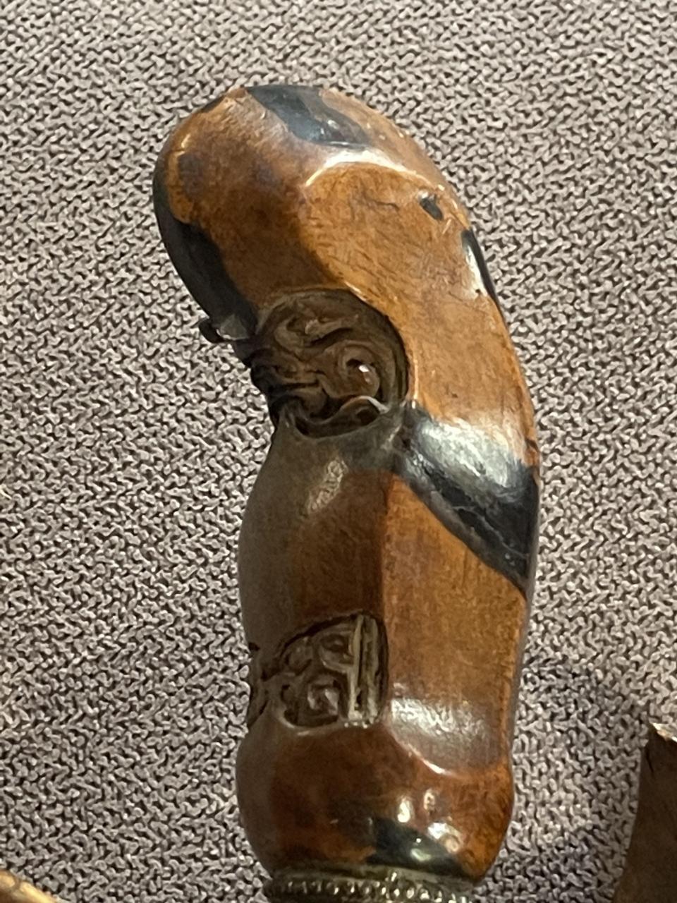

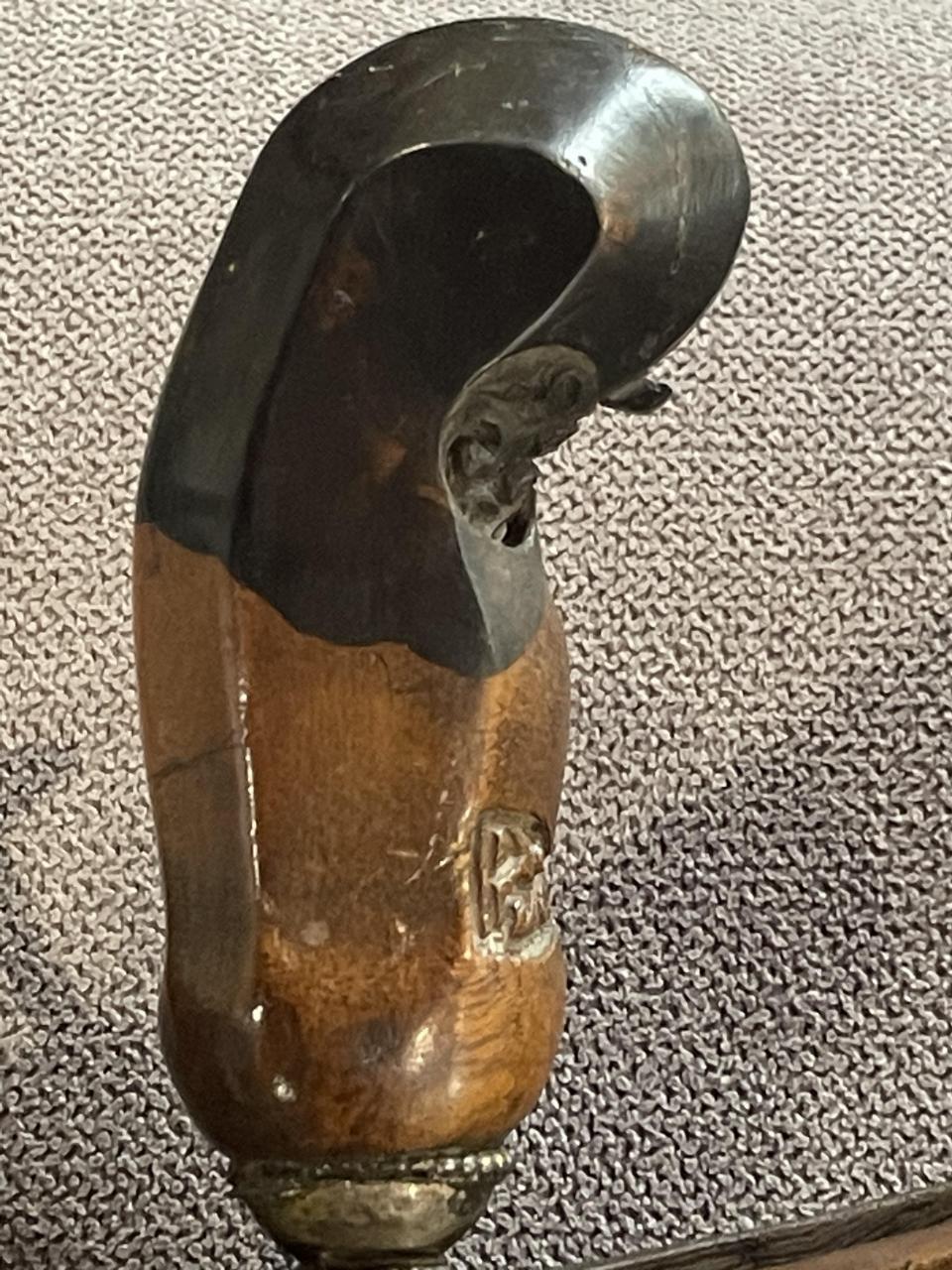

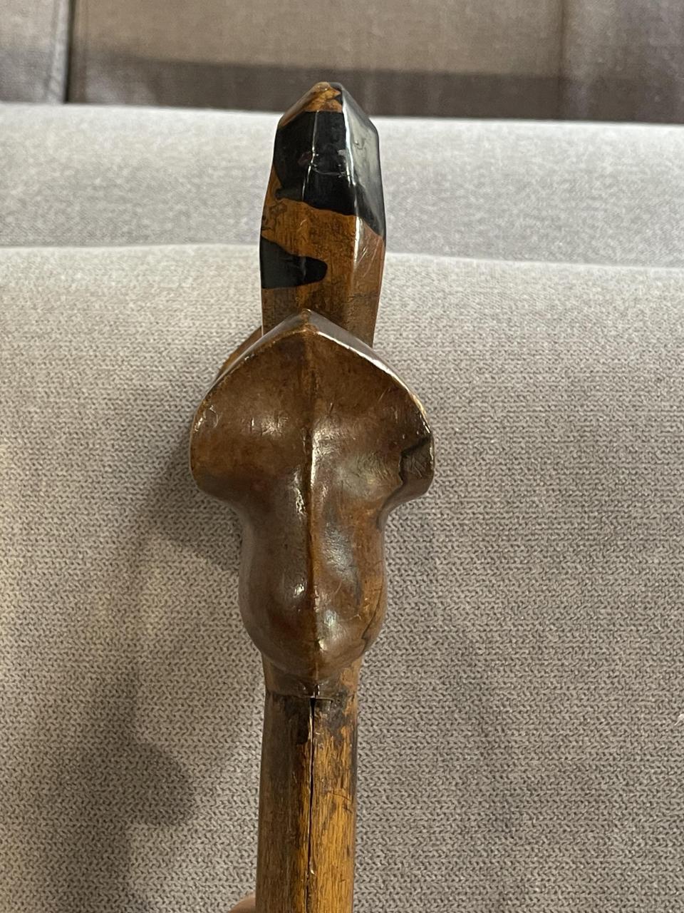

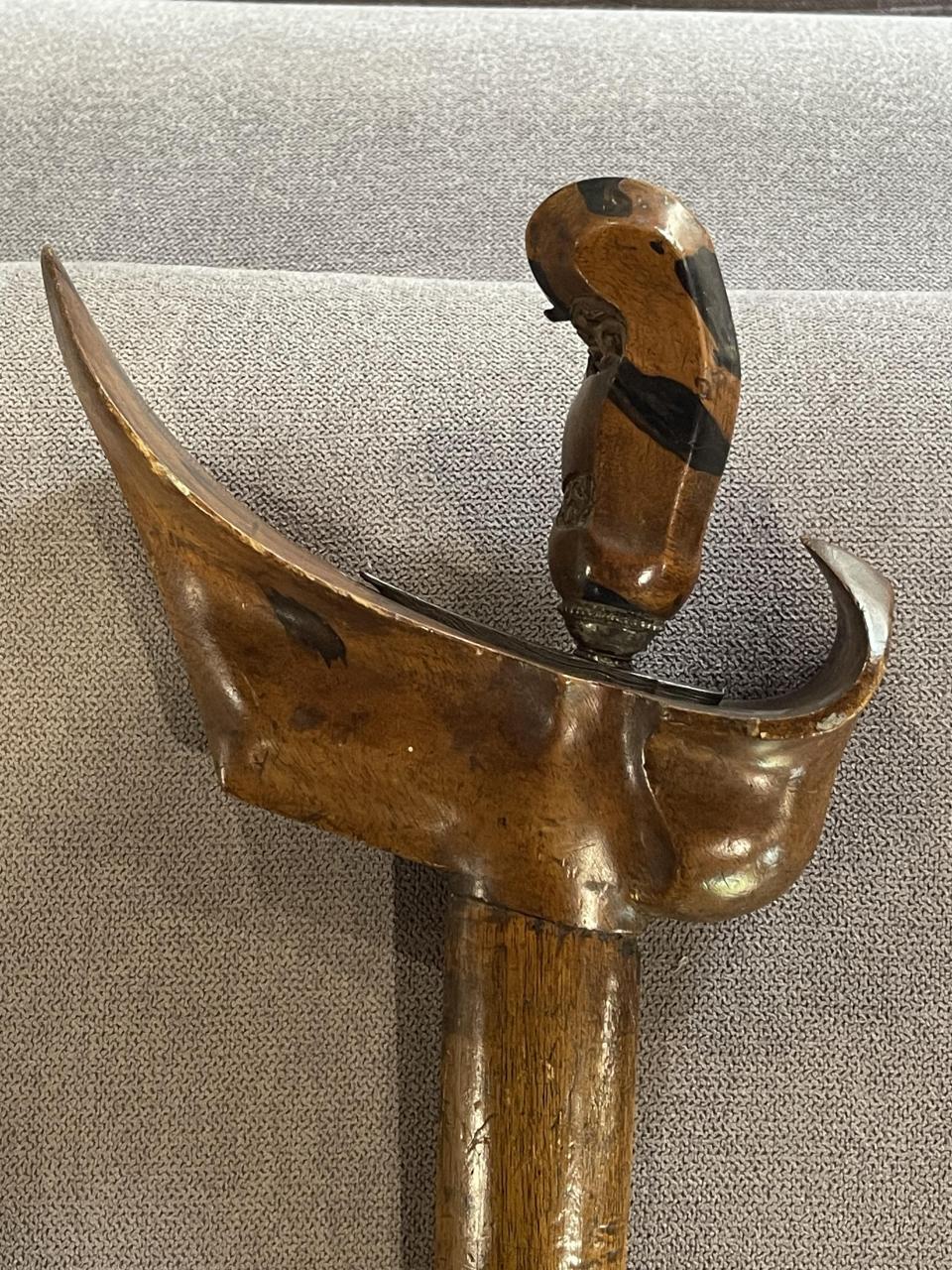

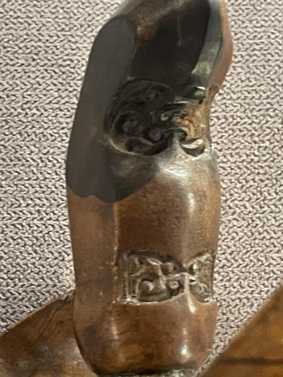

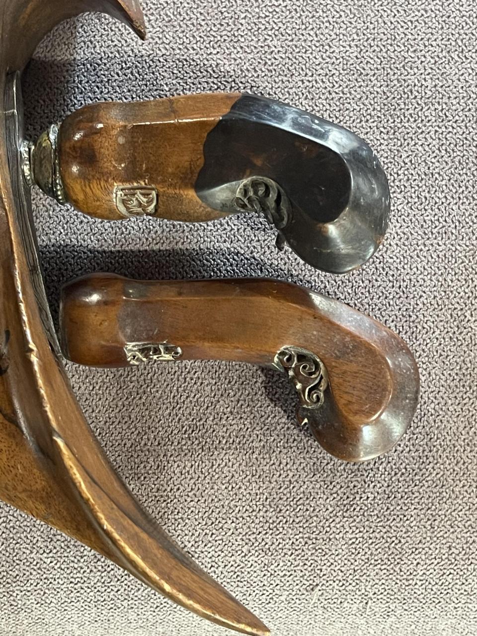

I've been waiting for this to arrive for many months now and I finally have it in hand to provide images and ask questions.

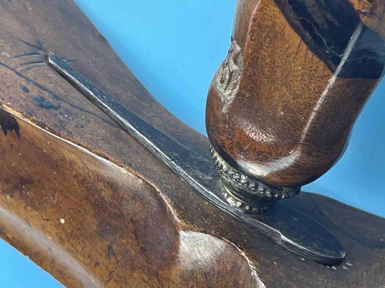

YES, the hulu is reversed... it is set fast.
1/ Is the hulu Deder Yogyakarta?
2/ Is the timber Timoho?
3/ The Warangka seems a little broader than most at 6cms... it this typical or denote anything?

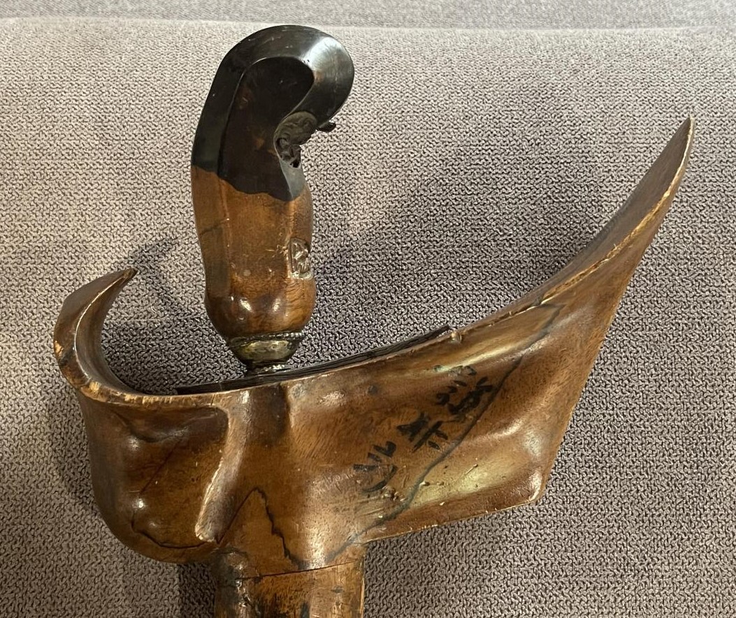

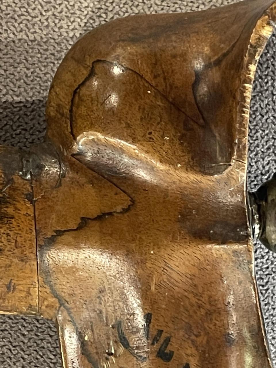

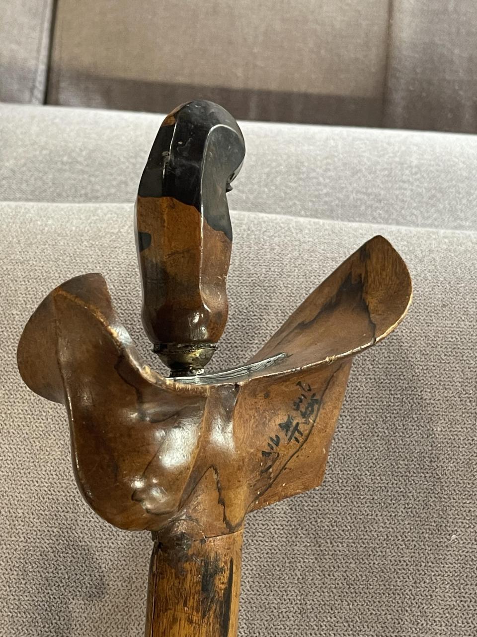

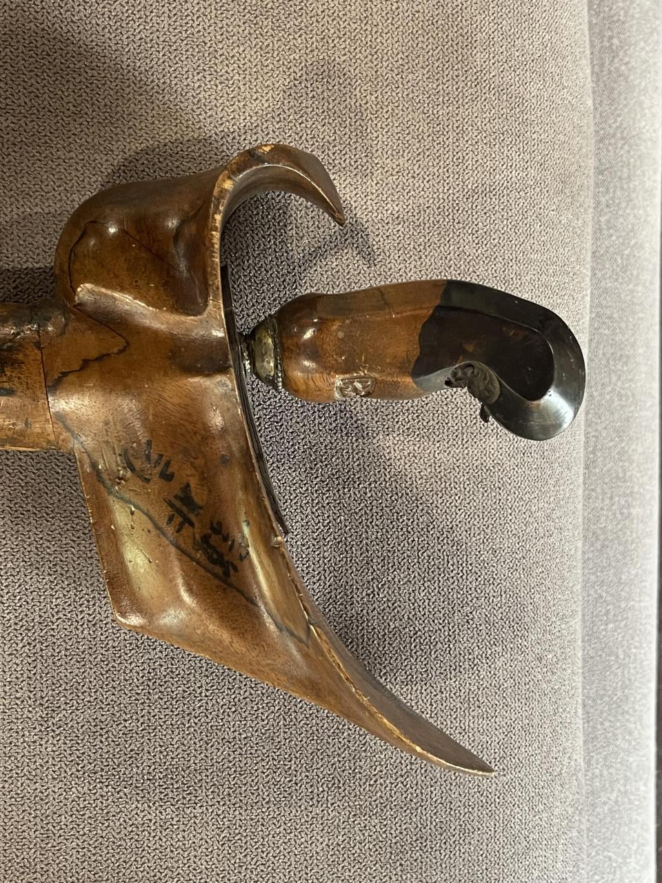

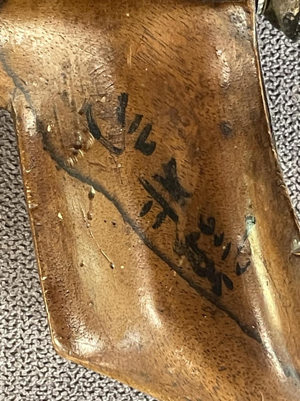

4/ Can anyone offer insights or translation to the inked characters to the side of the Warangka?
5/ Are there any determining factors in the images presented which could be indicative of a safe estimated age range for the dress?
Any other insights welcome.
Gavin
EDIT' Mods, can you please rotate images, they were in the correct orientation on my PC.
Old 2nd July 2023, 07:43 AM   #2
Posts: 7,229
Based upon what I believe I can see, this hilt & wrongko looks like East Jawa, maybe East of North Coast through to East Jawa and maybe including Madura.
The wood might be timoho, it is certainly pelet.
Wrongko looks true to type, from the pics there does not seem to be anything unusual about it. A full length shot would help, but from what I can see the wrongko looks to be kagok capu, this form is found in Surakarta, but more commonly in Madura & East Jawa.
The hilt looks a bit like a Jogja narada kandha, but it appears to be too robust for this, the hilt style tends to Balinese bebondolan, but is too small for that.In my opinion, East Jawa. Mendak is North Coast through to East Jawa & Madura.
I cannot read the text.
For me, absolutely impossible to give an age assessment on dress that I could rationally defend, but if you'll settle for a rough guess:- pre-WWII.
I really do need to see the blade to have a halfway decent idea of what we're dealing with.

Hello Gavin,
I'd guess at Japanese script from WWII...

Hello Gav,
Like Alan I would place the scabbard and hilt to East Java. And pictures from the complete keris and the blade would be very helpful.
Old 2nd July 2023, 04:55 PM   #5
Posts: 7,297
I think pre-WWII is a safe bet. But it could, of course, be older.
I would also place this as East Jawa. Though not a deciding factor, the mendak style is also East Jawa.
I realize your questions right now are about the sheath, but will you show the blade as well?

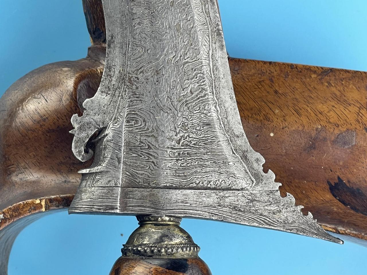

It is a classic hexagonal cross sectioned Bugis blade Alan.
Looks like an old marriage, I cannot see evidence of modern tampering with the timbers, a perfectly snug fit. The inside of the wrongko retains old dry patina with a warm glossy patina over the lip where the blade has rested and moved in and out... old timber working reliefs within seem undisturbed.

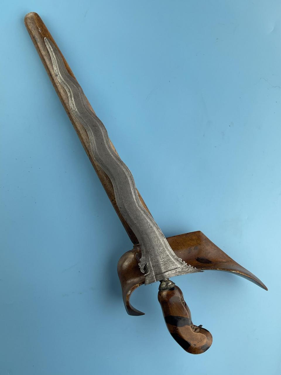

The subject is intriguing, and I present the blade for viewing.
This not the average Bugis man's keris. To my eye and hand it is expertly made.
The edges are some of the sharpest I've ever encountered and they are very clearly defined within a single row of twistcore that has been layered quite well.
It is thick, robust, weighty, but so elegantly balanced. It contains a "symmetry" of sorts (for want of a better word), within the asymmetrical blades that keris are.
If indeed it is an older marriage under the subject you have pursued, the blade may offer a better glimpse in to time.

Love this blade! Thanks for showing it.
Any plans to try to loosen the adhesive fixing that hilt so that you turn it around?
Old 4th July 2023, 05:22 PM   #14
Beautiful blade! I personally would keep this keris like this but would try to turn the handle in the correct direction.

In respect of the hilt.
We're used to seeing keris hilts in an agreed orientation.
That agreement is something that is correct for dress and it suits well the rapier grip.
However, the most useful grip for close combat is the reverse grip, that is, the grip that was used on the Keris Buda. This grip allows immense power to be delivered to the point, and is ideal for a situation where combat has become something like cage fighting, but one hand has a sharp pointy thing in it.
In fact, with the reverse grip you have several blows available with a single hand, you can punch, you can use the pommel, & you can use the blade.
With the reverse grip on a dagger you need to be able to support the edge of your hand, on a keris, the gonjo provides this support when the reverse grip is used.
If this keris was mine, I would apply heat to the sorsoran --- a candle or small kerosene lamp will do it, but a heat gun with a small nozzle is cleaner --- and I would remove the hilt and check what adhesive has been used to glue the grip to the tang. If it is a modern adhesive, I'd put the hilt into the agreed "correct" position, if it is jabung, or some other native adhesive, I'd put the hilt back in place in its original position.
In removing the hilt I would proceed slowly and gently, the hilt might not move because of rust, the rust might have weakened the tang. We do not want to break that tang, so, slowly, gently, not too strong in the wrist.

Yes, a gorgeous blade.
What is a bit unusual for a Sulawesi blade is the single twisted rod on a side. This actually could be the first such blade I see. Two rods on a side are much more common.
Old 5th July 2023, 12:09 AM   #17
Thanks, Gavin!
Could you please provide a pic from about the middle of this neat blade, too?
From the base of the blade, the pamor is tough to evaluate despite the very nice stacking.
