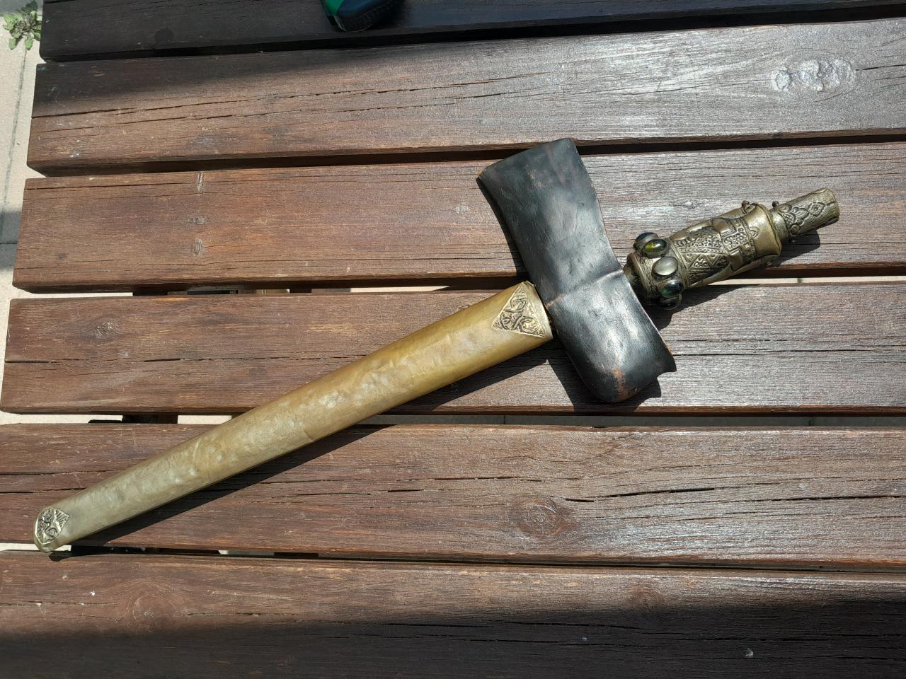

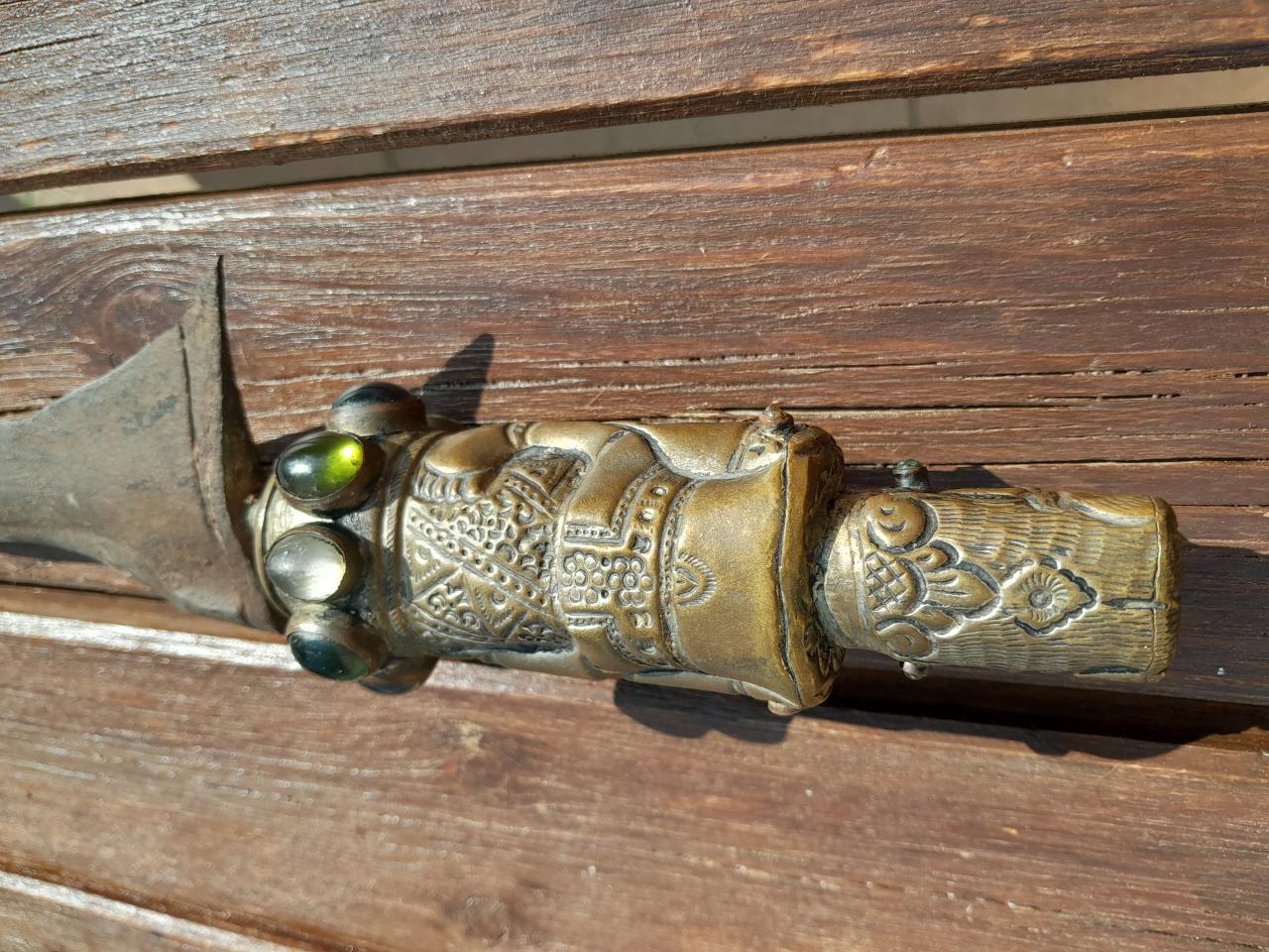

Hello dear members,

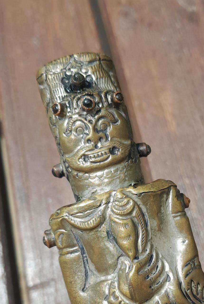

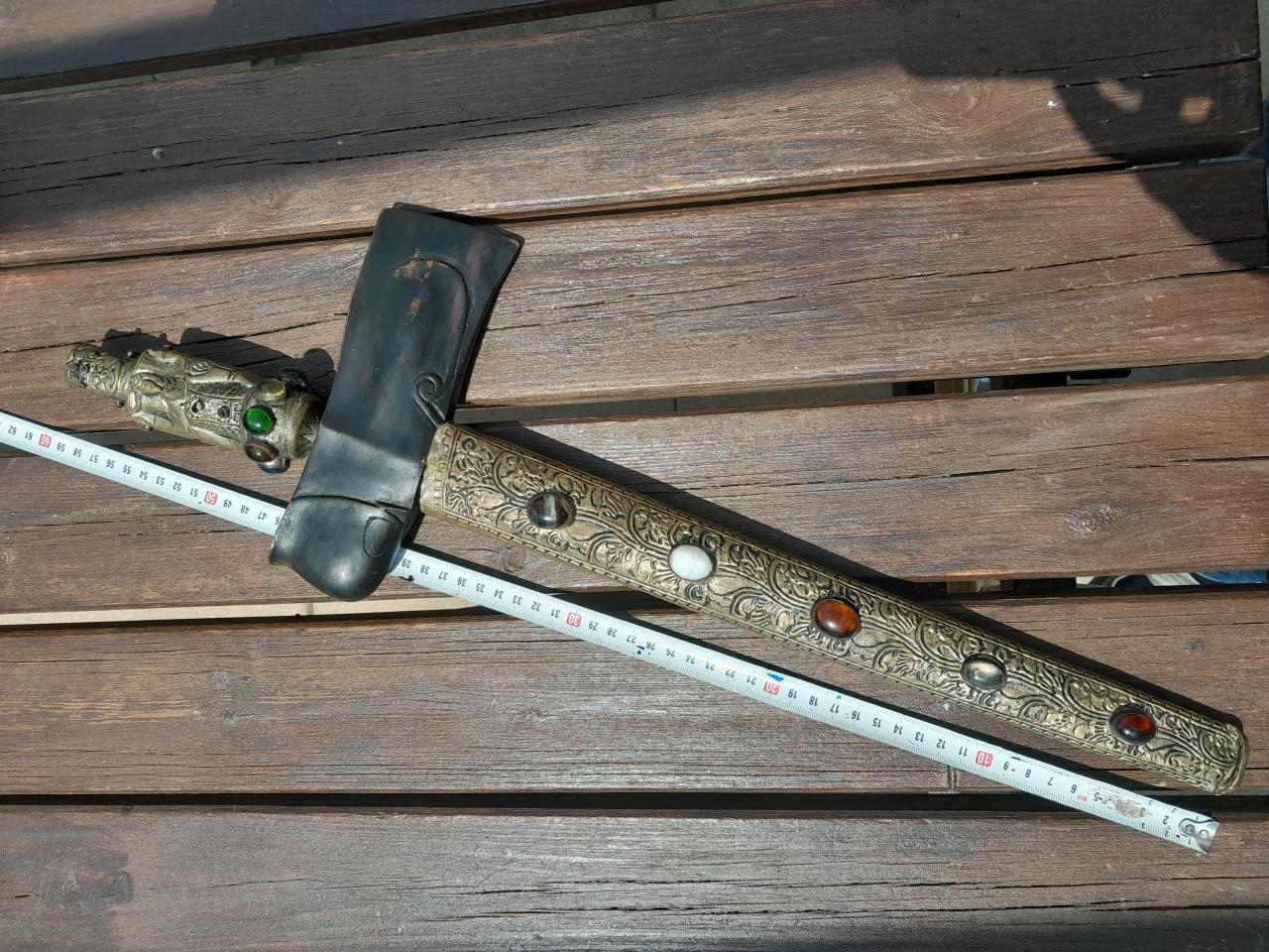

I got this dagger and I'm not a specialist at all in keris.
I hesitate between tourist made really recent stuff and real item:
The blade, wood parts seems old.
Scabbard and hilt seems made of brass.
It's a large model, more than 60cms long.
Interesting caracter for the hilt :
Looks like a nobile man with a fish,
Fisher king ?

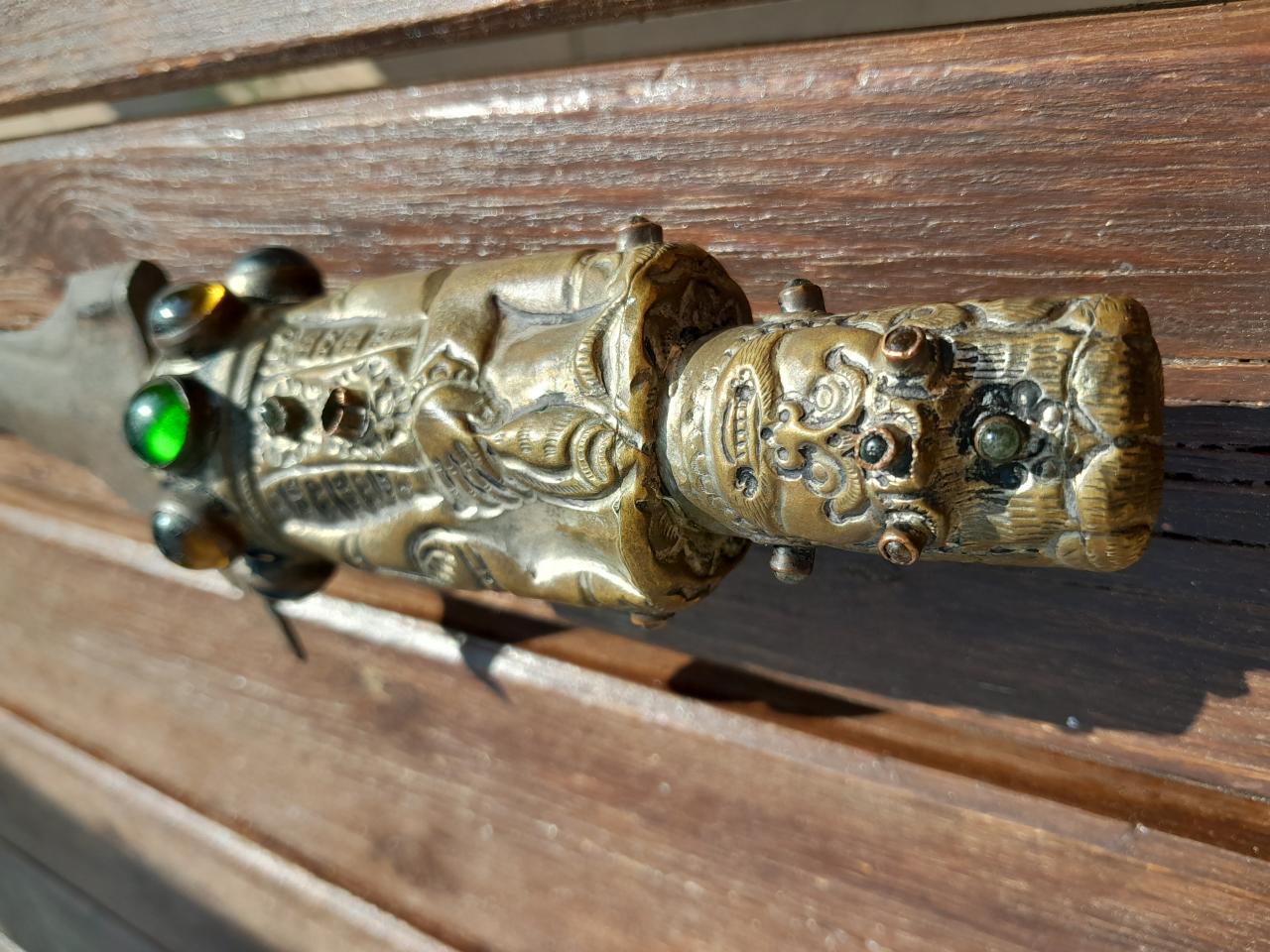

Fisher king ?

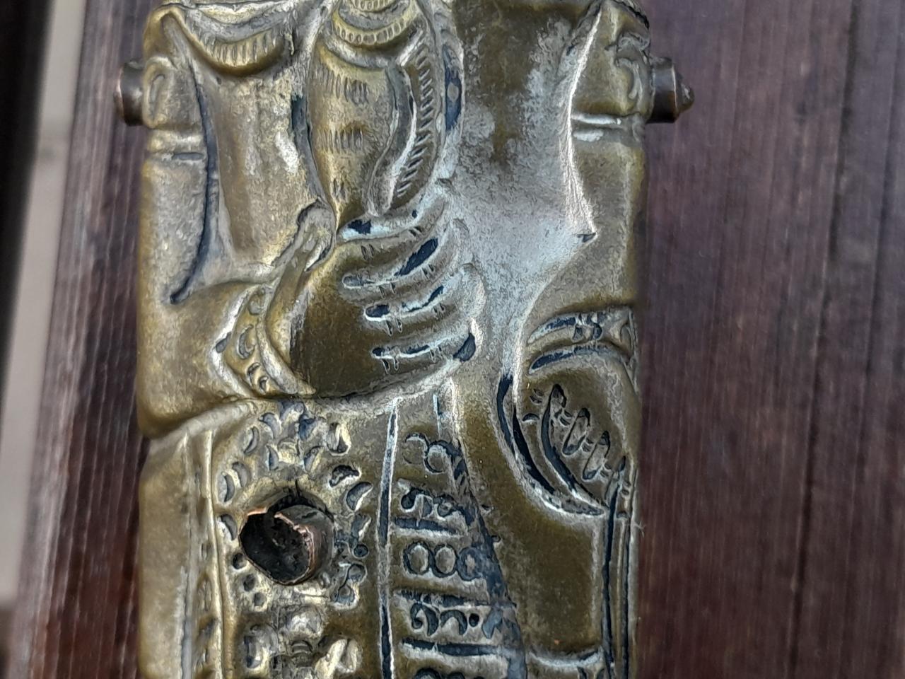

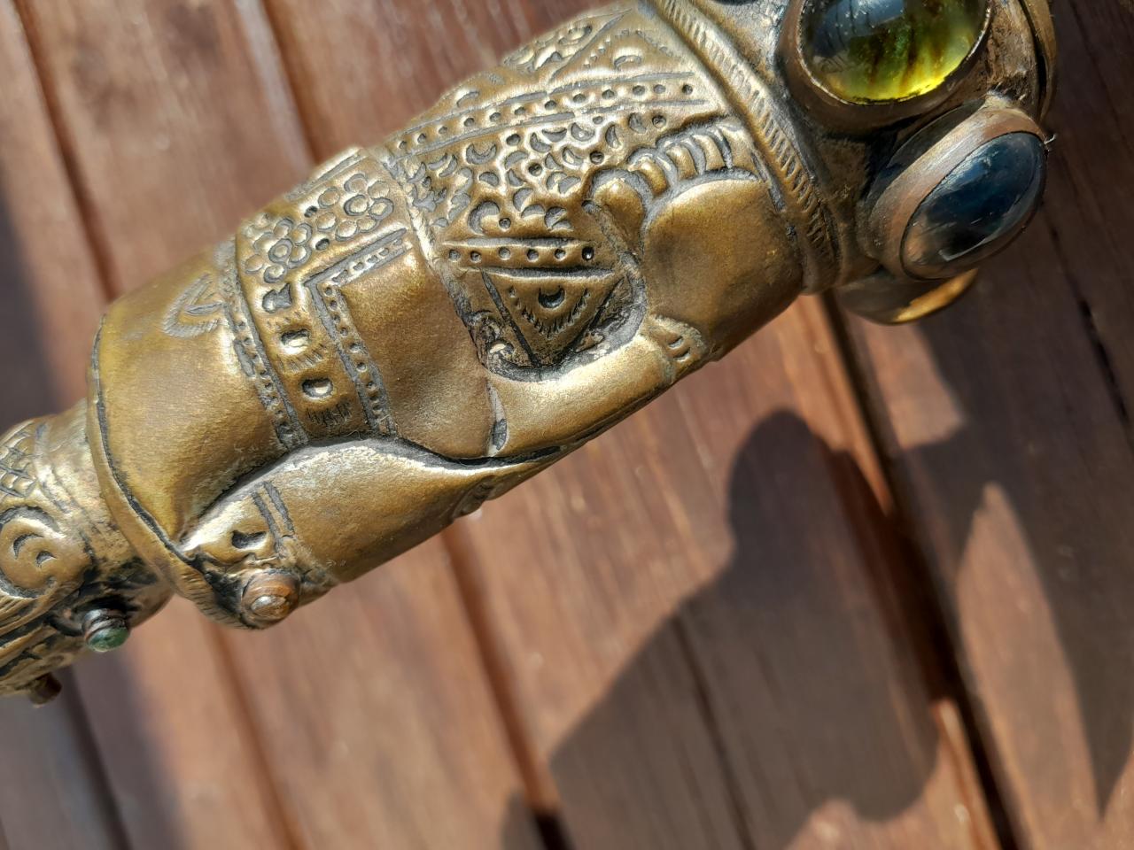

The other questions I will leave for the knowledgeable. He is holding a shanka (conch shell). While many carried and used this auspicious symbol it is associated with Vishnu in particular. The shell is normally held in his right hand.

Thank's a lot for the conch and Vishnu idea,
If it is Vishnu, he can have his four arms but no other attribute /symbols like mace, chakra or lotus
( maybe just 2 arms and 2 legs !)
Last thing: maybe it is gilded
Old 26th May 2023, 05:56 PM   #4
Red face Was expecting something different from the thread's subject line...
Hello Franc,
I agree with IP on the conch shell.
I'm pretty sure this hilt was never gilded. It's a more recent style from Java copying keris Bali during the second half of the 20th century, I believe; craftsmanship is usually low to abysmal and this seems to be one of the better examples.
Its collectability rates low in my book though since this is neither a traditional hilt style nor modern keris art.

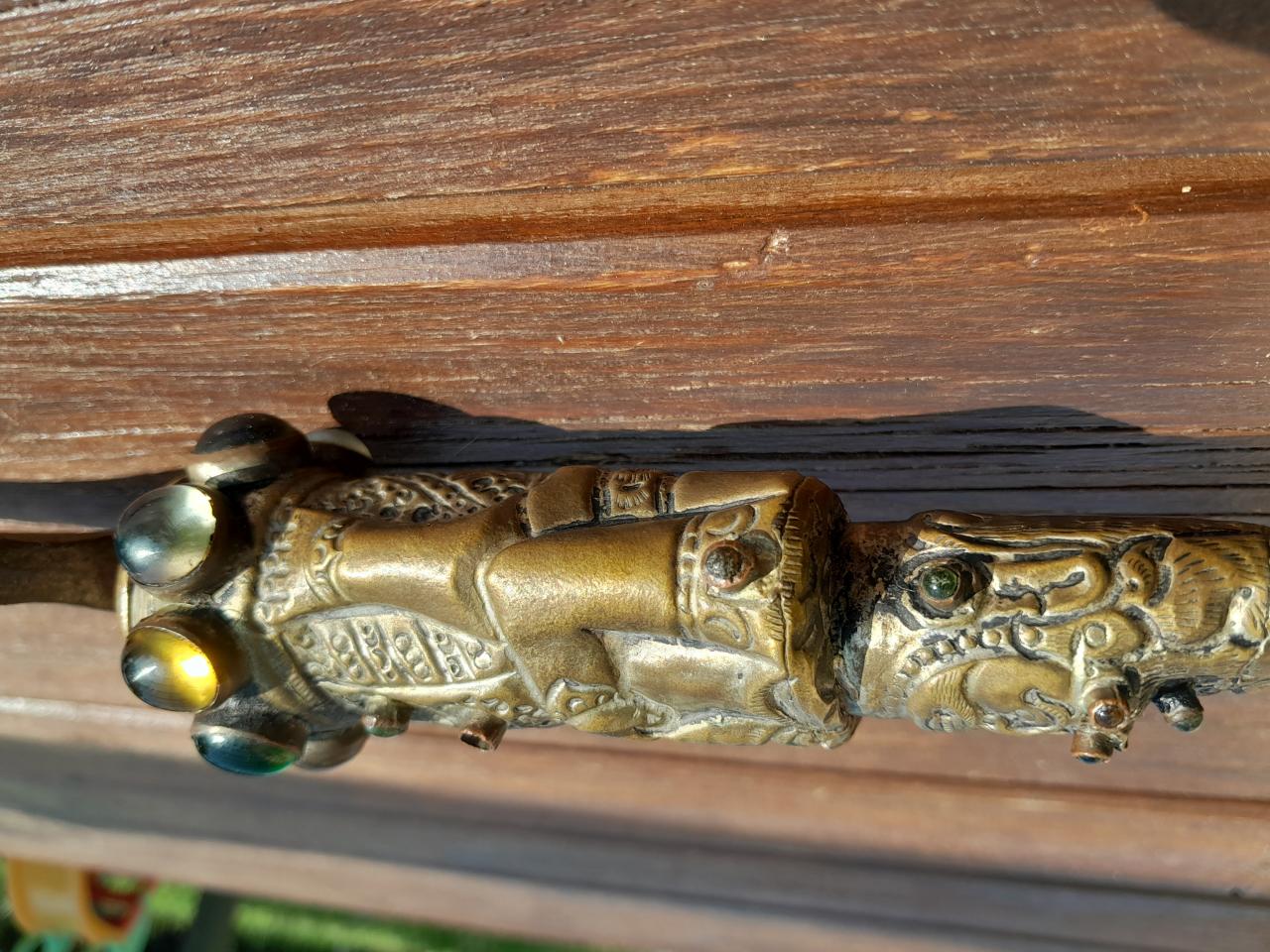

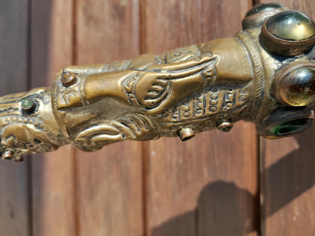

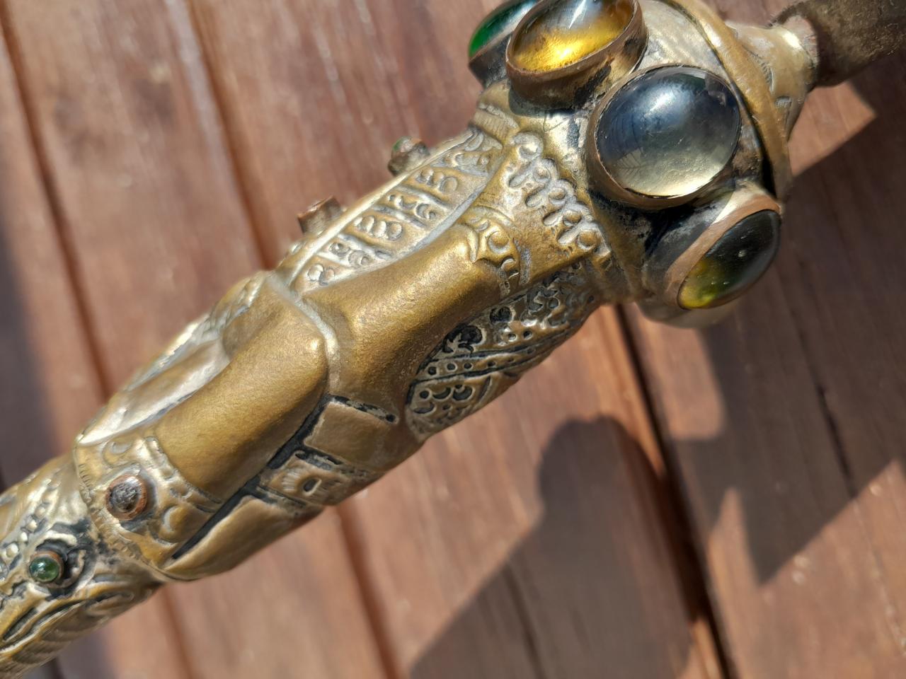

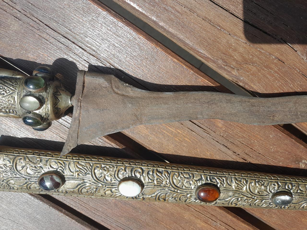

Thanks for the additional pictures. The long nails on the left hand are interesting. Looking again the eyes are very round maybe implying less virtue. Of course, I could be applying cultural values that do not apply to this object. I am looking forward to the experts weighing in! Thanks, Kai, for the vote of confidence.

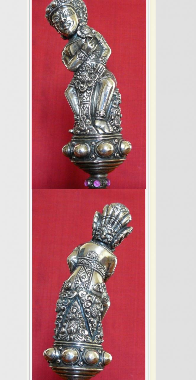

Old 26th May 2023, 07:35 PM   #6
francantolin
Join Date: Sep 2014
Posts: 971

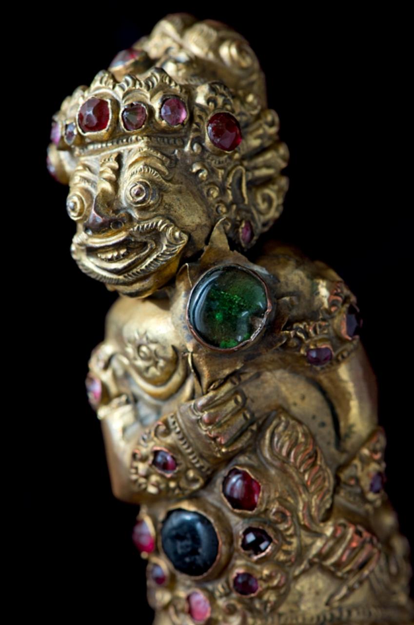

It must be battara Bayu, ( with a conch...?...)
two arms and two legs...

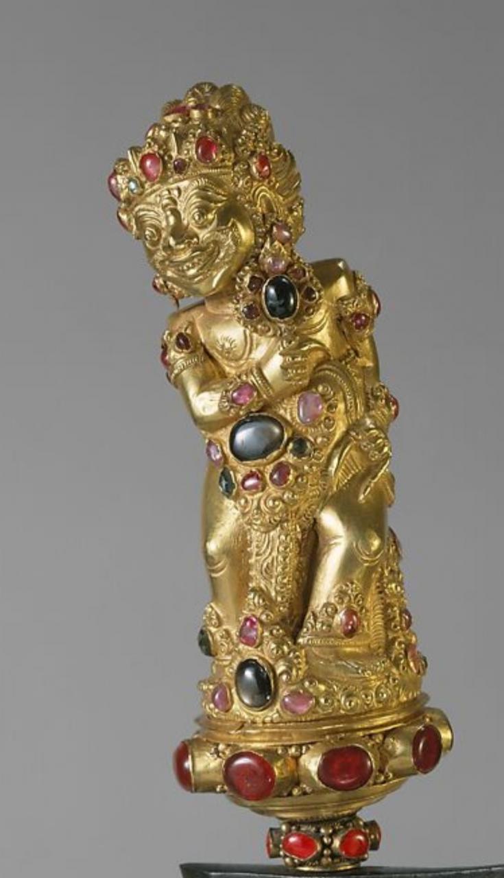

Found some pictures,
Two from another post in Vikingsword
The last from the MET ,
Sure, another quality...
Old 26th May 2023, 10:56 PM   #7
Posts: 7,230
Kai is absolutely correct in what he has written.
This keris uses a Javanese blade, it was put together in Jogja, the man who was the principal fabricator of this hilt style passed about 25 years ago, he had made these in his younger years, and probably his father before him.
There was more than one maker, I only knew the man I have mentioned.
I used the word "fabricator". The metal shell was made by one man, the fabricator, the embossing work was done by a second man, the chaser.
Because these were very low cost tourist items, only low grade chasers were used, thus these hilts are never of any quality.
No cultural values can be read into this keris, nor the components of its dress. They were made for dealers and fed into the market by general dealers, not by anybody associated with keris.
Some were sold locally in Jogja, others went to Jakarta & Bali.
Old 27th May 2023, 12:59 PM   #8
francantolin
Join Date: Sep 2014
Posts: 971
Hello all,
Glad to hear the blade is javanese and learn about the origin and craftmanship of the metal parts,
Sure not an antique but there is work on it and I'll keep it in my sword collection .
For the ''gilded'' term , it's because it seems ''powdered'' on many parts and has a white metal color (under?) many parts
Maybe it is a mix of brass and other metal...

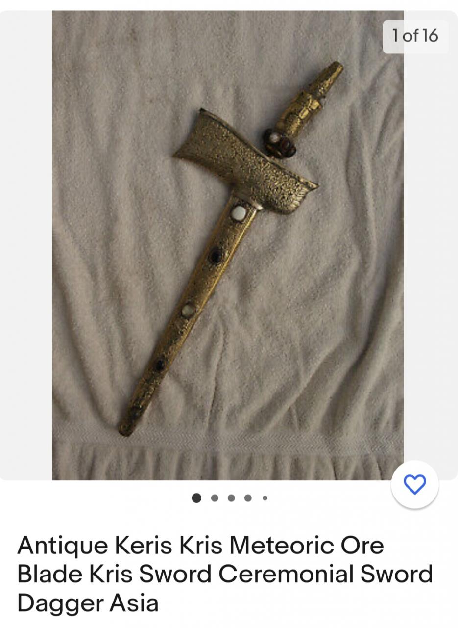

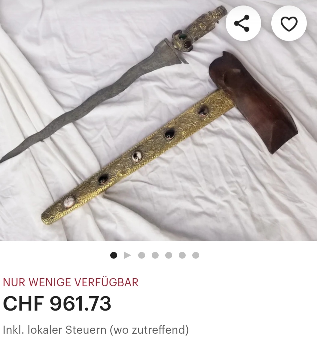

I just found two brother and sister to my dagger,
Really exagerated prices and said to be19th century
( with lower craftmanship quality )
I can reassure you, I paid more than 15 times less for mine.
Beware one more time...XXXX
Old 28th May 2023, 02:15 AM   #10
Posts: 7,298
Well, to be be fair, i would say that the blade here is very probably an antique. What these sellers do is to redress old, well worn and mostly unwanted blades in this weird, low quality "blingy" dress. The cloth here are contemporary, but the blade still has some age.
