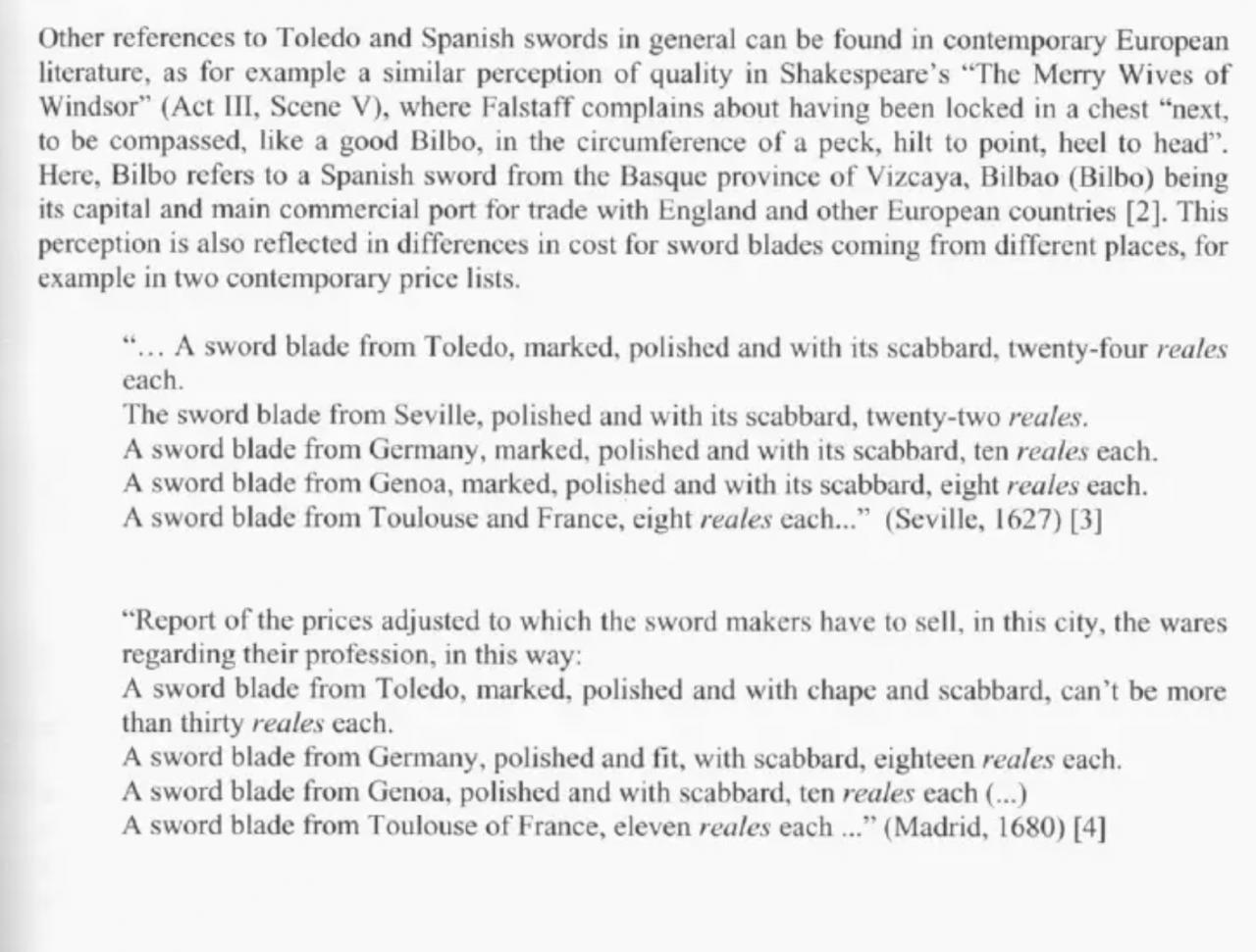

If you know the contemporary livres to reales exchange rate, you might get a good indication from https://www.academia.edu/858988/Meta..._rapier_blades.

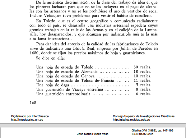

I have somewhere a comparison of the cost of Toledo and Solingen blades in the xviith century. The first were 4 times dearer. In reales.
Now. Where was this? Leguina?
Victrix just put it, Marc Gener.

The problem is that we can find prices for blades in the required period, but not for whole swords.
