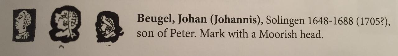

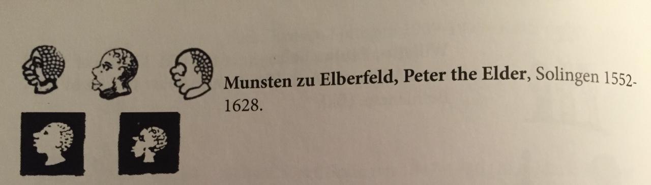

Congratulations on your acquisition. Staffan Kinman’s European Makers of Edged Weapons, Their Marks (2015) lists two Solingen smiths with marks consisting of Moorish heads: i) Johan (Johannis) Beugel 1648-1688 and ii) Peter the Elder Munsten zu Elberfeld 1552-1628.

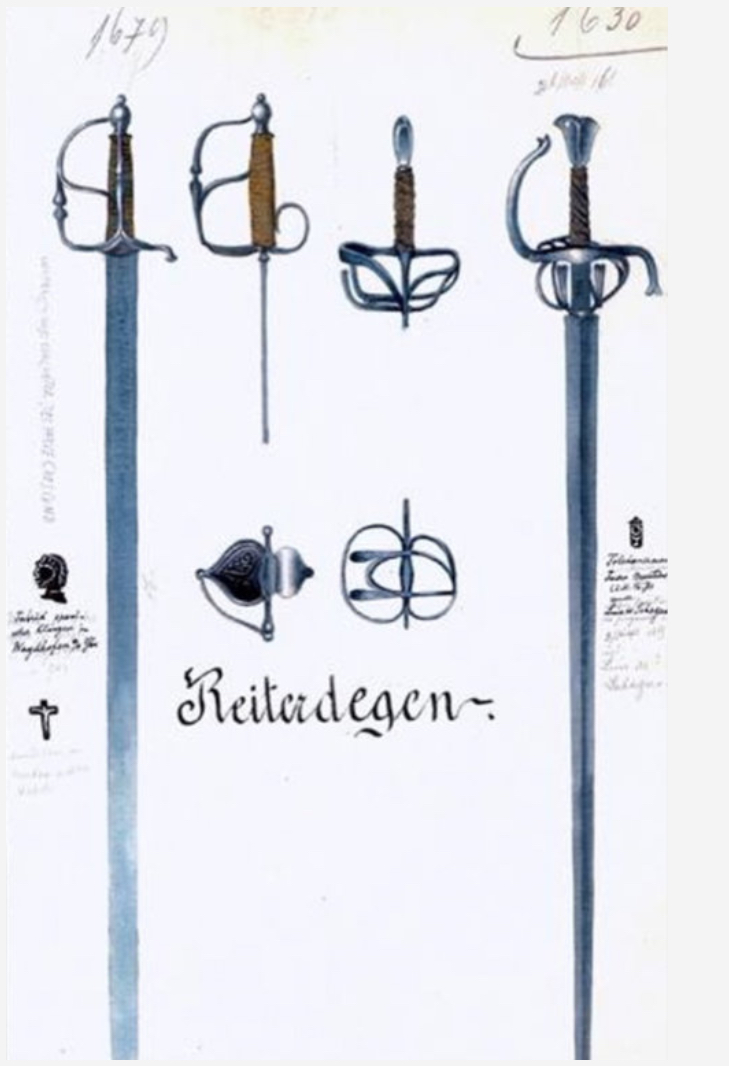

Originally Posted by Radboud View Post
Great looking sword, but technically not a rapier. More of a broad sword with a mortuary or walloon style hilt/guard.
True. These type of swords have many names like Felddegen, Reiterdegen, Walloon sword, etc.

I'll add haudegen, just to expand the set. }|:oP

They would have called it a Sword. Modern useage would call it an 'arming' or 'one-handed' sword. Broadsword (as one word) is more used for Scottish basket hilted double edged swords.

See post #2 above. Kinman’s book is highly recommended.
