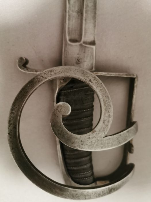

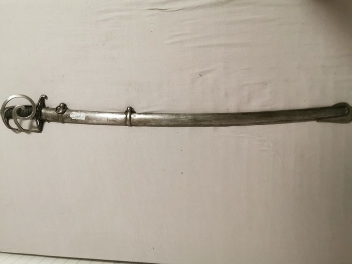

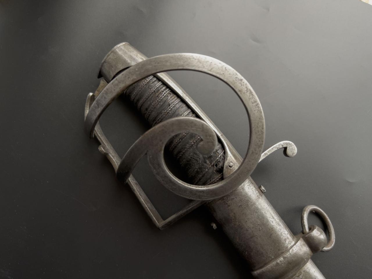

Hello everybody. I bought a saber at an auction, apparently Austrian, what do you say? I cannot find a similar model and understand the brand.

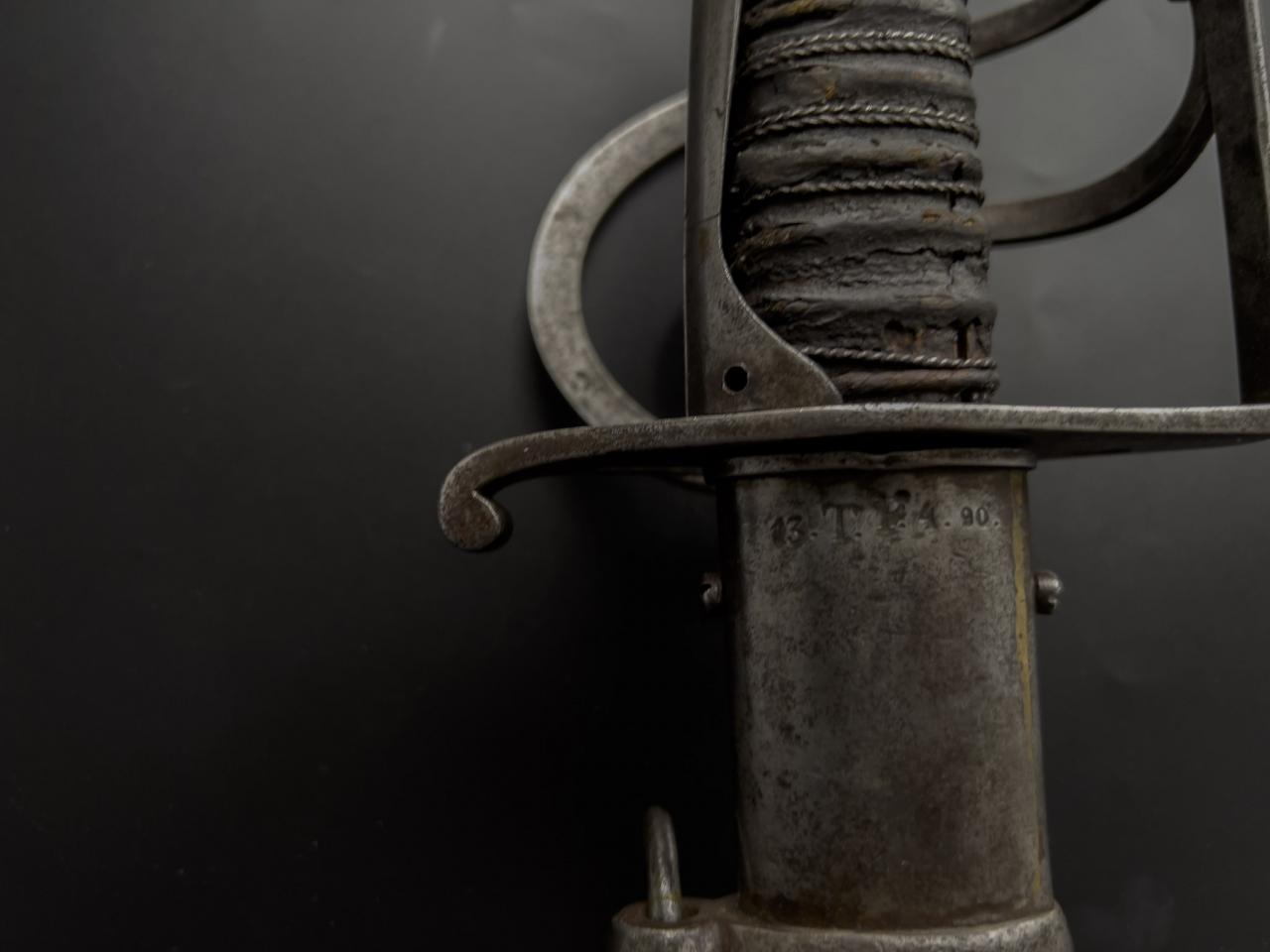

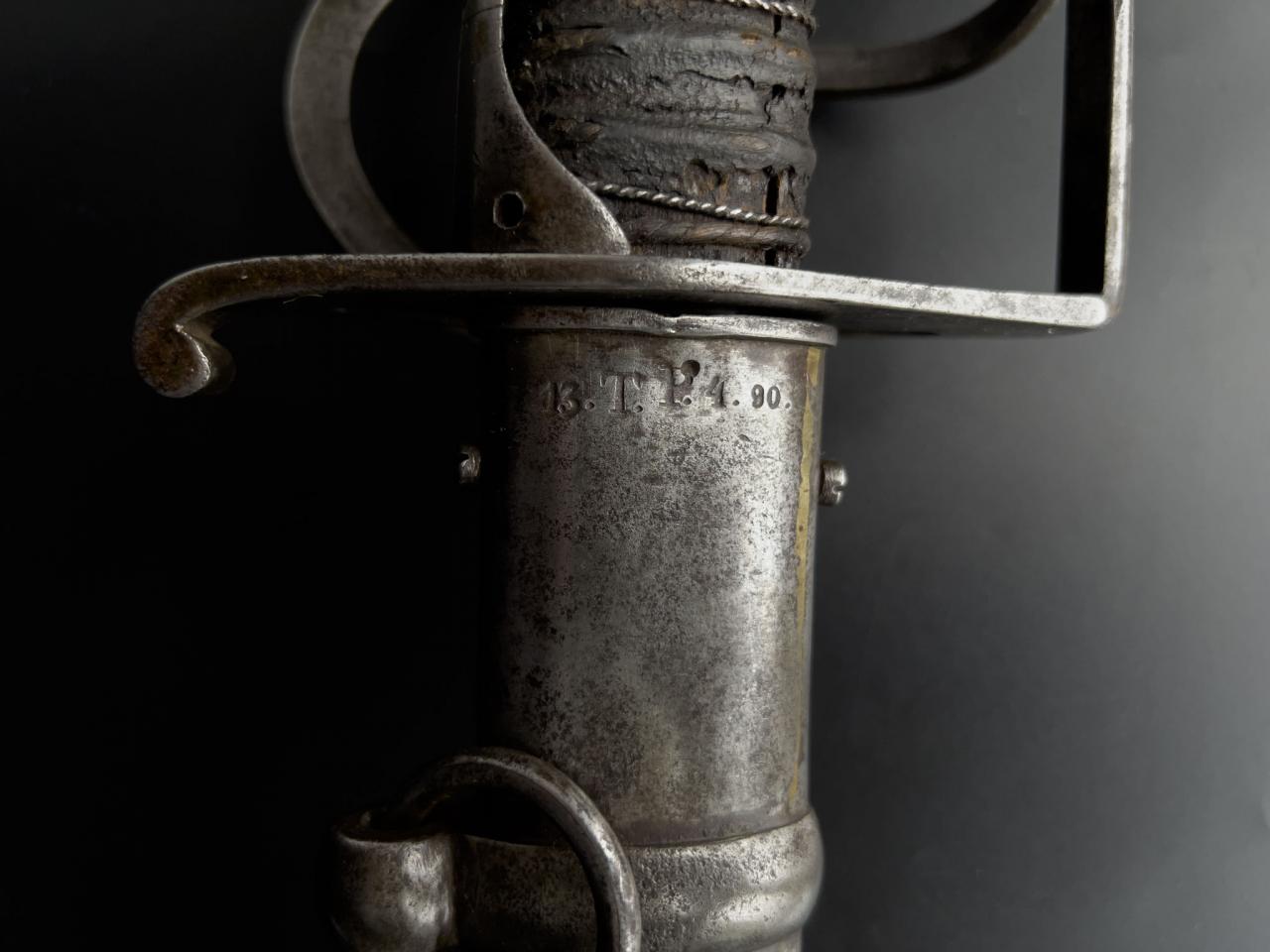

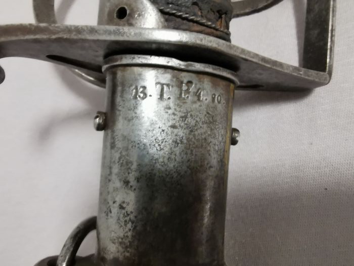

As far as I can see this has nothing to do with Austria - it is a Württemberg officer sabre M 1817 which has been in use still during the First World War. The troop marking stands for the "Württembergisches Landwehr-Train Bataillon N°13".

It has always been amazing to me that these very early German sword types were in use so late and into WWI. It also seems that these stamped markings most often denote 'train battalion's'.

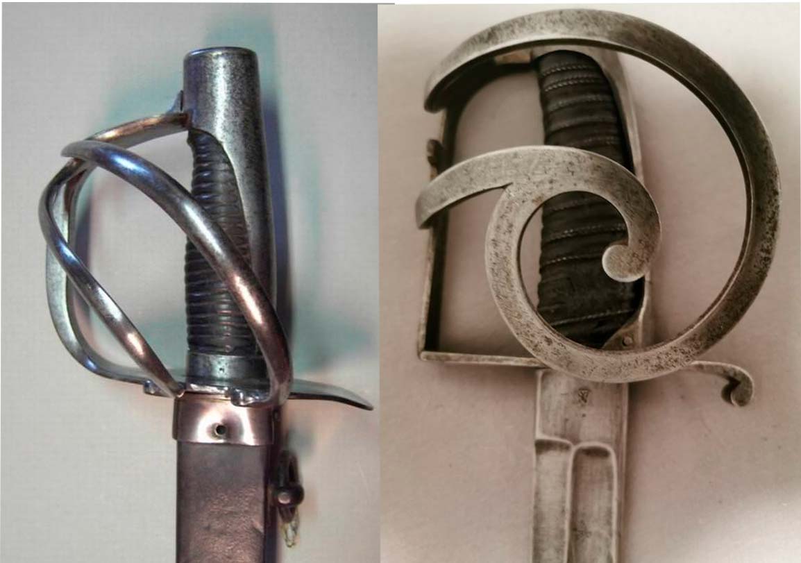

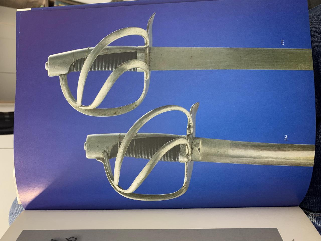

Hi guys. Thank you so much for your answers. But the "Württemberg officer saber M 1817" has a different hilt from the saber that I sent you. Possibly a modification for the 'train battalion's' ?. I found a forum thread with a photo of sabers m1817, as well as a photo from a book, I want to share with you.
https://sbg-sword-forum.forums.net/t...-cavalry-sabre
messia is offline   Reply With Quote
Don't forget that officers are in the situation to arm themselves on their own cost and could order sabres of their own taste. Over that it is not certain that the sword and its scabbard originally belonged together. The troop marking of the scabbard is missing at the sabre so that it is rather obvious that they have been put together later, very understandable in the long time this sabres had been in use.

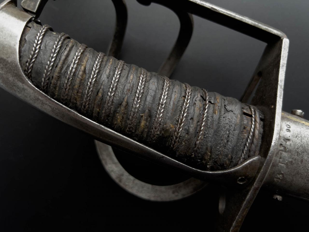

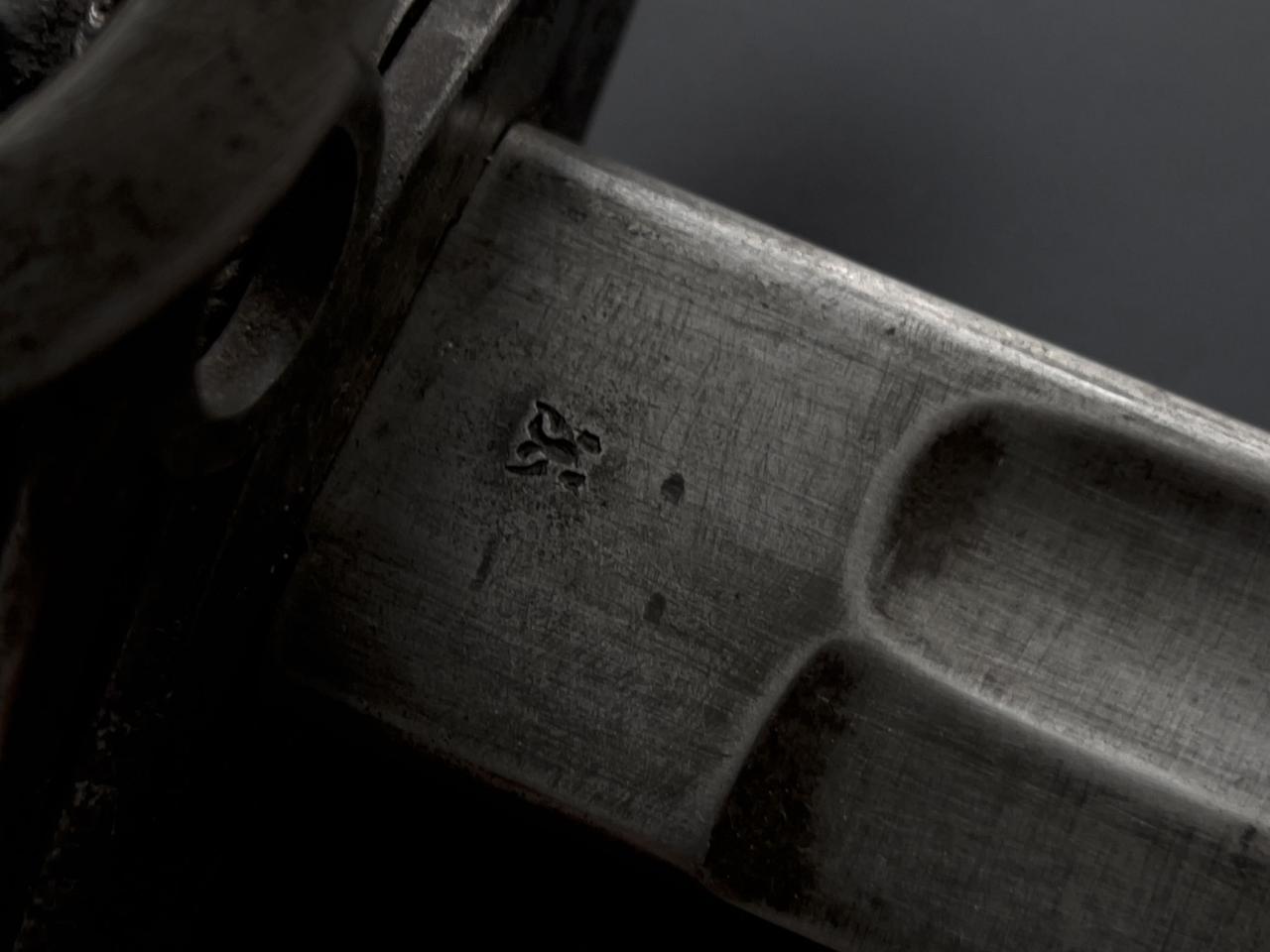

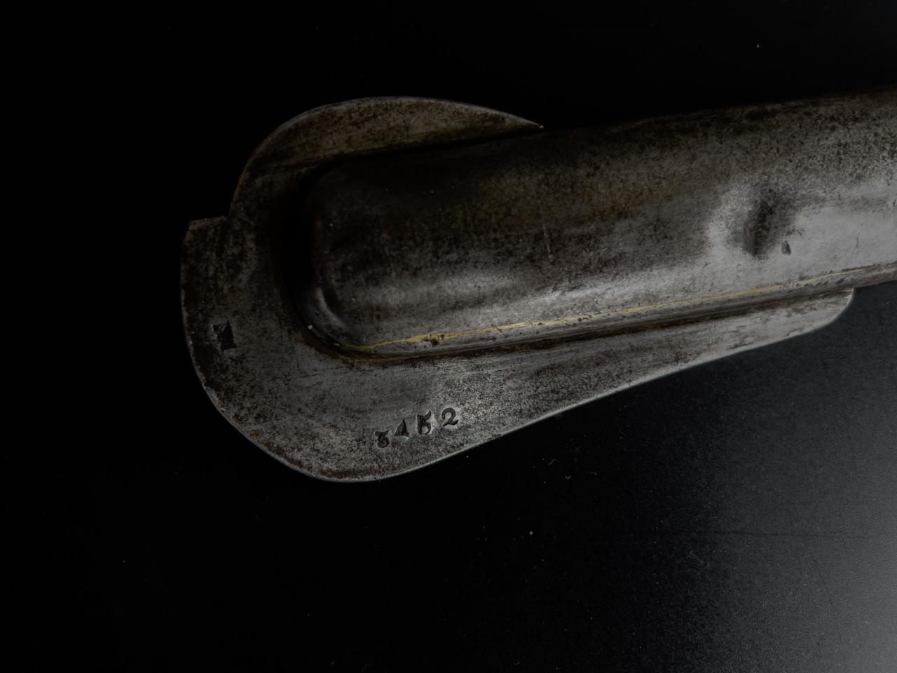

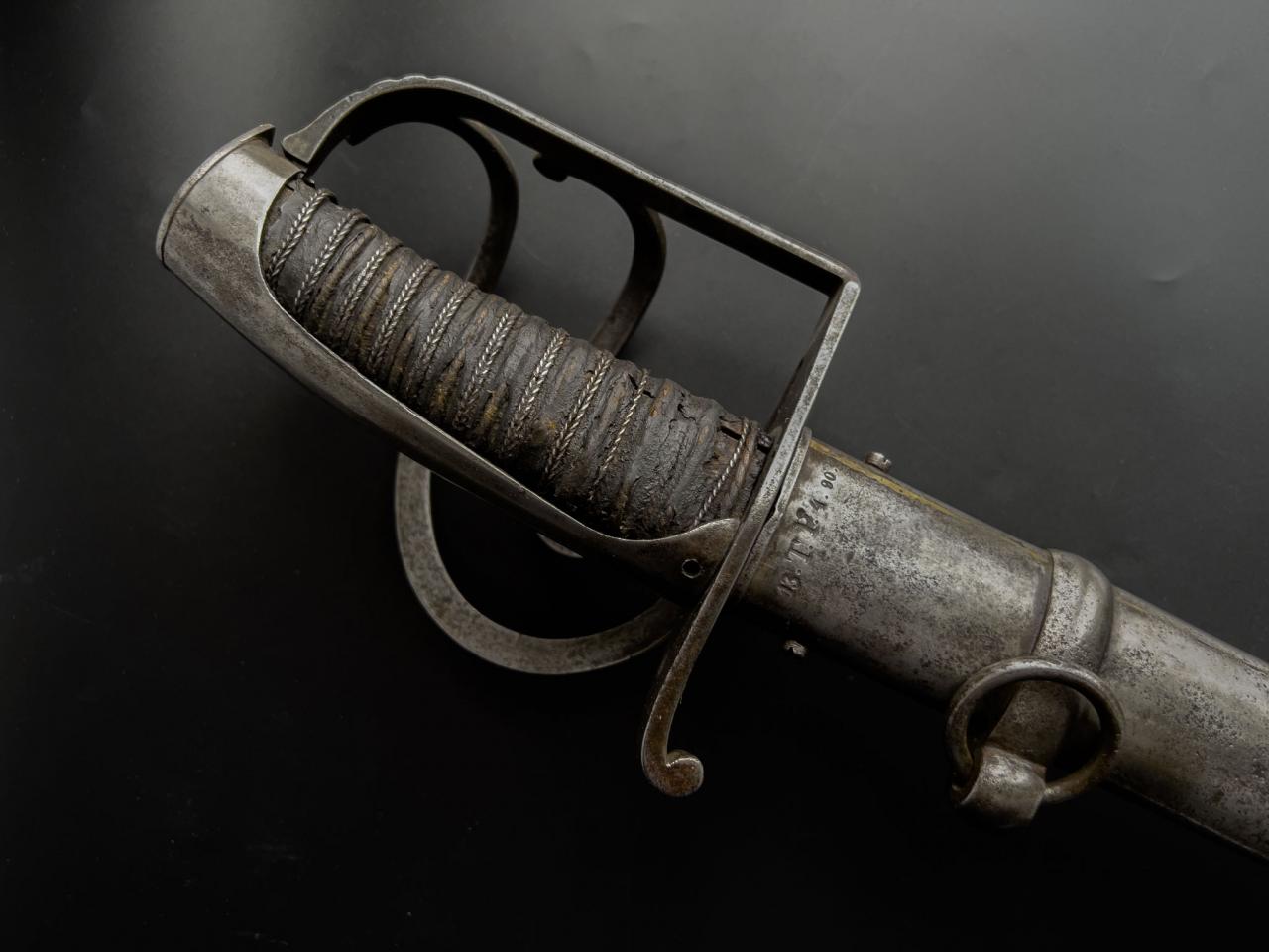

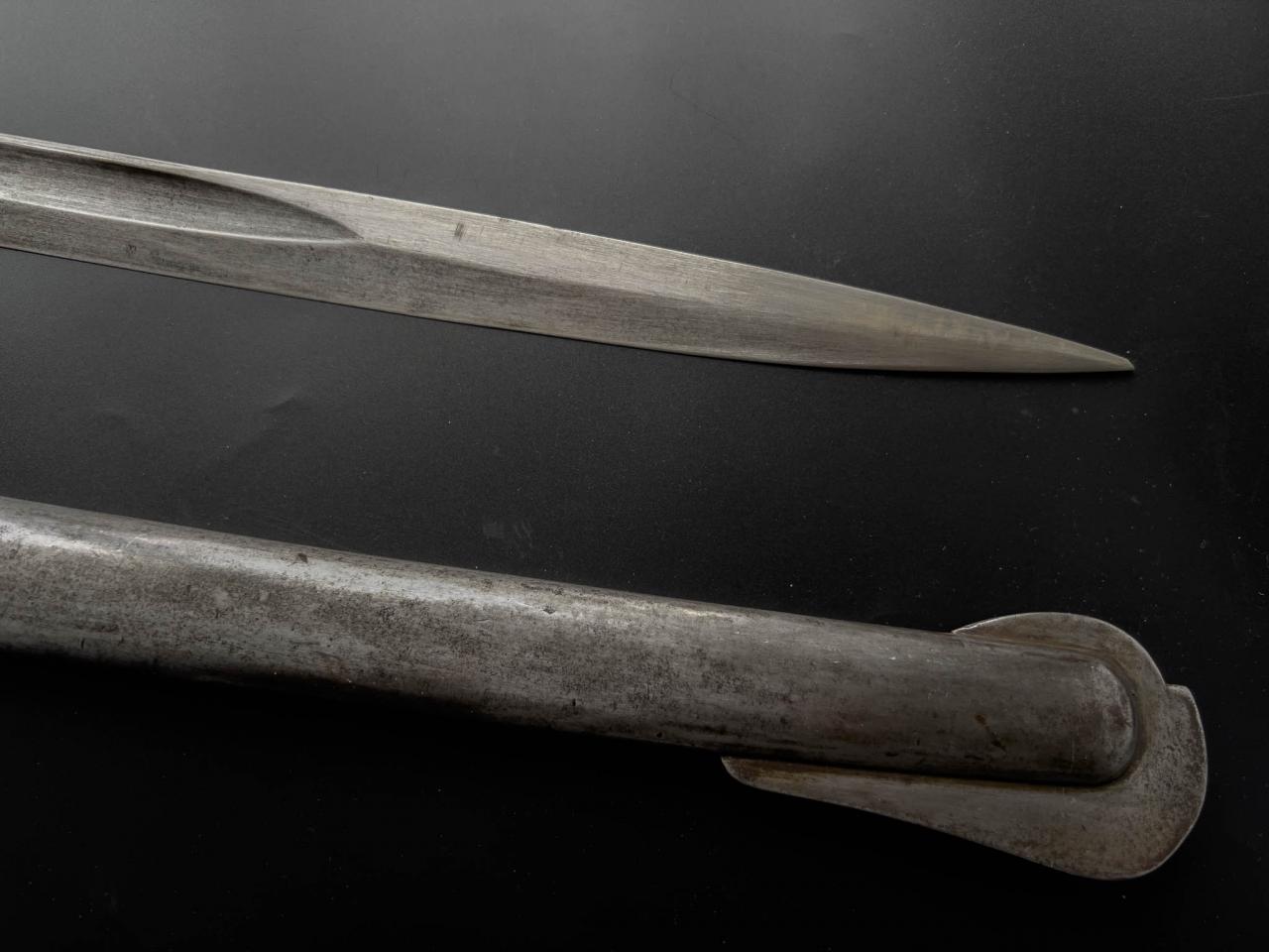

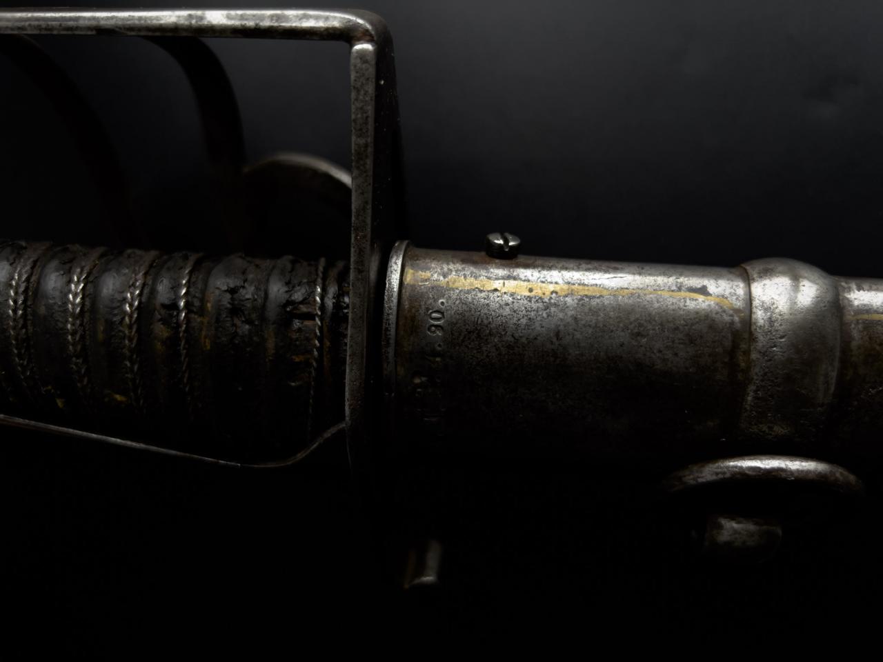

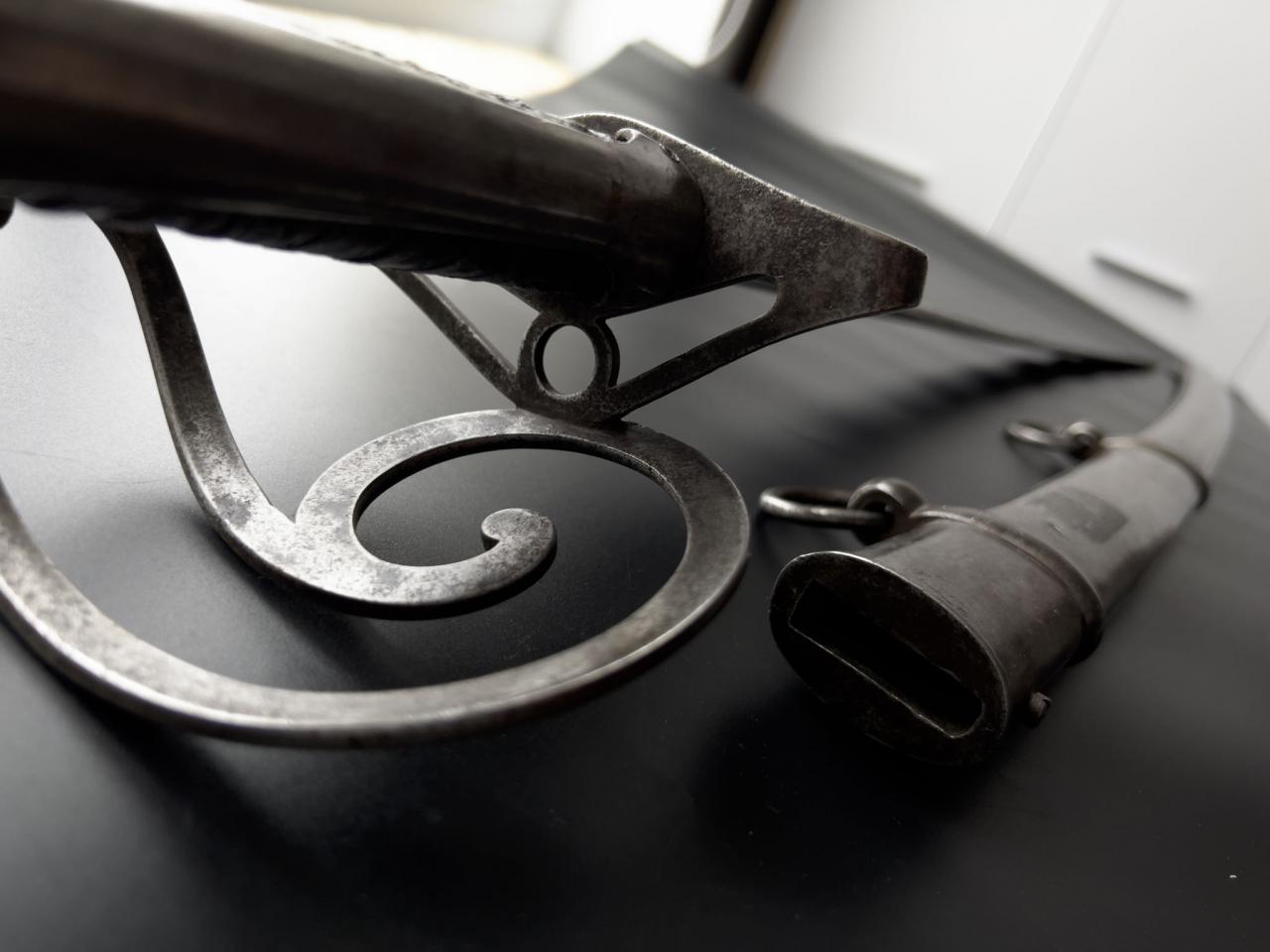

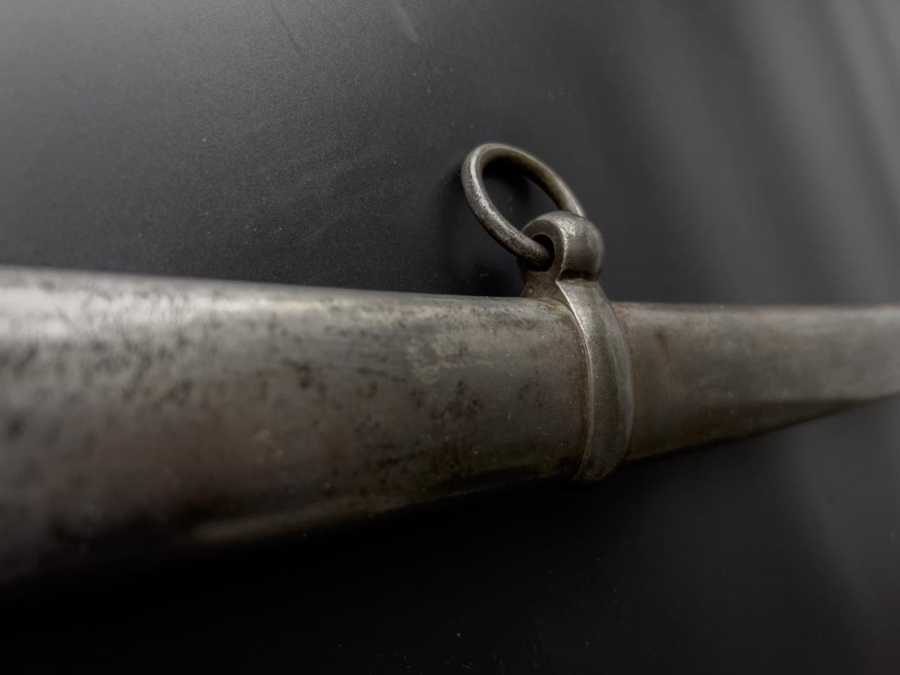

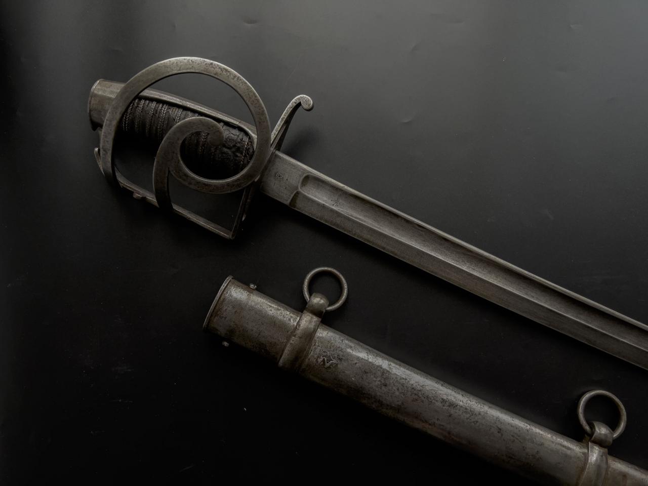

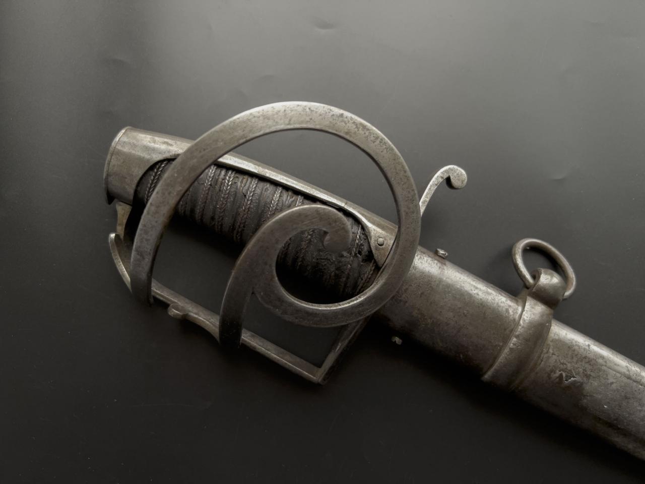

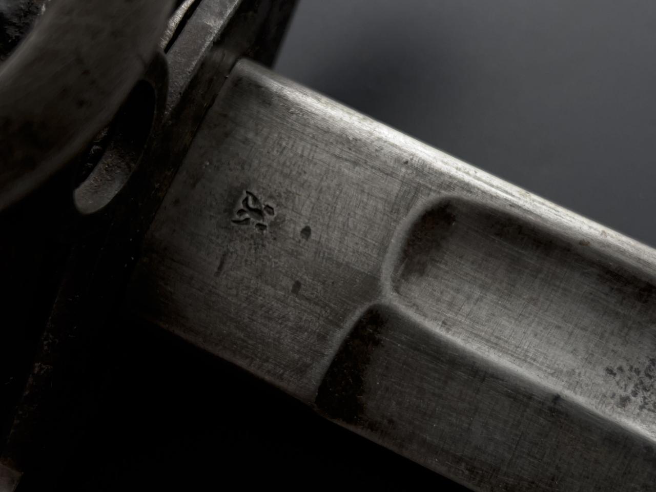

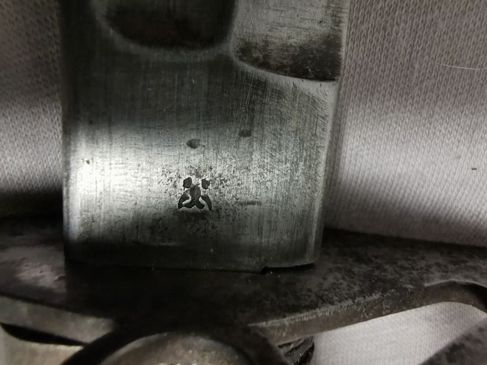

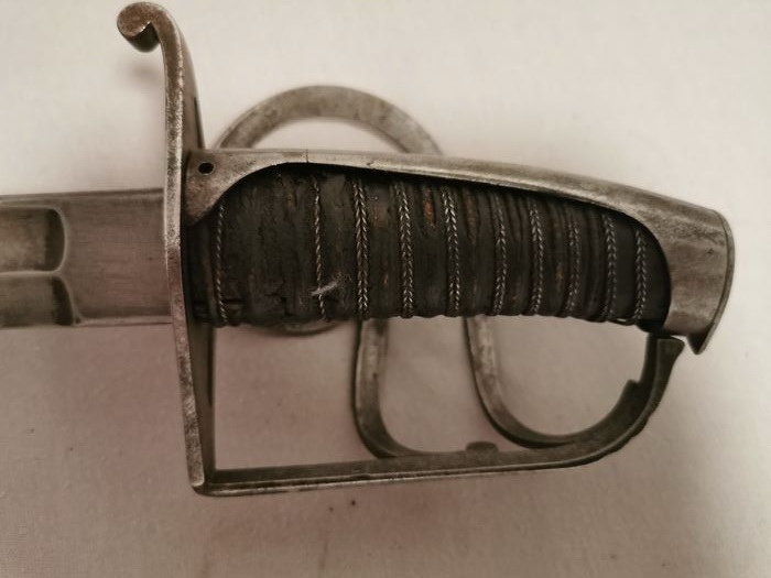

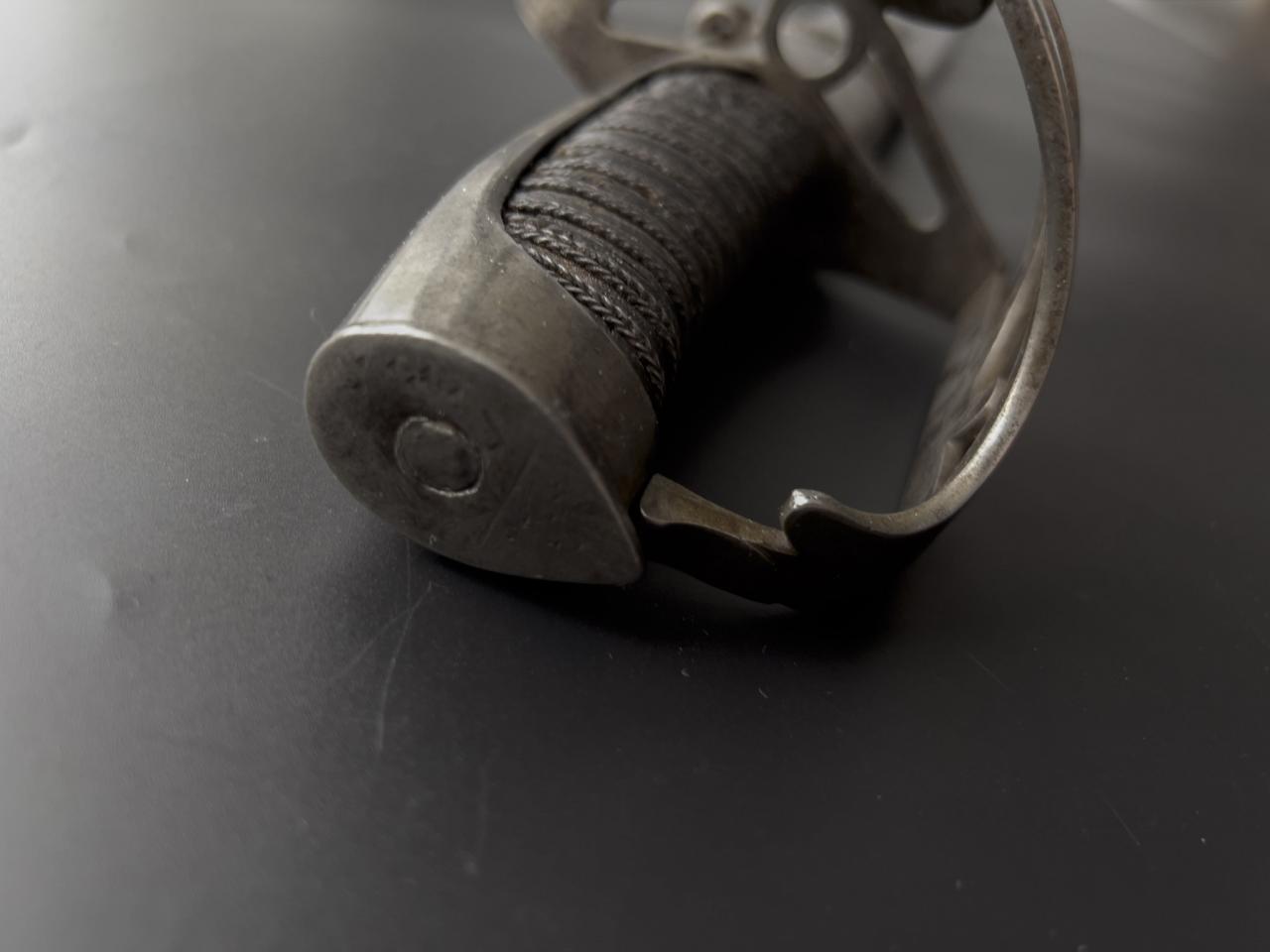

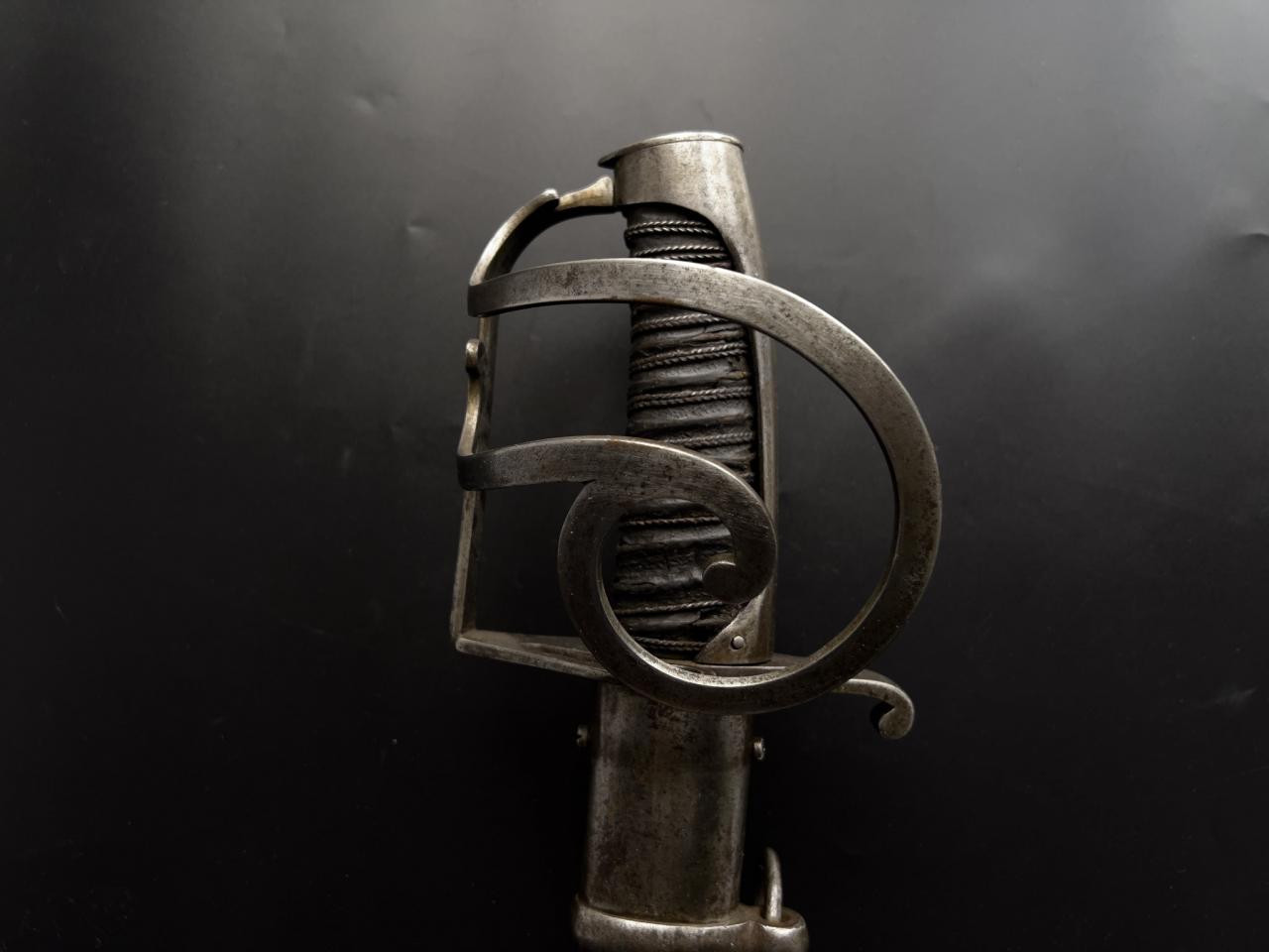

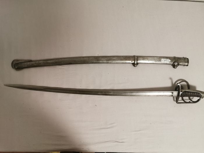

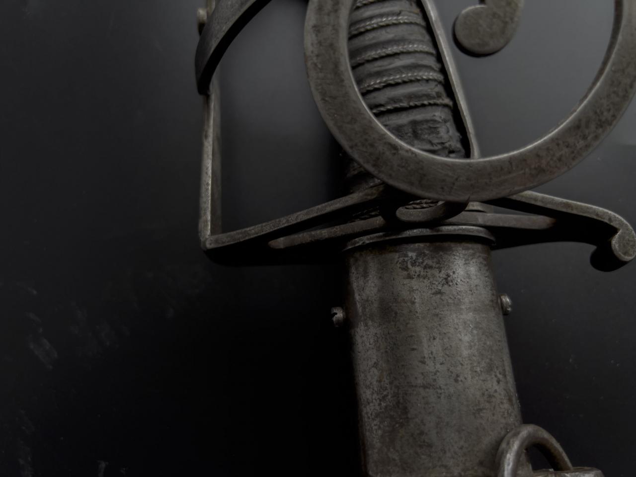

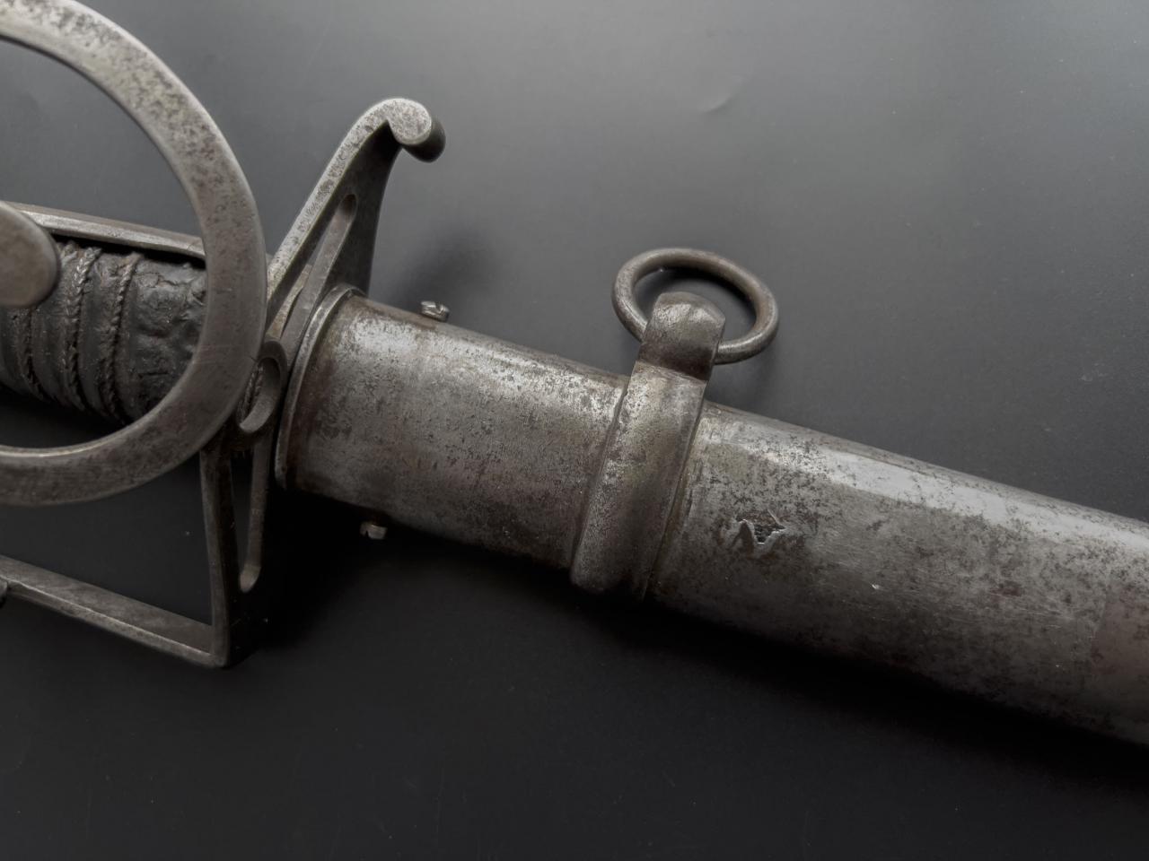

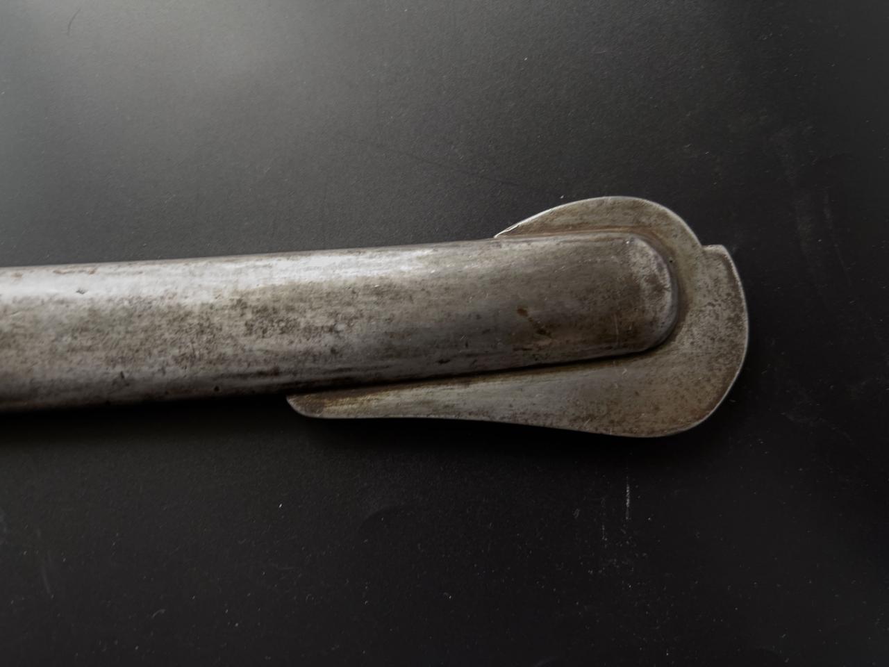

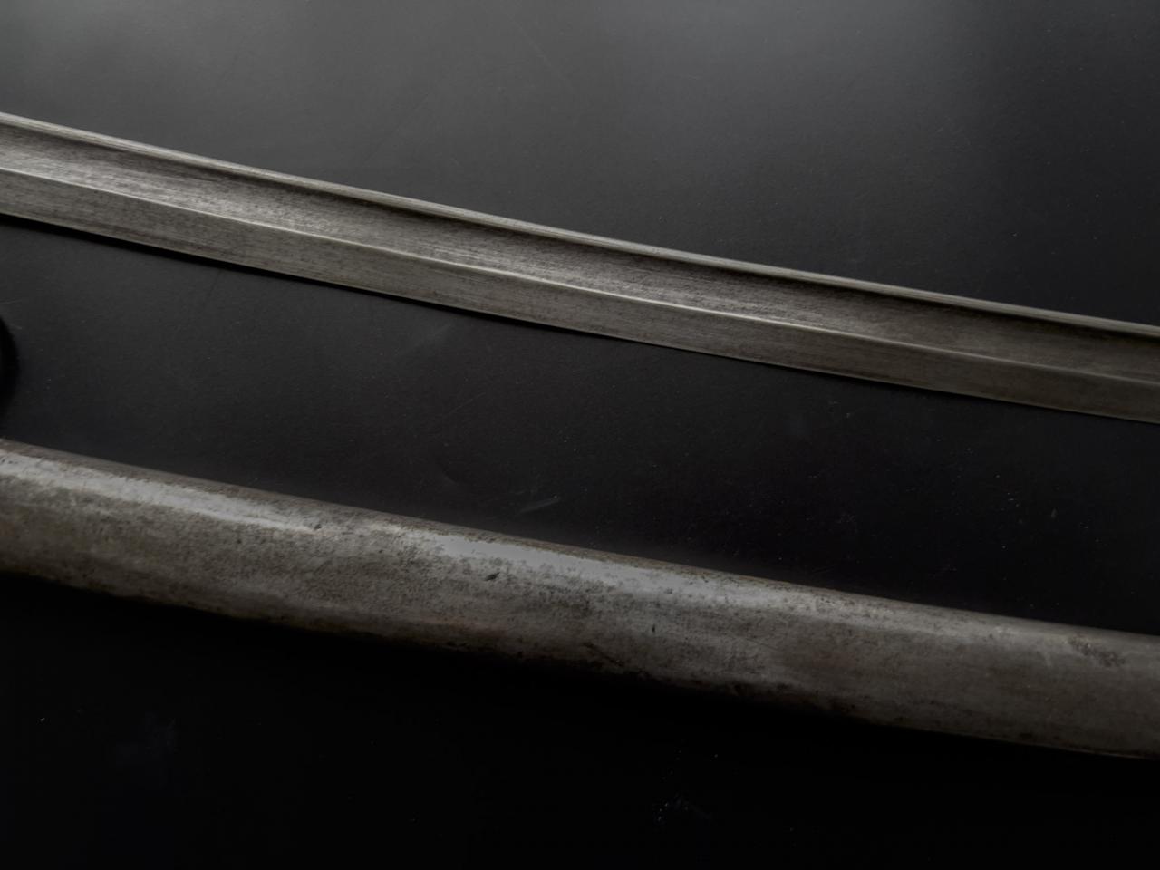

Hello. finally took the saber and took good pictures. I want to share with you, it seems to me that the scabbard is completely suitable for this item and there are no traces of the blade being re-sharpened under the other scabbard.
