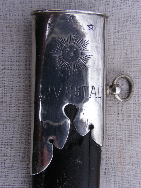

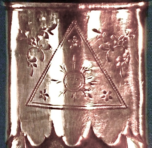

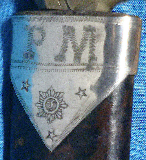

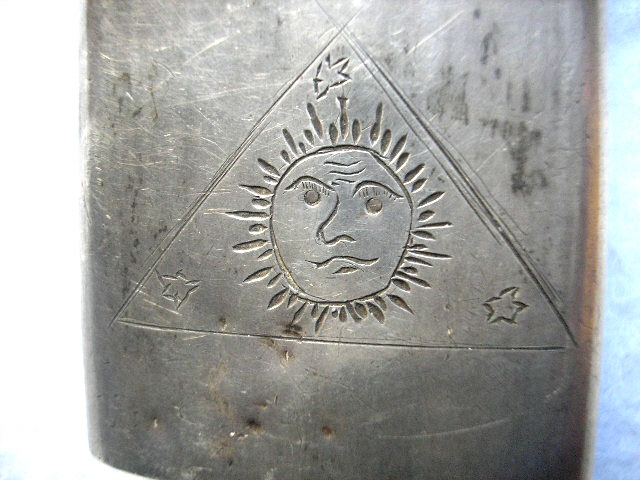

The short lived 1st Philippine Republic 1899-19001 used a symbol of a rayed sun in a triangle with a star above at the point. Their sun had 8 rays and the stars were pentagonal, but one could allow for artistic license. What's under the red cloth strap?

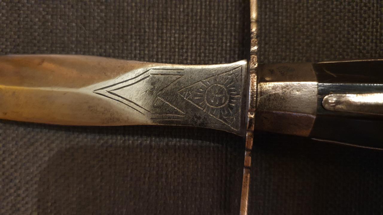

I think Wayne is correct, it could very well be a Katipunan symbol, compare!
Old 1st November 2021, 06:16 PM   #5
Posts: 7,286
Well, the sun in the triangle used by the 1st Philippine Republic was always a full sun in the triangle, wasn't it? Not a partial sun on the horizon. And it os generally surrounded by 5-pointed stars, not a six-pointed star. So i am not convinced that is the intended significance here.
