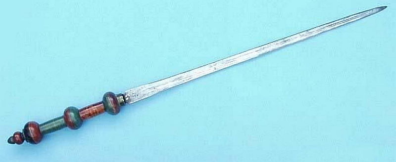

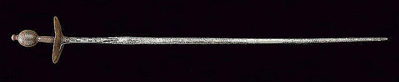

A picture always helps for us novices...The two gentlemen mentioned above are apparently Sikh Nihangs.

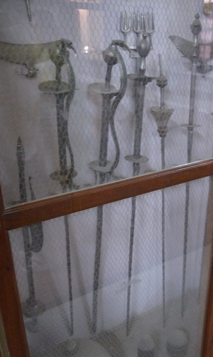

Unfortunately, or rather fortunately, not everything is so simple. This sword had a name. So far, we can say for sure that it is very likely that such a sword was used by "Banabaz" troops by analogy with "Shamshirbaz". The point is, in order to accurately understand the term (and the subject itself), it is necessary to understand the etymology. Even now, the names of objects are not given without any meaning ("smartphone" f.e.) especially in ancient traditional culture. I would not like to publicly voice something that I am not completely sure about, it takes time to clarify this, but it is very likely that in India such a sword was presented as consisting of two parts and and could be named by analogy with how "an arrow" could be named by the name of one of its parts.

Wayne, thank you for the illustrations! As always, especally in this case, a picture is indeed worth a thousand words!!!
Most collectors strive for concise and exact categoric descriptions, and this is perhaps the reason behind the plethora of 'collectors term' that plague the serious study of ethnographic arms. As you well point out, 'it is not quite so simple'.It seems however that while scholars in these studies of course seek more accurate and proper terminology, collectors and the general populace go for a term that serves collectively in their own vernacular.
In following your use of analogy, take for instance the case of the Sudanese 'kaskara' broadsword. Years ago studying these I was surprised when I discovered that in virtually the entirety of regions using these swords, this term was NEVER used to describe it, only (as in many Arabic speaking areas, the word sa'if was used). Using that term to speak to locals was pretty much useless. Years later we found that the term was from tribal dialect in regions west of Sudan, and in my opinion likely entered the collectors lexicon with Sir Richard Burton (a linguist, "Book of the Sword", 1884) to describe these.
Simiilar dilemma occurred with the 'katar' situation, which seems to be generally held that Egerton (1885) transposed the term from another dagger to the transverse grip 'jamadhar' (as per Pant, 1980), thus, again, entering the collectors lexicon accordingly. While most of us know the term is technically incorrect, the the sake of expediency, we use 'katar' in discussion and descriptions.
In that convention, it seems that mel puttah bemoh serves for the same purpose, while more etymologically and linguistically proper term will hopefully be added to the scholarly literature as research develops into conclusions.
Wayne, thank you for the excellent illustrations! As said, a picture is worth a thousand words, especially in these kinds of situations!!

You are welcome, Jim. I note in Mercenary's photo a pair of these two handed weapons that have a snakelike double finger guard, each 'wiggle' protecting a section of grip below the corresponding disk guard, I'm assuming for parrying. (And an elephant proboscis 'hook' on the pommels)
