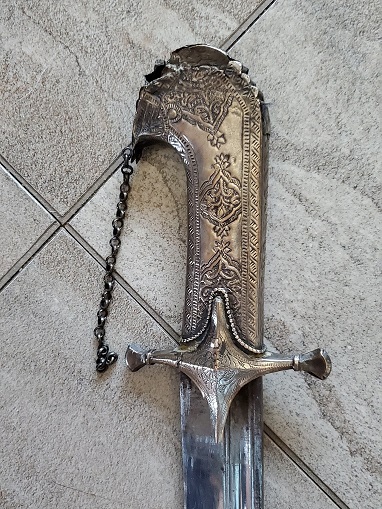

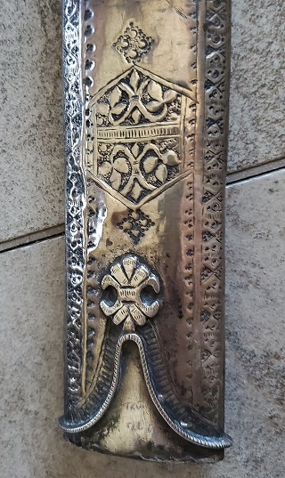

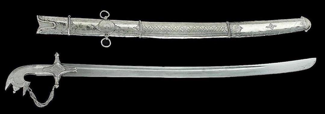

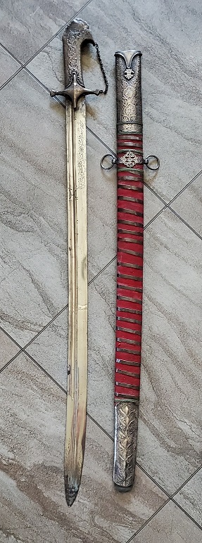

Greetings folks!
Well I got this saif (on my wish list) and I am wondering if it is from Yemen or Hyderabad India for the Yemeni market.
My suspicions come from 3 things:

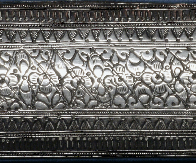

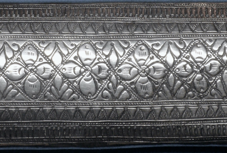

1. the type of flower motif on one side of the silver scabbard
2. the type of flower motif on the other side of the scabbard

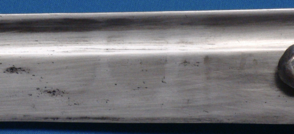

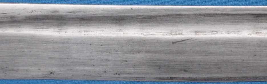

3. the type of pattern weld that is indicated on the blade
What are your thoughts?

First of all, congratulations on this extremely nice saif. Your observations on the flower motives are accurate and supported by both Elgood and Hales. Both authors state that while these swords were used in Southern Yemen, many of them and especially the nicer ones were made in Hyderabad. Have you tried bringing out the pattern on the blade?

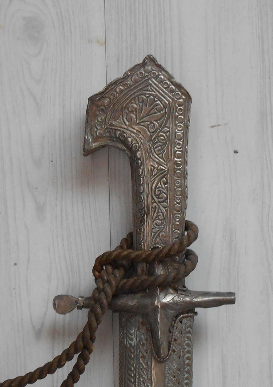

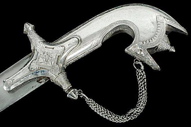

As far as I have understood from Robert Elgood, this type of sa'if was well known in Hadhramaut, which is technically the eastern part of Yemen to the Oman border. Apparently these regions often furnished mercenary forces to Hyderabad, thus the significant connections which may account for the popularity of this silver work from artisans there.
These sa'if had the canted triilobate pommel as seen on this wonderful example posted, as well as the 'karabela' type, which I have attached.
While these seem typically regarded as latter 18th century, their use seems to extend into early 20th c. and whether the hilt forms were contemporary to each other is unclear, perhaps simply matter of personal preference.
In any case, a form not often seen available to collectors, so outstanding score Jose !!! Merry Christmas!!!!!

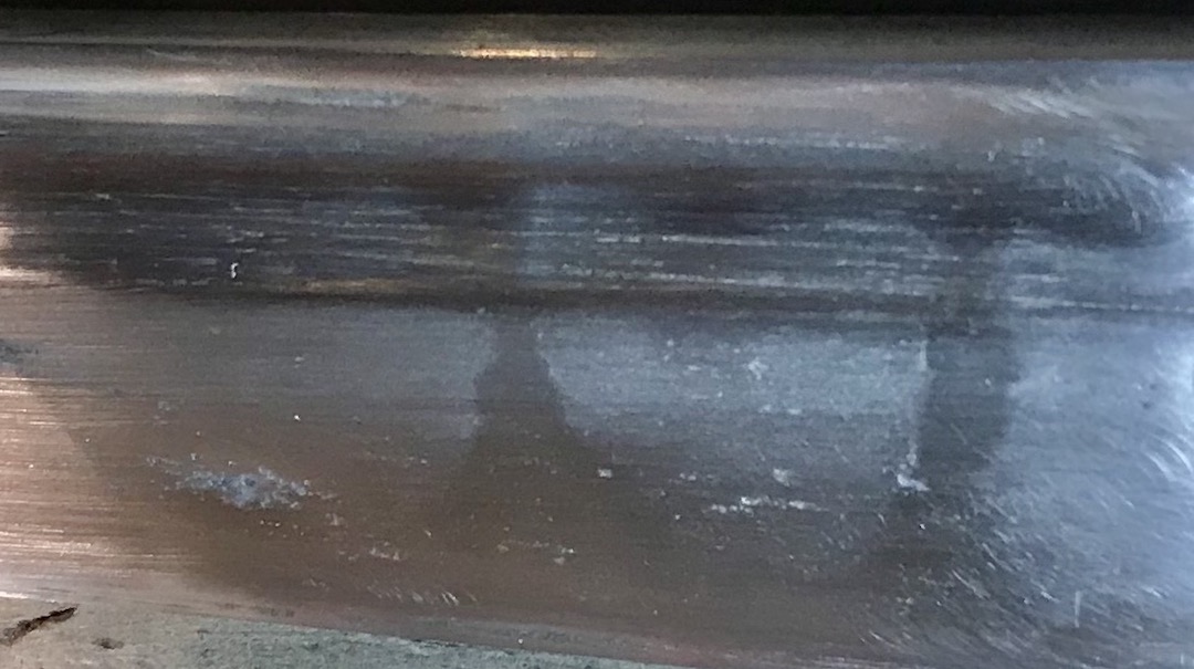

TVV - I did etch it and the patterns came out even more starkly reminiscent of some types of Indian pattern welding. (see picture).

This is a very good example and it is in excellent condition. Congratulations for this quality piece!
From the photos you posted I am not sure the blade is pattern welded. Most blades of this kind of saifs are not pattern welded.
The apparent pattern may be because of lamination, heat treatment but in this case more likely because of former contact with oxidizing agents. However, it is difficult to say from the photos.
The blade is already well cleaned but with rather coarse scratches. So I think the blade may benefit from some finer polishing 1000-2000 grit. I wouldn't attempt to completely remove the scratches but only to give it a finer and more uniform appearance. By doing this, the structure of the blade may become more apparent.
PS: I consider pattern welded, a laminated structure composed of two different steels that etch in different tones so as to display a specific pattern.
So if a blade is made of multiple layers of the same steel (like the Japanese blades for example, or like many Indian blades) it is laminated, but not pattern welded.

I have seen a few saifs of this type and a common feature seems to be that the blades are highly polished, but not well polished. Scratches are usually present.
The answer may be that this saif was made in Hyderabad for the Yemeni market in Hyderabad. I have no idea whether or not such swords were exported to Yemen or were brought back to the Yemen by returning Hadhramis.

After etching it to see the laminations I re-polished it but not finely. I will put the final polish soon.

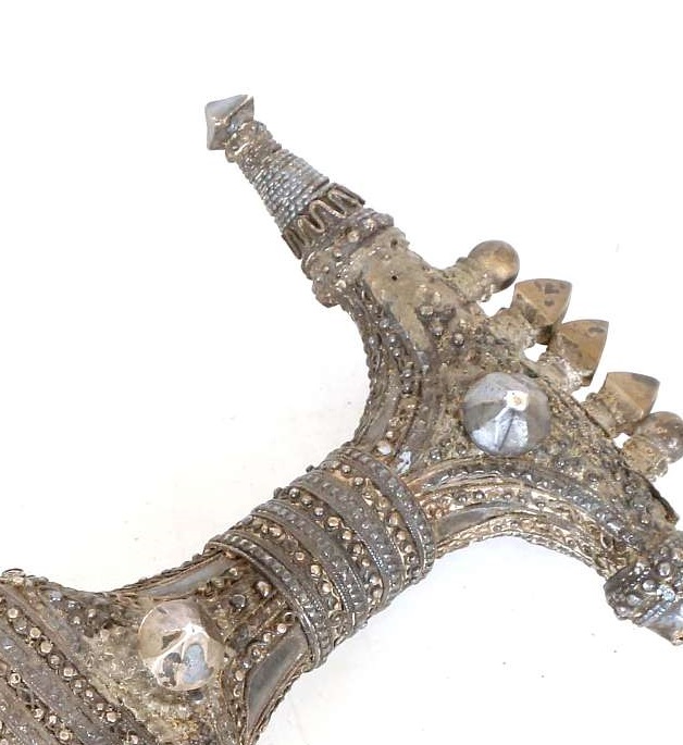

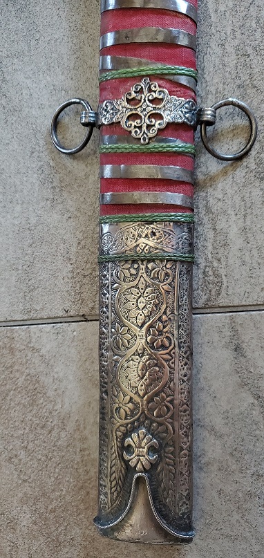

Please Jim, look at the pommel of this zaibidi jambiya extremely similar to the quillon of the sword discussed.

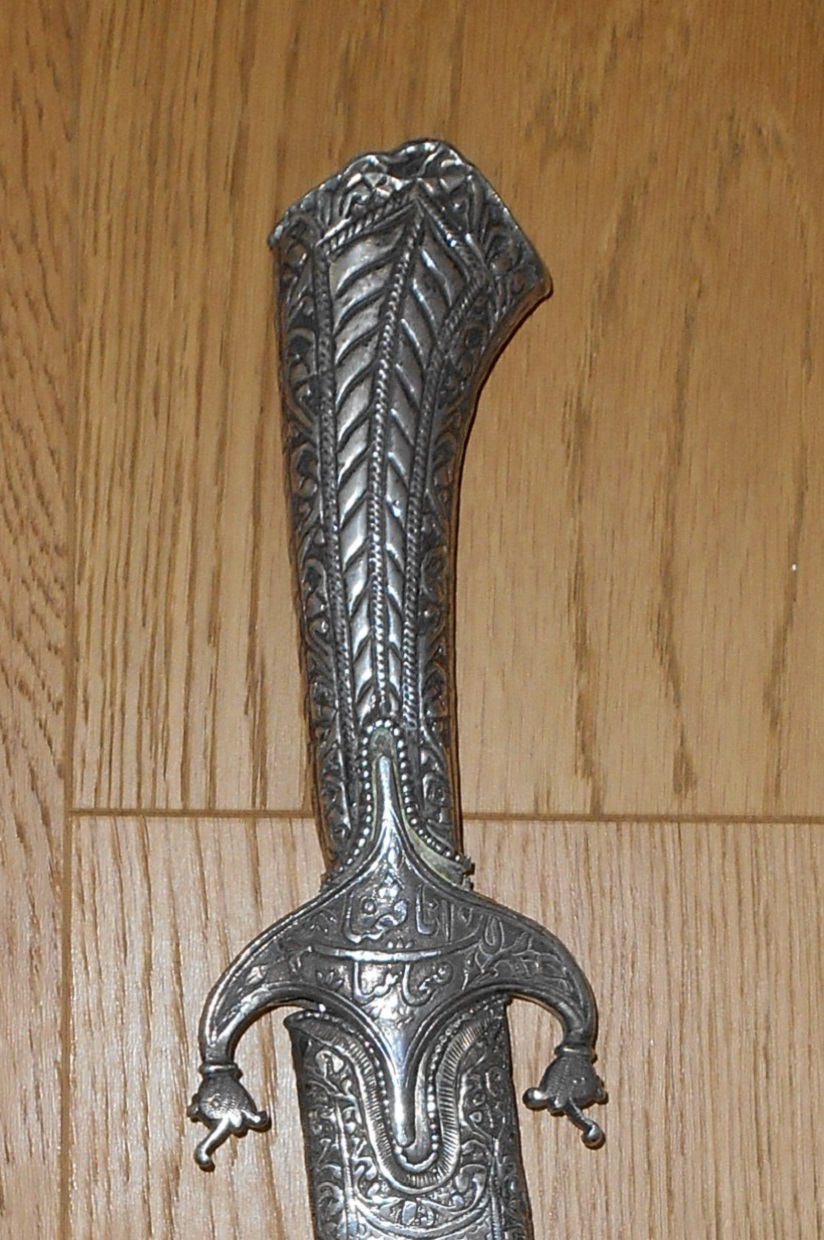

For Ariel, of course I agree, the Yemeni karabela is from Ottoman origin, here I post my Yemeni karabela and my Persian Zand karabela for comparison.
