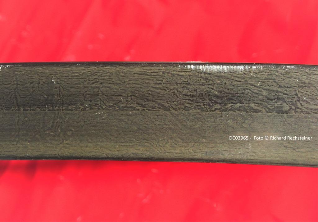

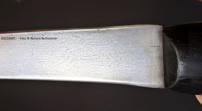

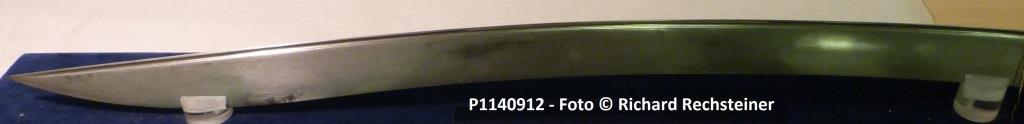

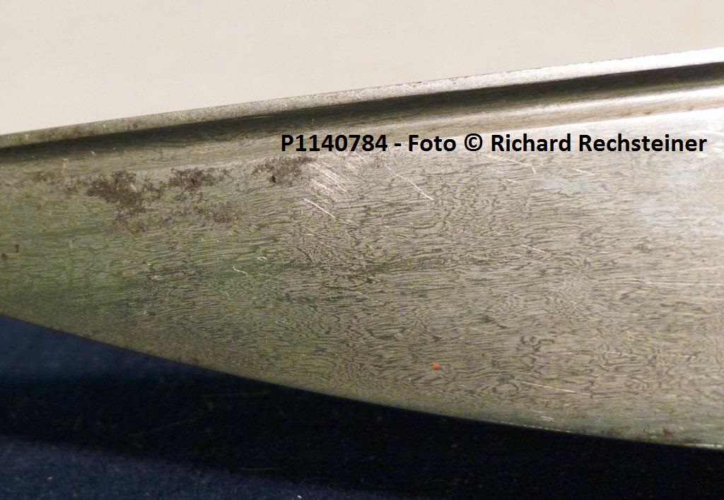

Hi,
I bought this supposedly Russian Yataghan with a bulat (wootz) blade some years ago and would like to ask your opinion about dating an origin of this weapon.
The” Damascus Pattern” on the blade changes depending the light and angle looking on it.
Kind regards
Richard R.

Posts: 1,166
Bulat is hard to fake and the metal mounts look righteous, so personally I think the important bits are right.....As for the rest I await comments. I would like a better pic of the whole piece.

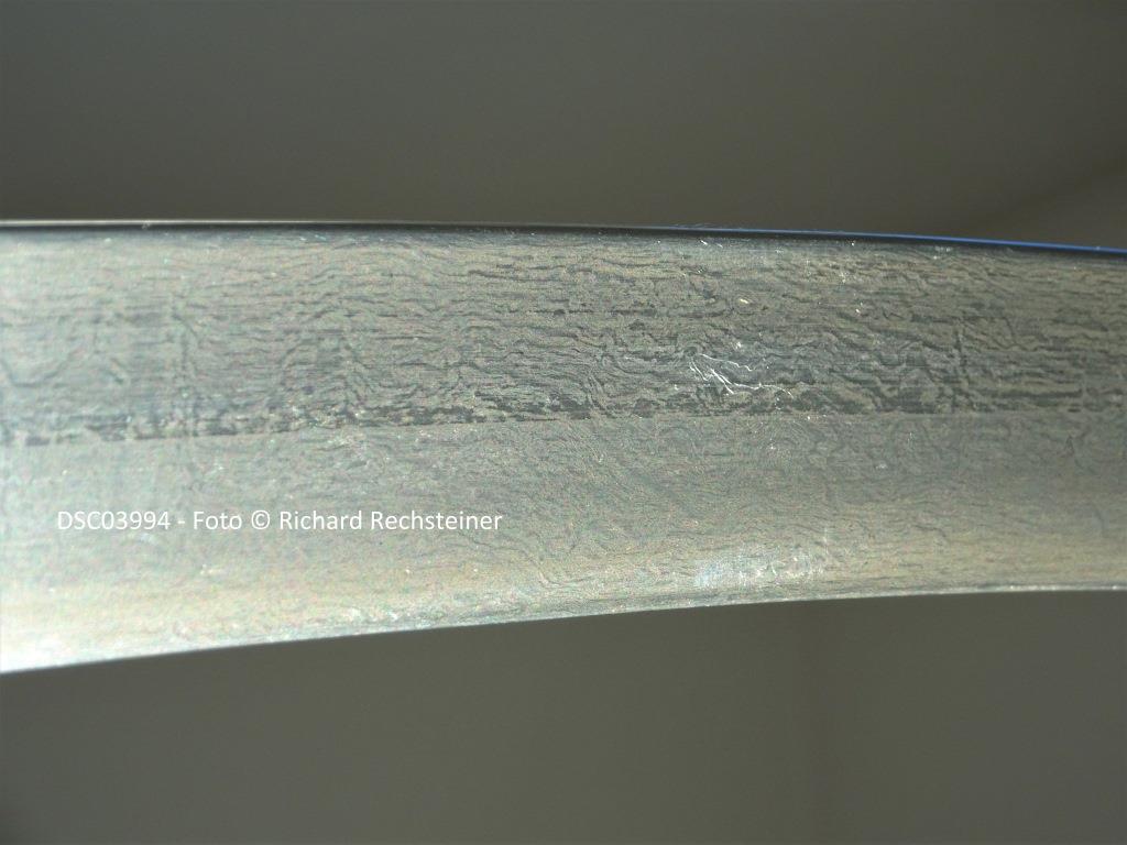

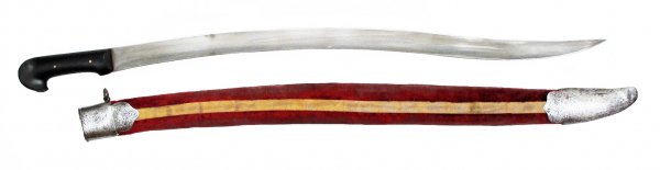

Here some additional pictures.

Old 18th November 2020, 11:00 PM   #4
Kubur
Kubur's Avatar
Posts: 2,145
Very Indian to me
But to be safe I would say at 99.9% in a triangle between India, Afghanistan and Uzbekistan.

Agree with Kubur: the blade is not Russian, but +/- Central Asia / India.
Anosov, alleged re-discoverer of Bulat, had some blades made. All of them were rather pitiful renditions of Shams, even though he claimed to reproduce tabans and khorasans. He got the instruction how to make Bulat ingots, but the mastery of forging them was well beyond him. Russian metallurgists and historians darkly comment to this day that there are still unseen examples in Russian museums, but that they are so secret that cannot be shown. At the very least Anosov is credited with a discovery that Bulat is an alloy of iron and carbon, nothing else. But even that is not true: Faraday knew it years earlier and tried to simplify the process by adding various other element .
After Anosov’s death, his former Zlatoust colleagues got hold of his written recipes and tried to create Bulat ingots. Nothing came out of it.

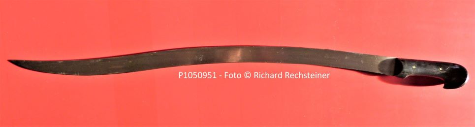

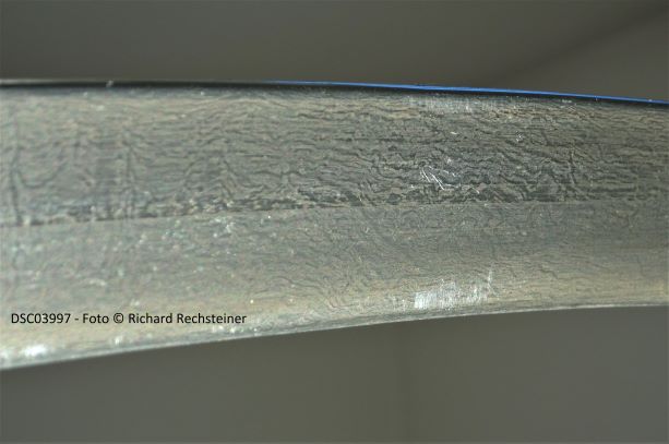

Richard R.
Join Date: Dec 2011
Posts: 27

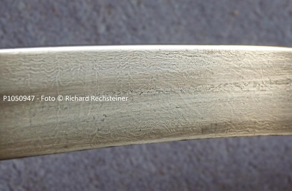

What about this Yataghan wit Damascus-Pattern, also Russian or +/- Central Asia or Indian?

Old 20th November 2020, 02:28 PM   #7
Why Russian? Markings? Inscriptions?
I am unaware of any old Russian Bulat ( wootz) blades with a pattern more sophisticated than shams , and even those are rarer than hen’s teeth.
Contemporary Russian smiths can produce only short knives( except for Zaqro Nonikashvili, but he is from Georgia).
I have seen some old composites with Oriental blades and Russian decorative additions.

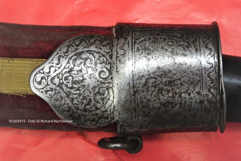

This first shown Yataghan has been described by the auctions houses Bonham London and Auctions Imperial as follows:
“A RUSSIAN YATAGHAN, 19TH CENTURY:
With watered recurved single-edged blade, and characteristic 'eared' ebony grip secured by two transverse brass pins, in original wooden scabbard covered in red velvet (worn) with iron locket and chape each etched with designs of symmetrical foliage on the outside. Overall length is 33.5 inches - Blade length is 26.5 inches.”
“AN IMPERIAL RUSSIAN SABER SHASHKA:
A very rare example, typical of Zlatoust Arms Factory special order work for officers during the Caucasian Wars. The hilt carved of a single section of black horn, the gently recurved, single-edged blade forged of fine Russian bulat wootz steel as developed by Pavel Anosov at Zlatoust in 1838. The wooden scabbard covered in red velvet with gilt braid, the steel mounts etched in motifs characteristic of Zlatoust. Mid-19th century. Some wear to mounts. Overall length 84.8 cm, blade 67.5 cm. Officers serving in the Caucasus often acquired or had local weapons copied. This example combines the hilt of a shashka with a blade of yataghan form, a type encountered in Georgia; however with refinements which improve upon the original by allowing it to be used, not only for cutting, but for the thrust so popular among Russian soldiers.”

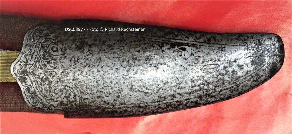

What about the scabbard? For me it doesn’t look Indian.
Richard R. is offline   Reply With Quote
Old 21st November 2020, 06:45 PM   #9
Kubur
Kubur's Avatar
Posts: 2,145
The first one has a North Indian scabbard or with Afghan fittings.
I can't say nothing about the second one as you showed us only the blade...

While it is very difficult to judge from the photos, the blade of the first example appears to be pattern welded and not wootz. And even if it is wootz, it definitely does not have the fine watering of antique wootz but looks more like modern sham.
PS: I know of a Russian blacksmith who can make some pattern welded blades with watering extremely similar to wootz. I have seen one of his steels in a sword of Gotscha Lagidse and I was quite convinced it was wootz.

Regarding the sword in the original photo, I see no indication pointing towards Russian origin.
Why "yataghan" and why not "sousun pattah"... and...
... why Russian and not Indian?!
The scabbard looks very Indian to me.

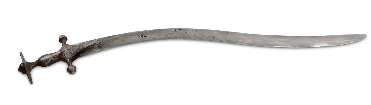

Also the blade looks very Indian as I have seen almost identical sousun pattah blades with the classic tulwar hilt (see Kubur's example).
So I suspect the blade was re-hilted... just to confuse us.

Anyhow, when I say "wootz," I mean a crucible steel characterized by a pattern of bands that are formed by microscopic carbides within a tempered martensite or pearlite matrix in higher carbon steel, or by ferrite and pearlite banding in lower carbon steels.
And the patterning in the sword of the original posting does not appear to come from the micro-cristalline structure of the steel (like in the case of wootz) as the bands appear to be too big and too uniform/directional.
