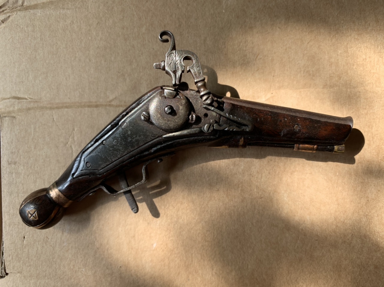

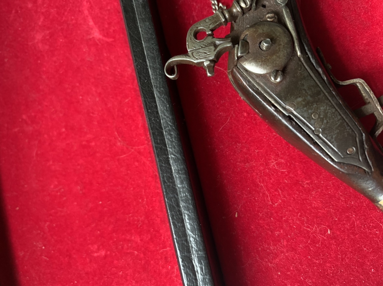

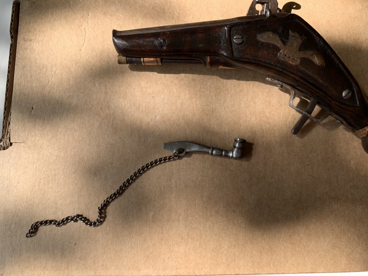

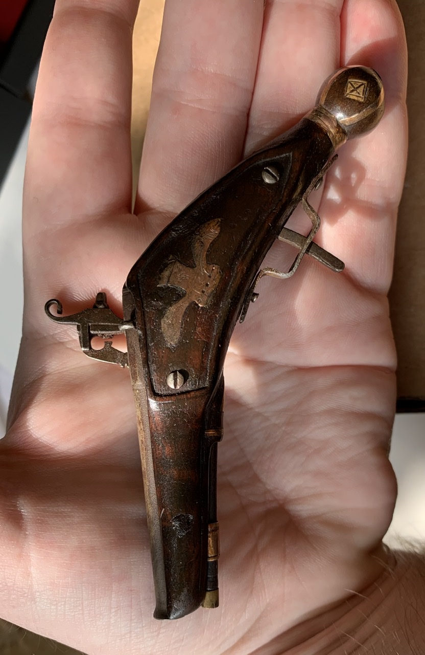

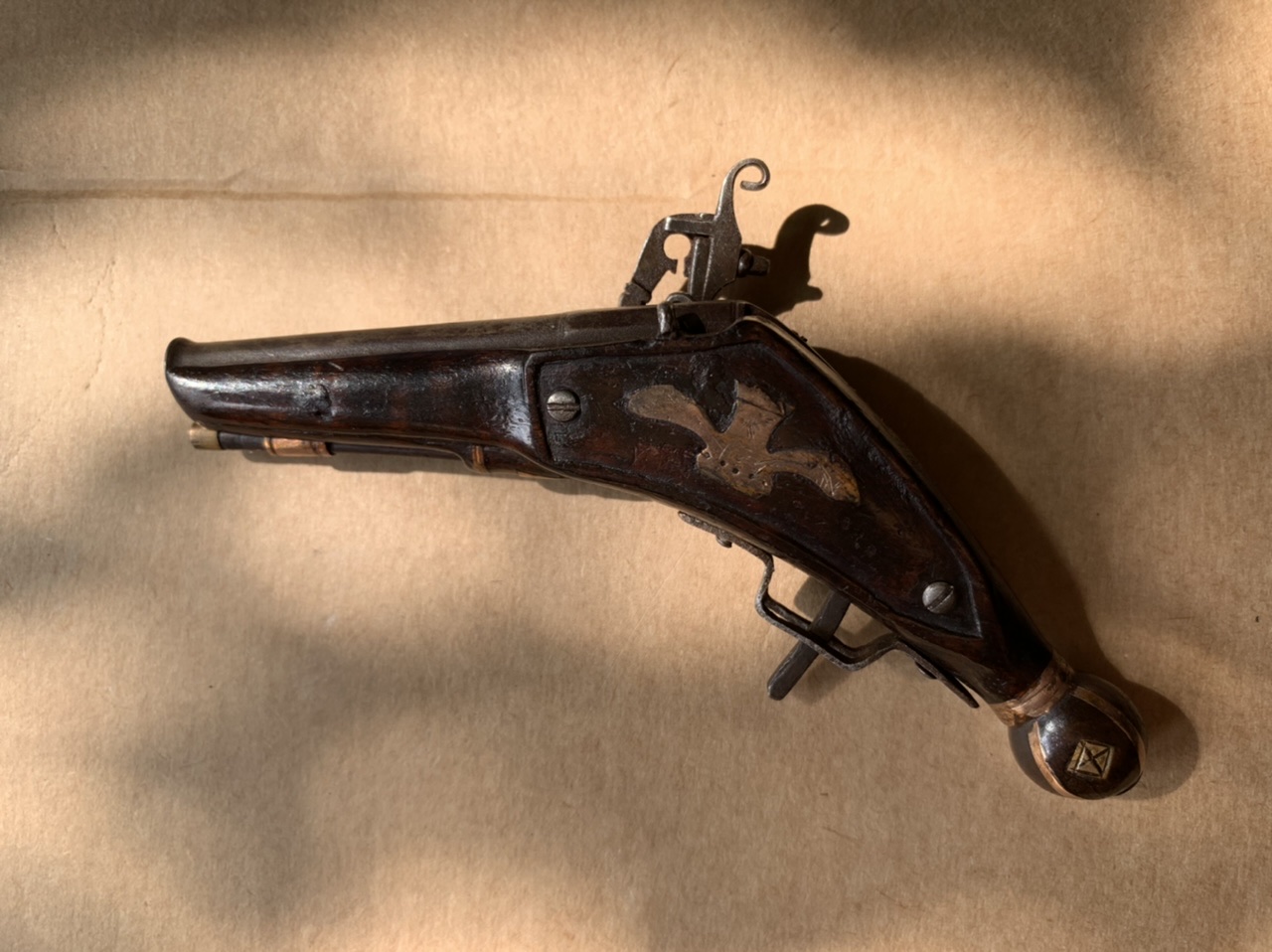

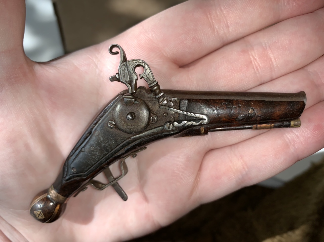

I’ve recently acquired what looks to be a period late 16th/ early 17th century ball butt miniature wheellock, it’s stock is made of burl walnut and I was just wondering what your opinions on it are as I’m not an expert and just wanted to know if you think it is authentic for the time period.

I know this miniature since a very long time and I would have bought it when I would have been sure that it is an original................

A good help is to check the threads of the screws, they should not be the same as those in use today

See that’s what I thought but I’m afraid to unscrew any in case of any unnecessary damage but I’ve inspected the heads of the screws and they don’t look machine made but hand made and an in uneven recess on the head

Old 1st May 2020, 08:18 PM   #10
Fernando K
Join Date: Apr 2010
Posts: 672
Now that I look more closely, I see that the screw that closes the jaws is barely enough to keep these jaws closed, without pyrite. When taking a pyrite, its travel is not enough.

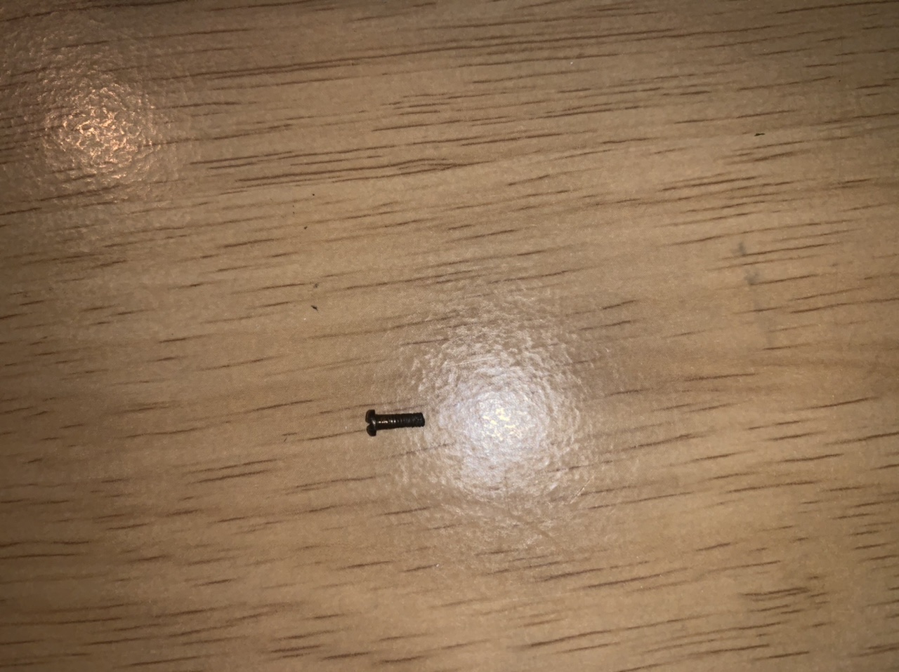

Old 1st May 2020, 09:26 PM   #11
wheellock95
Join Date: Apr 2020
Posts: 46

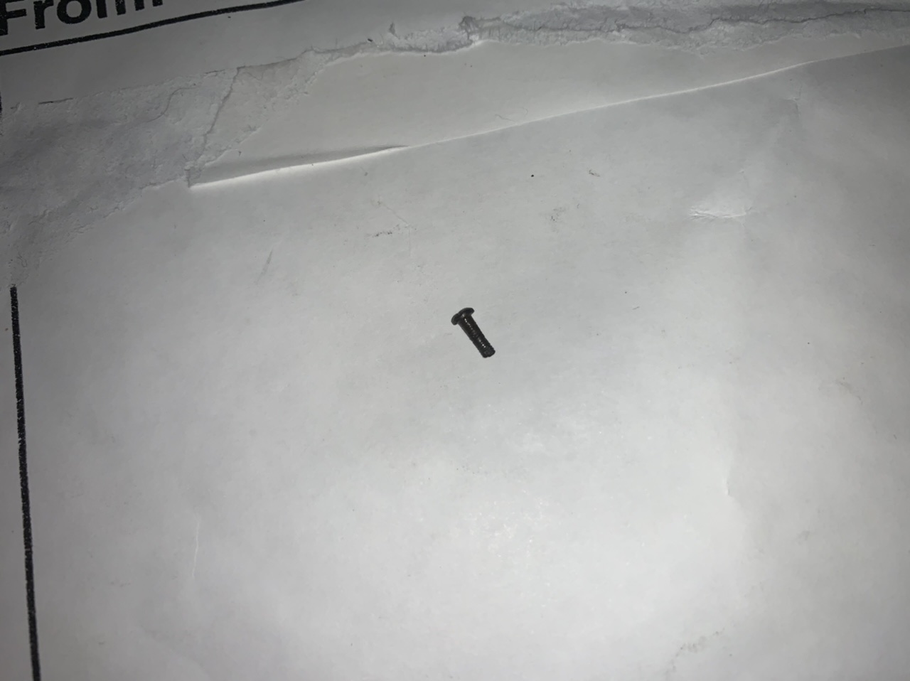

Here’s a picture of the screw that holds the dog in place

Old 1st May 2020, 10:13 PM   #12
Fernando K
Join Date: Apr 2010
Posts: 672
Hello
With the photo we do nothing, You have to use a thread gauge, to know if it is metric or whitwort and the diameter of the screw, and see if it matches any of the standardized types.

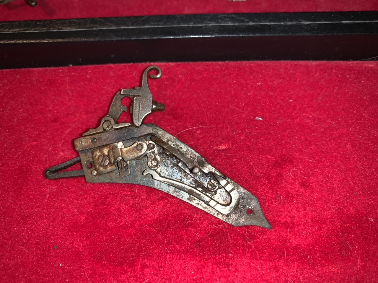

Old 2nd May 2020, 05:15 AM   #15
wheellock95
Join Date: Apr 2020
Posts: 46
Here is the lock
wheellock95 is offline   Reply With Quote

Can you also trim the picture of that screw, as to obtain a bigger image of it ?

I have tried cropping the image of the screw however when I do that the file size is too large and it won’t let me change it so I can only change the original photo file size and it’s the largest option

Fernando K
Join Date: Apr 2010
Posts: 672
Hello
It seems to be fully functional, although the pan lid lacks a spring that holds it in place, it has a single catch, when the bigger guys had two, and so the subject of the shot is different. It also differs in the fixing of some parts by forging and riveting., But it is very difficult to establish a manufacturing date, which must be done by comparing it with existing specimens.
