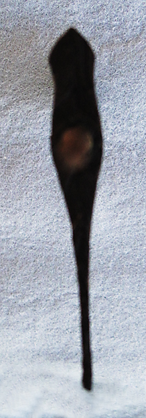

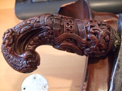

I live in Seattle Washington area, USA. I normally buy and sell straight razors, and sometimes knives as a hobby. I recently bought a group of razors from the previous owner's grandson. He also had a lot of interesting knives that I ended up buying, only recognizing a few, taking a gamble on the remainder.
At first I passed this off as a tourist piece, not knowing anything about the keris. Looking later I found the date of 1848 on the hilt, which pushed me over the edge into researching the keris. I sent pictures to numerous people I found on the Internet and eBay, got back some good responses. A dealer in Indonesia gave me the most detailed opinion, which I will share. (I do not know if he is a member here or not.)
Madurese Donoriko hilt, the date looks authentic.
Blade - Tuban period,
Pamor - Ngulit Semangka
Warngka - Ladrang Jawa Timuran style
The keris is 20" long with a 16" blade.
I have seen many different blade patterns and finishes but few if any similar to mine. Does mine need to be treated somehow to recover the original finish? Or is it the original finish?
He mentioned how the wrangka is replaced when needed, on the Suroan ceremony. The sheath has some missing wood but I would like to keep the hilt. Is there a location in the US where I could get this replaced in a traditional manner?
I have spent many hours poring over this site but my language barrier prevents it from sticking very well..
I appreciate any and all comments,
Brad

Made that picture of the crest a bit bigger .

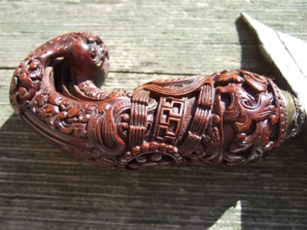

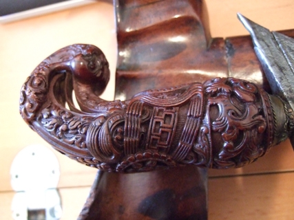

Default more pics of the hilt
My first thought was that the hilt was plastic...

A lovely maduran keris to start with. Congrats on this find. I would leave the dress as it is. If possible the blade could be etched in the traditional way with warangan.

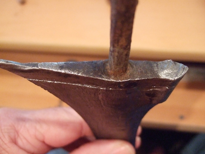

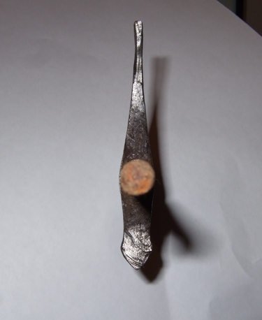

Would it be possible to provide a photograph looking straight down onto the base of the blade, as in the example I have posted?
Blade classification , or tangguh, is only an opinion, and it is an opinion that can alter according to the school of study with which one is associated. It can give an indication of blade age, but except in a few very limited contexts, it cannot give a true blade age.

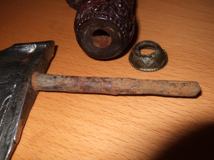

In your picture it appears that the hilt has been removed? What is the best way to do that without damaging it?
Is there someone in the Pacific Northwest region who could restore the blade? I have read the process but do not feel comfortable doing it myself just yet.
schmoozer is offline   Reply With Quote
Old 24th February 2010, 12:05 AM   #7
Hello Brad,
Yes.
http://www.vikingsword.com/vb/showpo...35&postcount=3
Won't be easy to find someone in the US (and elsewhere). Several members are working on blades from their collections.

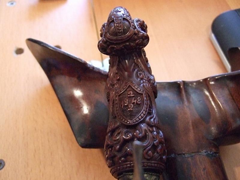

Old 24th February 2010, 12:07 AM   #8

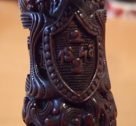

Isn't that 1948?
Looks like good quality carving though.
Old 24th February 2010, 12:14 AM   #9
Posts: 7,284
Originally Posted by kai
Isn't that 1948? Looks like good quality carving though.
It is hard to tell given the angle that the photo was taken, however, i don't believe that the date (if it is a date) can be taken as an actual date of creation in any case.
It is both an unusual and nice carving though.

1848, new picture.
OK, so I get it off and take the picture.
How do I reattach it?
Probably won't get to this until the wekend...
Old 24th February 2010, 12:27 AM   #11
Posts: 7,193
Very often a hilt is simply a pressure fitting, where the tang is wound with thread, however, sometimes an old hilt can be difficult to remove for one reason or another, so I suggest that if the hilt will not turn off fairly easily, that you don't force it at this stage, just provide a couple of pics where we can see the shape of the gonjo on either side of the hilt. That should be sufficient.
The re-stain process can be a bit difficult, and to do it properly, you need a pretty high committment as well as access to arsenic, however, you may find that if you remove the hilt, give the blade a thorough wash with a toothbrush, hot water and detergent , then soak in ordinary household vinegar for a day or so, that you will be able to see the pamor clearly. It won't be as good as a proper restain, but it could well serve the purpose for you. Make sure to kill the vinegar by painting on a slurry of bicarbonate of soda, rinsing thoroughly and drying thoroughly, then drench with WD40 when you're finished.
A. G. Maisey is online now   Reply With Quote

A very nice well made rather old and unusual handle. Without doubts a very good carver

got it off, some old wrapping around the tang.
Once I got it off I noticed there is a definite offset in the axis of the tang and the blade. I read that the blade was supposed to point slightly downward when held level? If that is so, I think maybe my hilt was on 180-degrees off?
That level of cleaning I am up to...

We really need to look straight down onto the top of the gonjo, because the angled shots do not always give a correct impression of the outline or the proportion.
We need to see the shape of the thick end of the gonjo (the sirah cecak), but we also need to see the outline of the top of the gonjo between the tang and thin end of the gonjo.This is important, because if there is even the slightest inward curve in the line of the gonjo here, it is not Tuban.
Can you confirm that the line along the sides of the top of the gonjo, between the mid-point of the tang, and the thin end of the gonjo does not have any curve in it?

new view

Anyone care to take a shot at what that silver material on both sides of the top of the gonjo might be? Remnants of some sort of silver "kinatah".
Old 24th February 2010, 04:56 AM   #17
Posts: 7,193
Thanks schmoozer, that's great.
This cannot be a Tuban blade.
The length of the gonjo from the pesi (tang) to the buntut urang (narrow end of gonjo) is too great, there appears to be a very slight curve in the side of the gonjo, and the buntut urang itself is the wrong shape for Tuban, additionally, many would not accept the sirah cecak form (wide end of gonjo) as Tuban.
I am not prepared to give a classification on this blade from a photograph.
David, I think that that material may be the remnant of a separate layer that once covered the top of the gonjo; it has eroded and broken away. I've seen this type of construction a number of times, sometimes in a pamor that matches the blade, sometimes in plain iron in order to conceal the pamor.

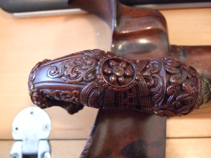

I dug this up talking to Brad in PM about dated hilts. The only other one i have seen was posted on this forum some time ago. Same kind of number orientation with a number both above and below the "year", if it is a year. We didn't really come to much conclusion on that one either.
http://www.vikingsword.com/vb/showth...ght=date+keris
