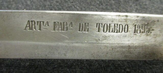

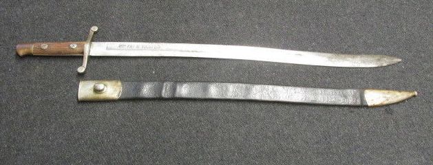

the std. spanish 1895 issue infantry/artillery sword, yataghan shape, made in toledo.
(mine below)

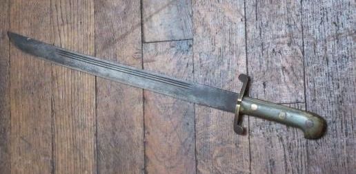

they also used a lot of machete style swords, like my straight pioneer knife/ faschenmesser also below. the yat is supposed to be a bring-back from the spamam war april to august 1898 (san juan hill was in july). the pioneer may also be as it came from a dealer in florida, USA.

Which is the connection between the posted German made machete and your Toledo Yataghan; not the model, not the maker; perhaps the battle ? .

the war. the machete/messer was sold from germany to spanish speaking american countries for their militaries. the person i bought it from in the states i gather he'd got it from someone with cuban connections and had assumed it may have been around for the period of the spanam war. it is shown here as an example of the military's tools/secondary weapons of the spanish in the period of the war.
