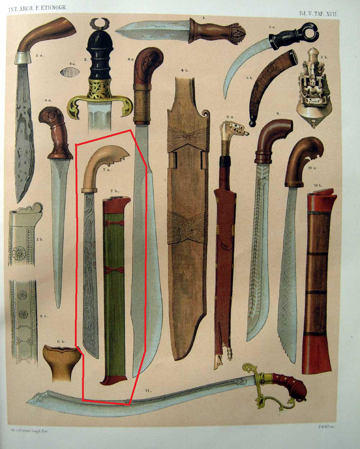

I saw this discussion but I wasn't sure of the name because the blade is different from the illustration.
On the complete plate of Schmeltz we can see a blade much closer to my parang (and yours) with a simpler handle.
This is n°9, Do you have the explanation of this plate to know the name associated with blade n°9?

Sorry, I don't own Schmeltz, I've taken the picture from an old thread. Here is another good thread about this swords: http://www.vikingsword.com/vb/showth...light=Schmeltz
Old 14th July 2017, 07:56 PM   #6
Here for the others the complete plate. I think that No. 9 is also a parang kerekoepang but I am not sure.
