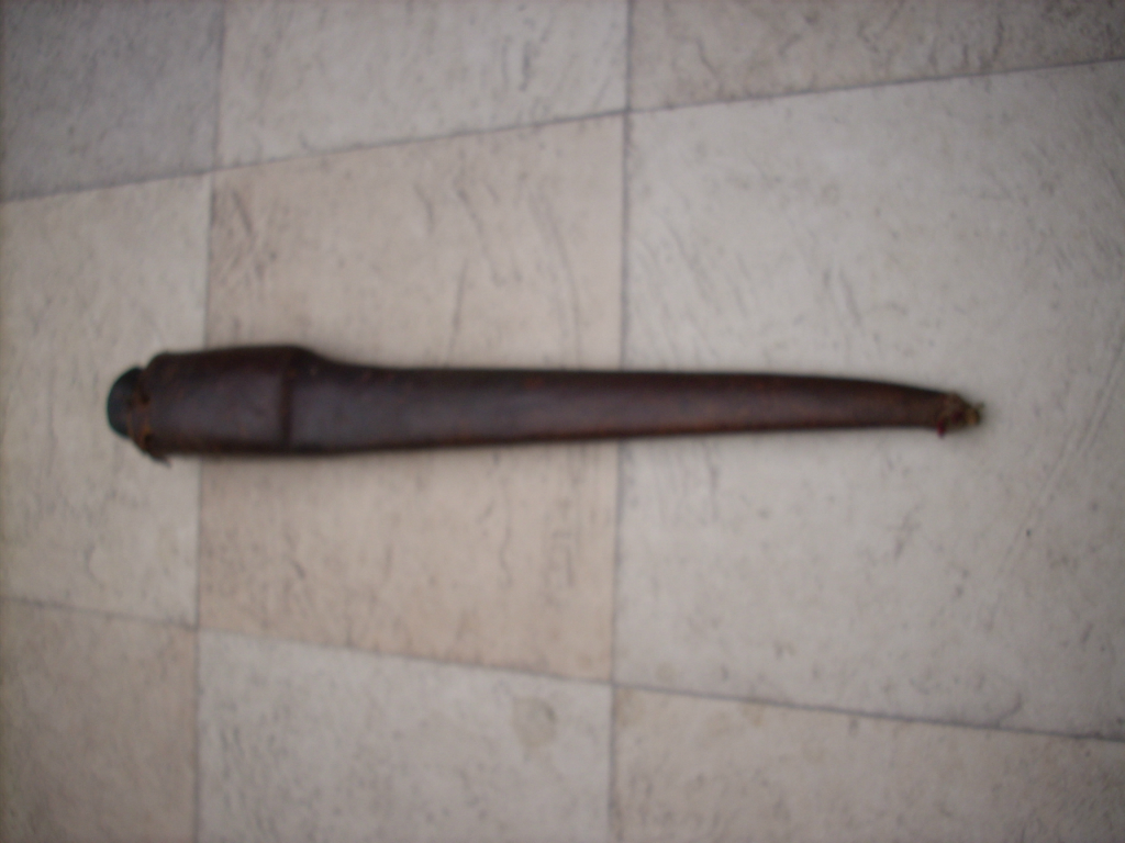

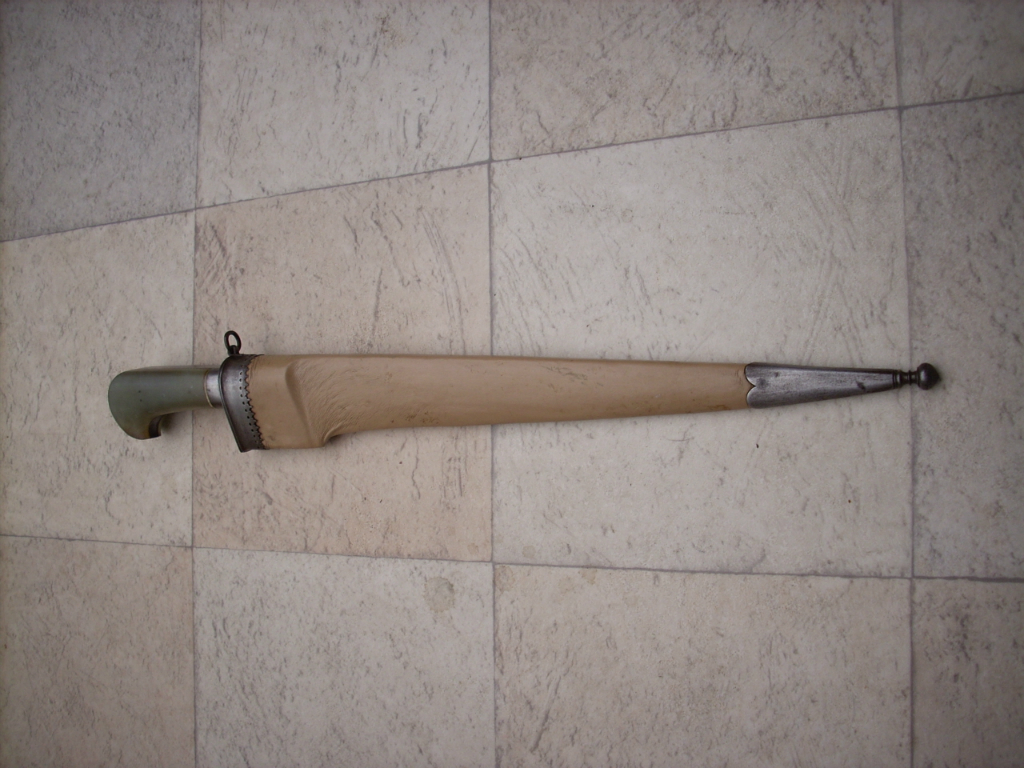

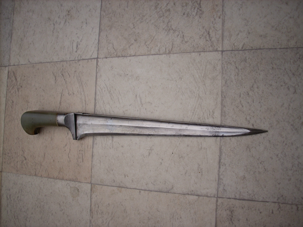

Hello everyone, I would be grateful to receive your comments on these two daggers.
The first one I believe to be a Karud. It is very well made having a green stone and steel handle with a fullered blade. The scabbard is wood originally covered with leather but now covered in a plastic material by a previous owner, the fittings are steel. I am not sure whether it is Indian or Afghanistan.
O/l is 19 ins with a 14 ins blade x 2 ins wide at the hilt.

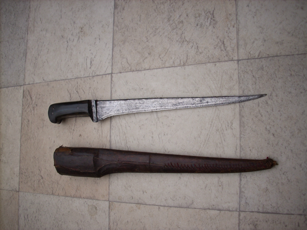

The second one I am not sure whether it is a Karud or a straight backed Pesh Kabz and whether it is indian or central Asian. The dagger has a horn hilt and the scabbard ie wood covered in leather.
O/L is17 ins with a 12.5 ins blade x 1.75 ins wide at the hilt.
Thank you
Miguel

Hello Miguel,
In my oppinion they are both North Indian. The first one second half of 20th century (meaning recent), the second one possibly a couple of decades older.

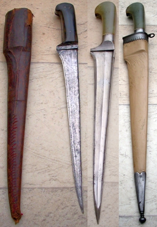

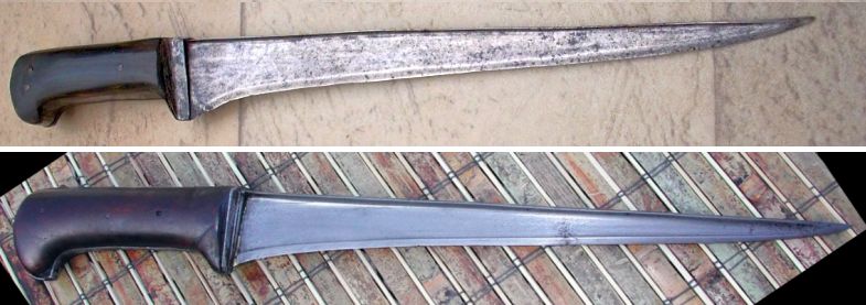

The one with the dark handle looks a bit like my Bukharan kard as shown in this thread
A karud
Steve

Ferguson. when you compare both of these karud daggers there is a distinct difference. I think the top one is Afghan while yours appears to be a Bukharan karud dagger.

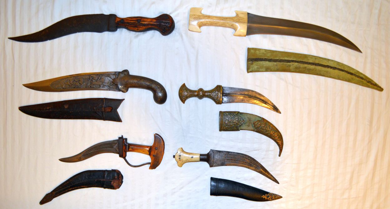

Posts: 1,492

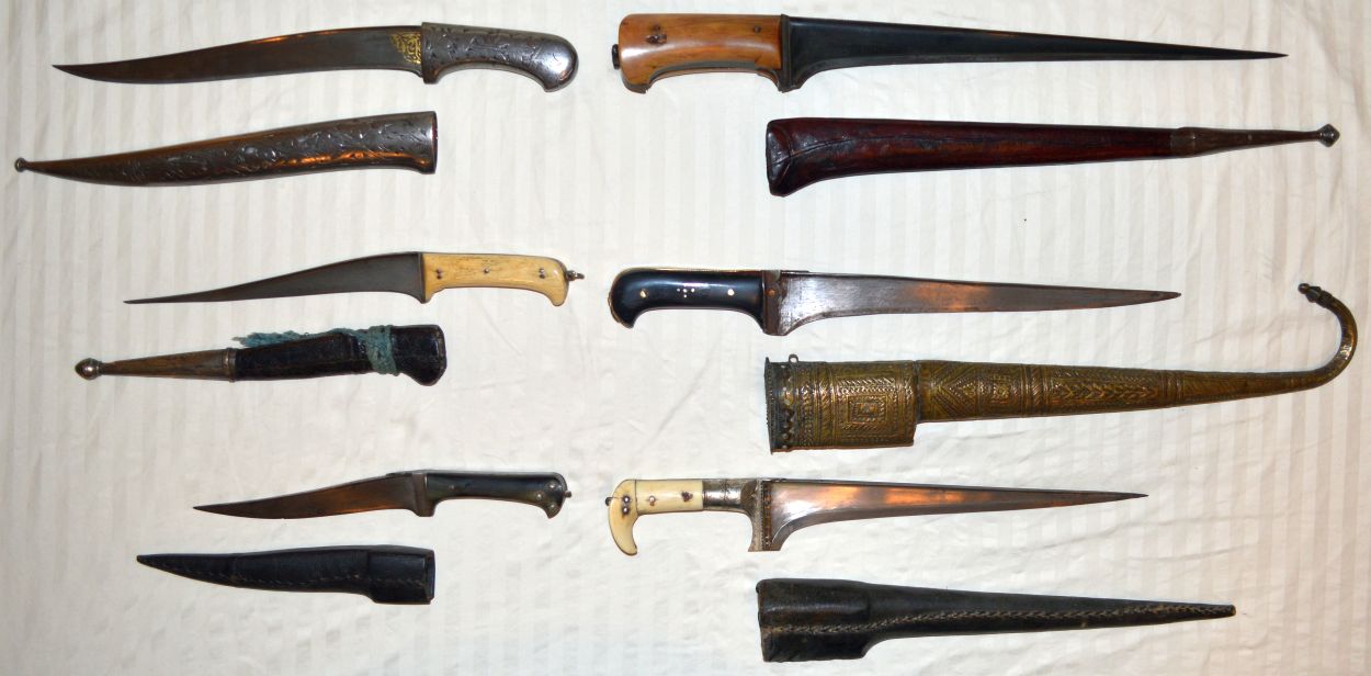

Pesh-kabz on the left, karud dagger on the right, does anyone really think these are all the same despite the total difference in blades?
Left from top down, Pesh-kabz: Persian, Afghan, Afghan. Right from top down, Karud: Afghan, Afghan, Afghan (choora type).

Posts: 1,492
While we are at it, does anyone really think that a kahnjar and a jambiya are the same despite the complete difference in blades?
Khanjar daggers (lt) compared to jambiya daggers (rt), there is a big difference. Top down, left side khanjar: Indian, Indian, Indian (khanjarli type). Top down right side jambiya: Ottoman (Albania), Indian, Indian (tiger tooth type).
