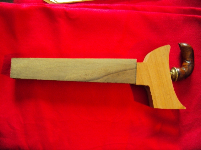

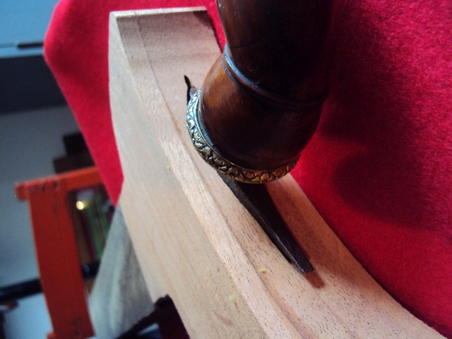

I am struggling with the first steps in making my Bugis Riau keris scabbard. I have had second thoughts about using the existing antique gandar. It will be easier to fit a new home-made gandar to the home-made wrongko. Perhaps you will agree that a totally home-made wrongko, gandar and buntut is better than to try to incorporate an antique gandar into a home-made scabbard?
At this stage the wrongko is roughly cut out to shape, and the opening has been sculpted to accept the blade as perfectly as I can make it.

In reply to David, let me see if I can post a pic or two of my incomplete project. Looks awful in this unkempt state! I promise it will look better after much elbow grease and TLC. Of course, as always, I welcome helpful hints and even flak. You will see I opted to go for the whole wrongko and not just the gambar and buntut.
In reply to Alan, I've always wondered: if I had the financial means to really treat myself when it comes to my edged weapons collection, would I have gone for specialisation or would I have stuck to my current mode of accumulating an interesting but varied assortment of historical weapons? I've never had enough funds to go to town as I would like, (who has??) what with kids at varsity and now grandchildren to help support. So, how such a collection, and my inclination towards it, would have ended up, I cannot tell. Your development as a young collector coincides in certain respects with mine, but the big difference is that in my locality I do not have access to keris items. The two I did fortunately get hold of, that I've reported on, came as a fluke not repeatable. Thinking back, I realise that I've owned, seen, handled, experienced such a wide variety of historical weapons of all kinds that I feel satisfied. I really believe the two extremes (going all-out in a specialised direction and accumulating a wide variety) both have their merits and appeal.
David, my files seem to be too big to attach. Let me see if I can adjust them.

I apologise if the images are poor!

The work you've done so far has got off to a good start.
Is the gandar made in two pieces and glued, or did you work out some way to inlet the blade in the absence of the specific tool used for this? If you did do it as one piece, I'd appreciate it if you let us know how.
The best glue to use for any scabbard is in my opinion Araldite, or some other two part epoxy glue. Normal woodworking glues can set up rust in a blade if they contact it, epoxy adhesives are like plastic and do not cause rust.

Thank you once again for your reply; I think we are and have been in agreement. Considering your questions, I am truly hesitant to reply. I am feeling like a Catholic parishioner having to appear before the priest and muttering: "Father, I have sinned!" Or like the time I had to do an oral in front of three Professors. The questions were all about this huge textbook on animal physiology, the contents of which I had virtually memorised. The first question took me by surprise: "Who wrote the book?"
I hereby shamefacedly admit (don't worry; I'm not too serious) that I took two pieces of teak-type wood for the gandar, marked out the outline of the blade on each of them and slowly and carefully made the required hollow with an angle grinder. Every now and then I took the blade and checked if the hollow was deep enough or had the required shape. I was quite surprised that the angle grinder idea worked so well; all it required was a firm, steady hand. I used this same technique with the gambar and it encouraged me that I could actually pull the job off satisfactorilly.
Yes, I did use wood glue; however, the Bugis keris is to be stored outside of its scabbard. (I've always had this thing about storing edged weapons outside of their scabbards.) I once made a storage case for a pristine Luger pistol, using wood glue, and found to my dismay that a light sheen of fine rust had developed within a week. Happily there was no lasting damage and after I aired the box for a few weeks, the problem never came back.
My biggest challenge lies ahead: bringing about the proper dimensions to the gambar. I'm still poring over your description: "a very gentle concave surface from the vertical groove towards the back, the surface of the wrongko in front of the groove is curved to blend into the rounded front". As David put it: "...to make the proportions and nuances as close to acceptable as possible". I must search images taken at an angle, so I can view these necessary nuances. I thank you all once again for your comments.

Johan, there is nothing at all wrong with a gandar made in two pieces and glued down the sides. It is a quite legitimate way to make a gandar. Yes, one piece , no glue is better, but then again, a complete scabbard, gandar + gambar from a single piece of wood with the wood grain optimised is better again. I doubt that there is anybody working in Jawa now who can do this satisfactorily.

I have thankfully made progress with the new gandar and part of the buntut. Please see the pic. The measurements at the point of the white Parker pen are: width: 47 mm (1,85 inch); thickness: 25 mm (1,0 inch). Measurements at the point of the blue Parker: width 42 mm (1,65 inch); thickness 20 mm (0,79 inch). I give these measurements because I am requesting your kind comments, as I do not have a complete Bugis scabbard to copy from. If you think I must take off some more wood to make this gandar typical, please offer advice. The buntut will lose a few millimetres in length when I prepare it for the little flange thingy, which will stick out a bit like a rim.
When I attached the buntut to the gandar, I used a two part epoxy glue. After that hardened, I carefully drilled four holes into the buntut from the end and glued four slender wooden dowels into place. This is to hold the job as securely as I know how. Incidentaly, the original antique piece of gandar has four little pinholes too.
Now the bad news: Having come far with the gambar (you saw the previous pic), I found myself coming up against a brick wall. I knew I could not carry on with the gambar in laminated form! I should have known the four-piece lamination was a lamentably bad idea! Why it sucked so abyssmally is that when I started carving what David called the "nuances", the outer laminations caused haphazard patterns to emerge - too awful for words. So, in disgust I scrapped the gambar. Now I am searching for a nice piece of dark wood to start the gambar afresh.
I will once again make the gambar by lamination, but ONLY in two pieces glued in the centre. I'll have to find wood thick enough for this purpose. Following Alan's advice, I'll use epoxy glue for this.
Johan van Zyl is offline   Reply With Quote

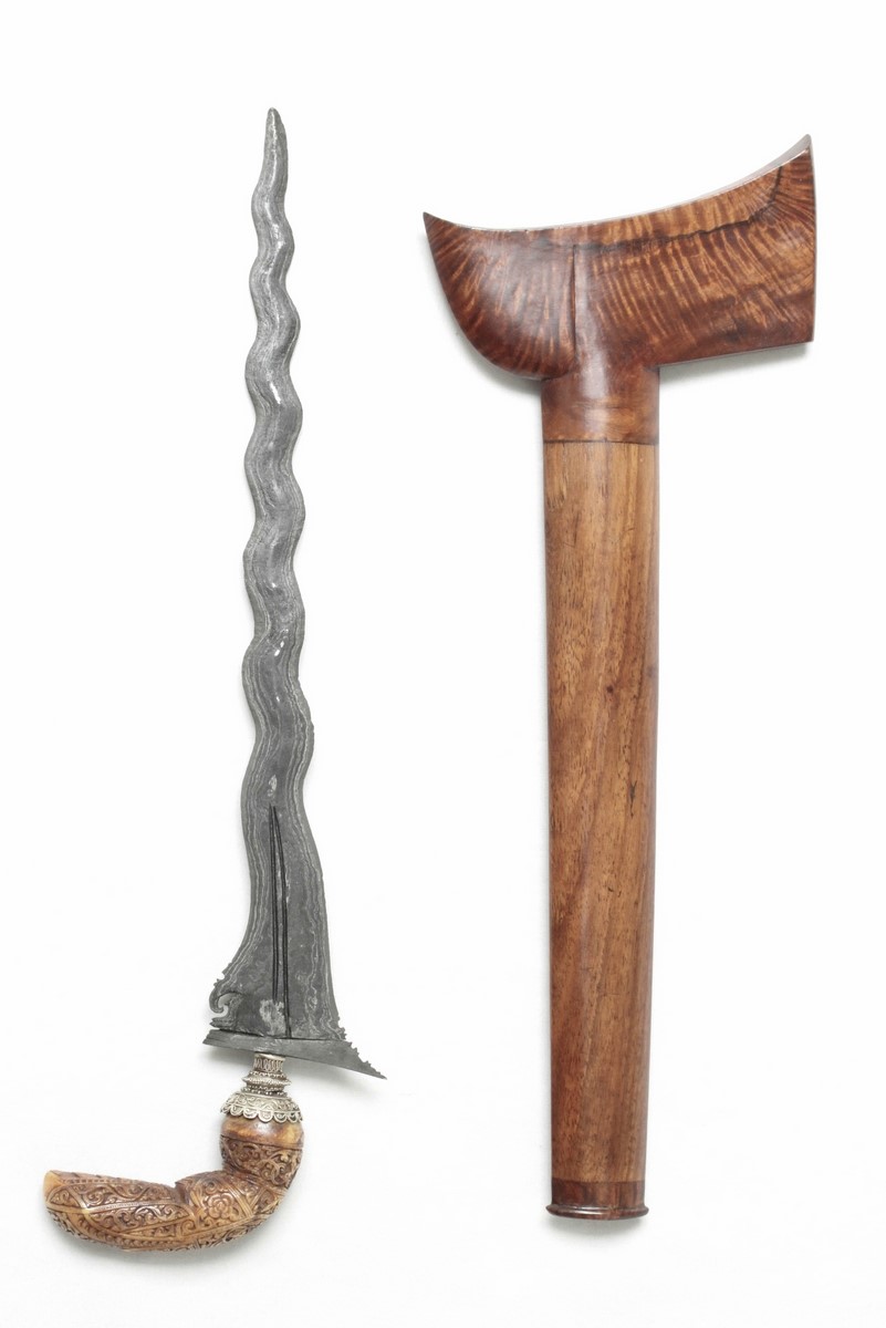

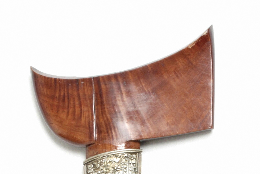

Thanks, but could I ask that someone who has a Bugis scabbard kindly provide a pic or two showing the gambar edge-on? That's so I can see how to shape the "ship's" "prow" and "stern". I think the prow is rounded, while the stern seems to be rather flat. (Jean posted a nice pic, and thanks, but that was in conventional view and does not show what I need to see.)
Hello Johan,
Can this pic of an old and traditional sampir from Sulawesi help you?

This is excellent! Thank you, Rick & Jean! What I'm seeing is a gambar that is not so exquisitely shaped than what I had imagined. The single engraved groove (both sides) running up to the top is no more than a straight line: easy to carve. I note the sides running up to the "prow" are quite flat, as are the sides running to the "stern". If this is a acceptable example of a Bugis gambar, I see no reason for me to try and sculpt something more elaborate. Actually, I'm feeling relieved to see these pics - I can go ahead with my tools and limited expertise and expect my gambar to look at least as good.
One more request, if you please: What is the maximum width of the gambar? If I may use ship terms: How wide is the boat in the centre from gunwale to gunwale? This is important for me to know.

the width at that point is just shy of 1 inch, Johan. If you need any other pictures let me know.
Glad to be of assistance with your project.

Guys, it's of course nothing of great importance, yet Johan's Keris quite clearly is a Riau or Straits piece (its Gandar/Batang included) and has nothing to with Sulawesi. The sheaths shown in this thread are Sulawesi Bugis.
The Straits Sampir are boxier (wider) and could actually be easier to carve - they don't have the bulge.
